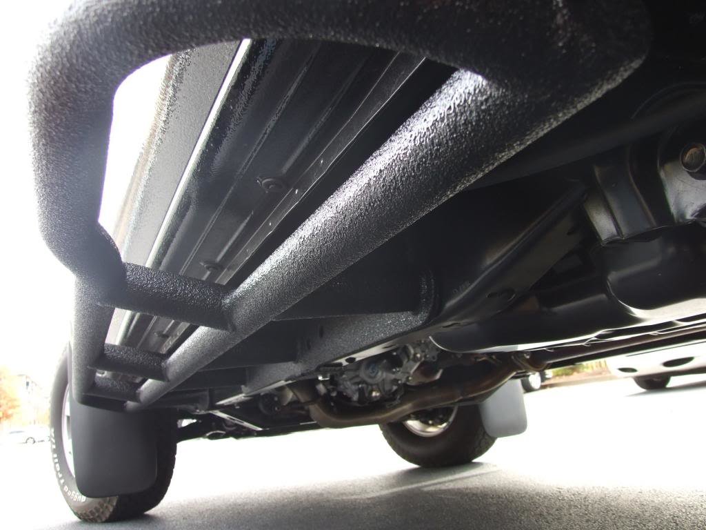

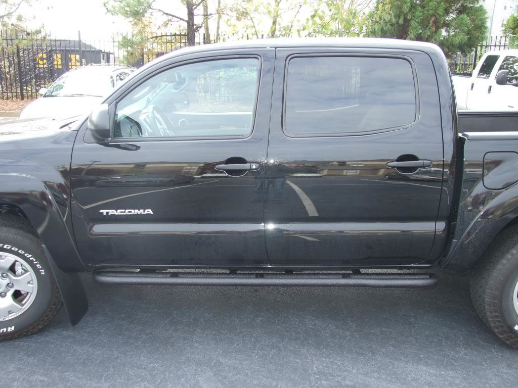

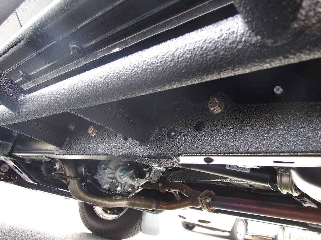

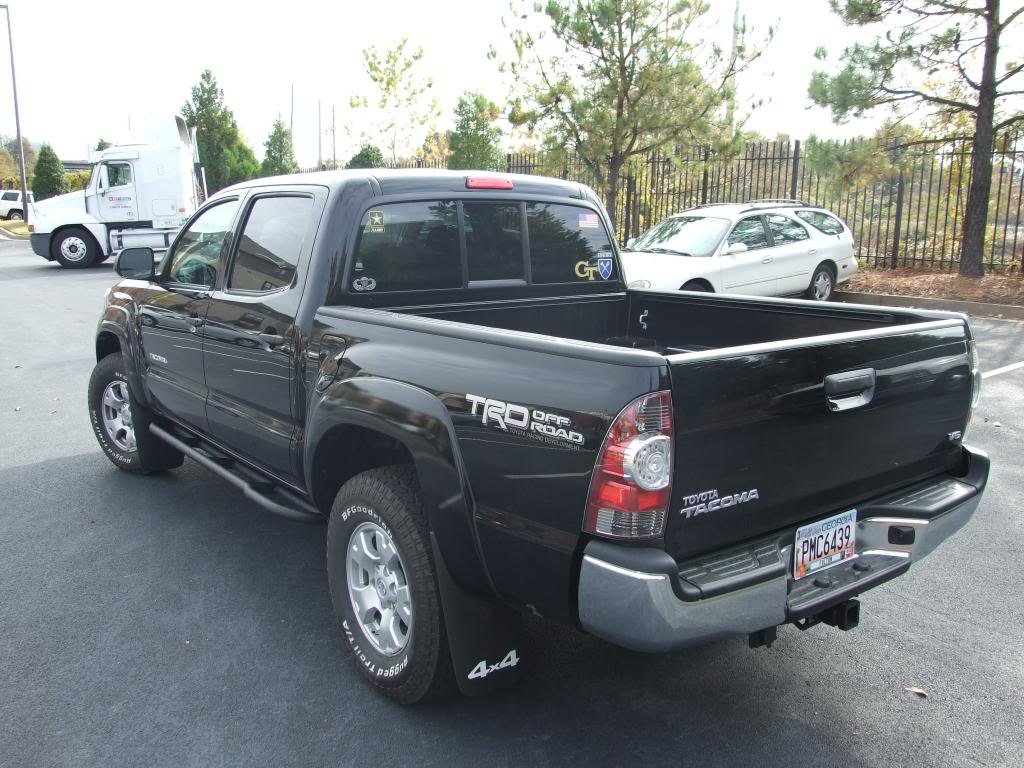

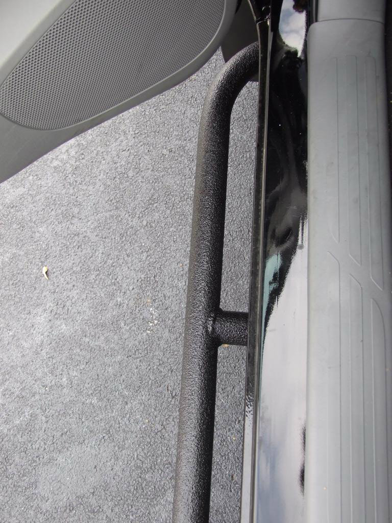

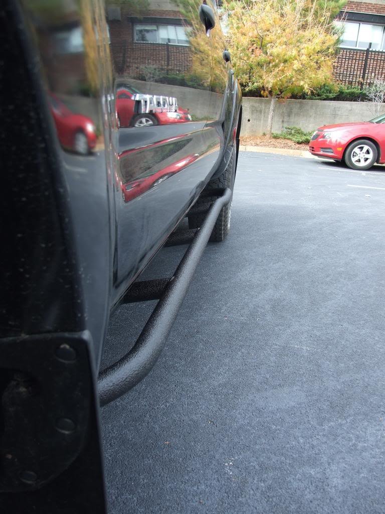

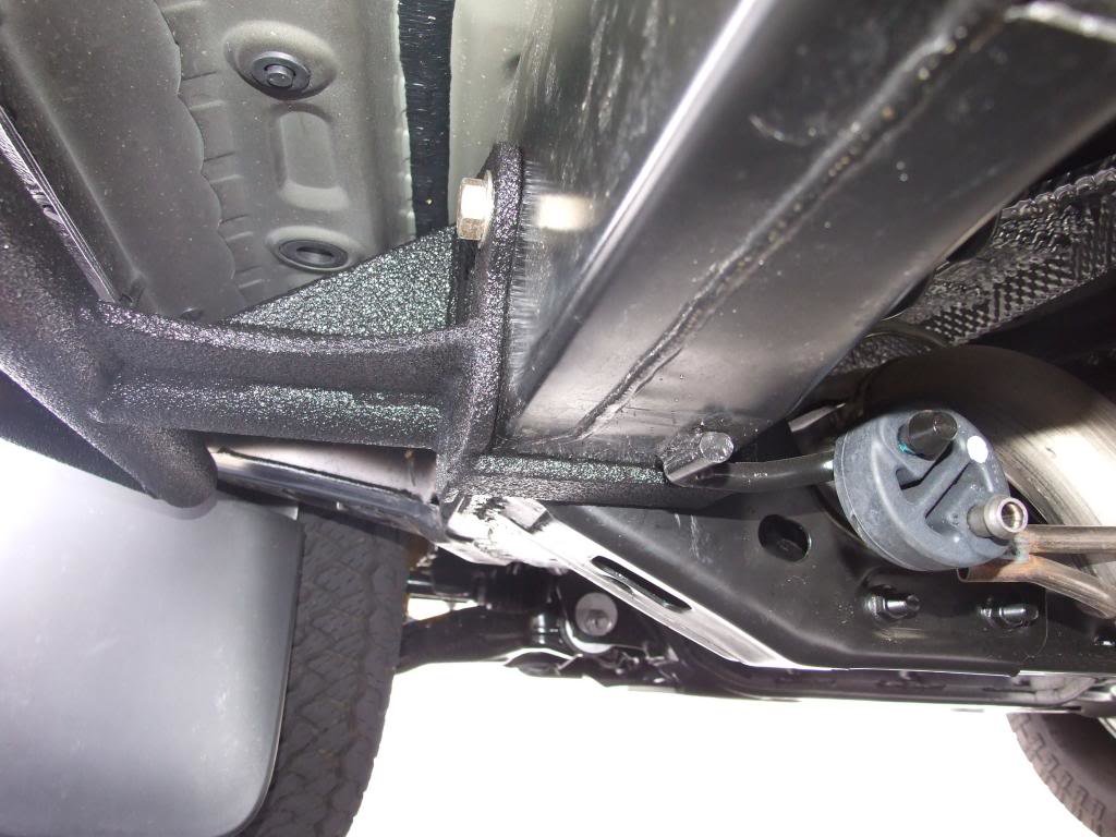

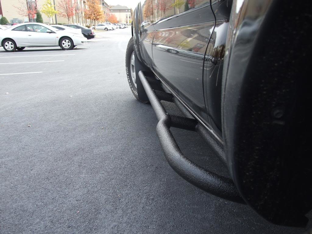

    I just got my Famous Fabrication sliders on my truck and I thought I would weight in on this topic for those still deciding on what they want to coat their sliders with (this thread was a big help while I was deciding).
    I decided to get mine Line-X'd. I went back and forth on what I was going to coat them with. I first bought Rustoleum black spray paint, because it would be the easiest to touch up, but then realized that I wouldn't really get the chance to beat them up against rocks for a number of years. I will be in training for the next 6-8 months, and then I PCS to Ft. Hood, TX - probably won't run into a lot of rocks there. I didn't want to have to touch them up because of gravel roads or the weather. I then bought some Herculiner on a whim, but before I applied it, I looked it up on here and other sites. I read that it would hold up against rock chips (gravel roads) and weather, but would eventually fade and flake/chip off after 3-5 years. This would be right around the time I hopefully PCS from Ft. Hood, but I wanted the coating to last a bit longer than that. Finally I pulled the trigger on having them Line-X'd. It was $125 for both of them, and it comes with a lifetime warranty. I figure if they get banged up in a few years, I can have them touched up / recoated. Until then, they should continue to look great.
    During the install, I got really familiar with how tough the Line-X is. I had to use a 3.5 ton hydraulic jack to press my sliders into place (tolerance issues due to thickness of Line-X; see below). I was worried at first that the steel cup on the jack would mar the Line-X with all that pressure, but it held up. I could see where it "dented" a little bit, but eventually it faded away (regained original thickness) and can no longer be seen. We also dropped them several times, dragged them across the asphalt, etc., all with no damage to the coating. I am pretty impressed with it so far.
    Here is a few more pictures of them:
    I also wanted to point out to anyone that is considering having their Famous Fabrication sliders Line-X'd, that there will be fitment issues due to the tight tolerances and the thickness of the Line-X coating. I had issues pressing the "U-hook" (see photo below) at the front of the sliders up into place. The combination of the thick Line-X coating and the fact that there is a weld in the corner of the two frame members required a hydraulic jack (lifting the truck up off the ground) to bend the "hook" around the frame and into place. If one is careful, this can be done without damaging anything, but I was expecting to be able to hold them in place with our hands and bolt them up - this was not the case. The jack make it nice though because it held them up for us, limiting muscular fatigue.
    Also, the only factory bolt that we were required to reuse was rendered useless by the thick Line-X coating. It was just too short to thread back into the fixed nut in the frame member. I picked up a new M10 x 1.25 grade 8 bolt at an Ace Hardware that was 0.5" longer to replace it. The factory bolt is a grade 10 bolt (I believe), and I may end up replacing the one I have in now with a longer grade 10, but I needed something to help with alignment during the install. The new bolt can be seen in the picture below (the only silver bolt, bolting into the bottom of the frame rail).
    If anyone has any other questions, I'd be happy to answer them. I will keep up with this thread to track how the Line-X holds over time and use. I hope this was helpful!
