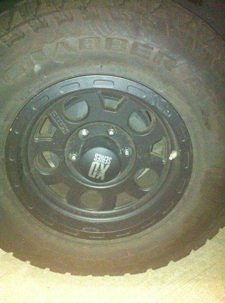

    I had a slight annoying vibration that I could not diagnose as a driveline or tire balance in the seat of the pants. It caused the passenger seat to shake at speeds greater than 70 mph and was most pronounced on really smooth surfaces. It was perplexing because it seemed to show up immediately following a tire rotation after my lift, wheels, and tires were installed and road force balance. Everything was smooth as silk until I got my truck back from a routine service and tire rotation.
    Today I installed two two parts and the vibration is completely gone.

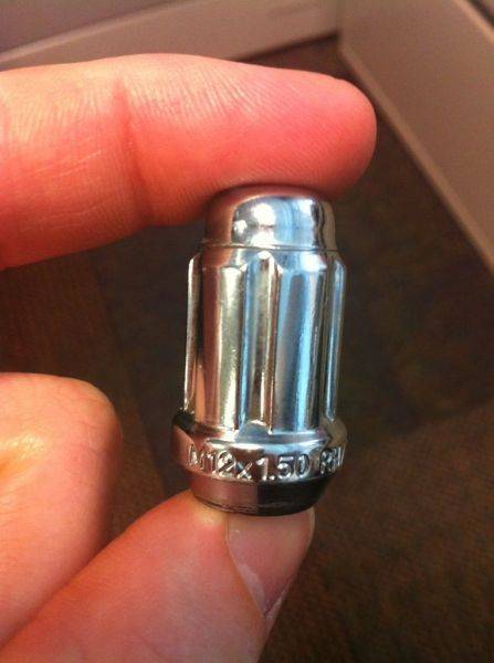

    The first one is the correct lug nuts from wheelers offroad with the shank to center the wheels on the hub. They are the gorilla splined ones for $1.99 each on this site. The second was these rings to center the wheel on the hub and take up the slack between the wheels and the hub. http://www.amazon.com/gp/product/B0032HQJ7G/ref=oh_details_o02_s00_i00
    So for $50, it's finally glass smooth. Hopefully this will help someone else struggling after new rims. It basically comes down to hub centric vs lug centric and the right parts to make sure a well balanced wheel and tire drive like one.

    Nope. Those are the acorn style for hub centric wheels. The ones I am talking about are these. They look similar but have a shank underneath the acorn for centering of the wheel on the lug holes.

    The spline part is not going to make the difference in this situation. It's the ET (extended thread) shank that will hold the wheel steady. If you don't want to run a spline lug, gorilla also has the extended thread in a stardard hex lug.

    Yep, no problem with the center caps. I would suggest getting the right lug nuts as well. I think these did more to center the wheel than the hub rings.

    I was not talking about the spline part. I was talking about the same shank that you are mentioning. :rolleyes:

    Yeah, I know. Was clarifying for others that you don't necessarily need spline lugs. As long as they are ET, you're good to go. :facepalm:
