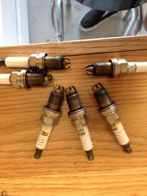

    I changed my spark plugs, ones I pulled were pretty bad....
    Got new densos, new plug wires from Toyota, new fuel filter, cleaned mass airflow sensor and she ran like a champ!!! All basic and easy to do, took very little time.
    Good luck, let us know the out come.
