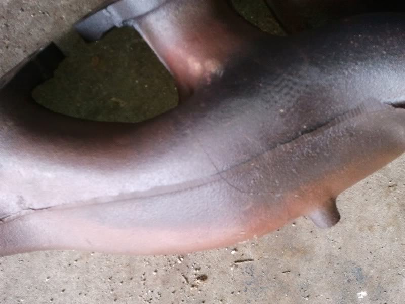

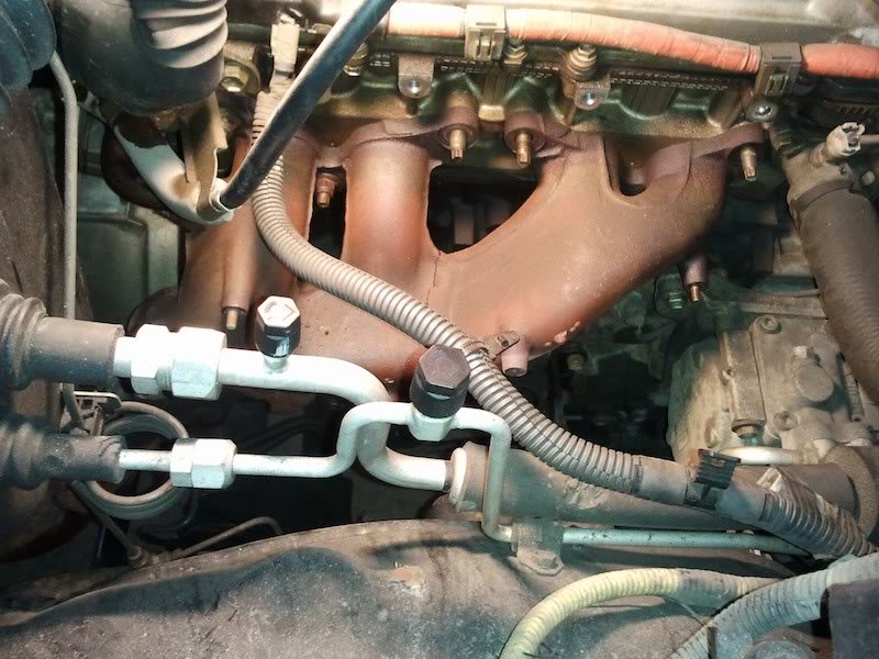

    I knew that there was a crack in my exhaust manifold on my '99 3ZR; actually I knew to look for it thanks to all the posts I read on TW. There has been a noticeable: loss of power, drop in MPG, increase in noise - and I don't mean a good sound either. I haven't smelled any exhaust leaks in the cab or gotten any CELs, but it seemed that the crack has steadily been getting worse. Or as ******* Toyota diagnosed it, "a leaky exhaust gasket." :rolleyes:
    My suspicions were confirmed when I took this picture (finally removed that oddly complicated air intake system):

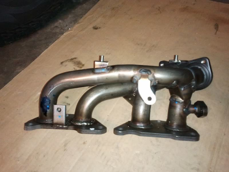

    I had been waiting for the group buy on the Doug Thorleys, but I didn't know when that was going to come together, so I went ahead and got the factory kit from Nix 99 in WA. FYI, it took 4 days to Chicago. Obviously not quite as nice as a set of SS long tubes, but looks better than the stock cast piece:

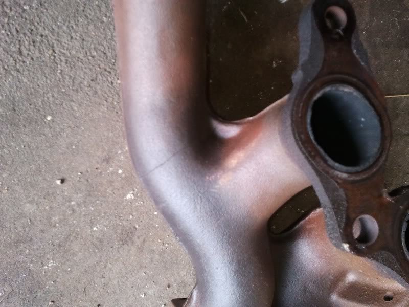

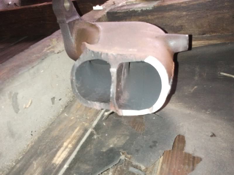

    So I pulled the stock part off yesterday, which ended up being a little more of a pain than I figured. Of course, if I had to do it again, I could definitely knock it out in an hour or so. Anyway, I pulled the stock piece off and noticed that the cracks (plural!) were more serious than I thought, and went around the entire manifold. It was only a matter of time before the whole thing cracked completely.
    A little deconstruction video here, demonstrating exactly how cracked the manifold was.
    http://www.youtube.com/watch?v=SDxx2vC5Uq8
    You can see by the profile shot just how bad the exhaust was leaking. Note the color of the metal; the dark areas obviously have been leaking exhaust.
    So I installed the new part and hooked everything up. Before I reconnected the airbox though, I ran some TB cleaner through the air tube to clean out the TB. Apparently it hasn't been cleaned in quite a while. I backed the truck out of the garage a little bit and blew out quite a bit of white smoke. The alley looked like it was being fogged for mosquitoes. :D
    I'm looking forward to checking the mpg over the next few fillups to see if the new manifold helps. I took the truck for a short spin, and the sound is much better. No more of that "leaky air compressor" sound. There seems to be a bit more of a low rumble, or maybe that's just how it should sound. The manifold has likely been cracked since I bought the truck last October, so I've never really heard a "good" exhaust sound from this truck anyway. At least the sound no longer detracts from the otherwise tough look of the stock truck.
    I'm sure the header would sound better, but I didn't want to wait any more. And I doubt the extra couple hp I might get would make much of a difference in my life. The tach almost never sees over 2k anyway.

    Is it possible the stock manifold got over heated? It looks burnt.

    I have only just filled up a tank of gas so I don't know if there will be any difference in mpg. I sure hope so, since I drive about 45 miles per day and gas is pushing $5/gal here in Chicago. Every mpg helps! However, I have noticed: the truck is now a lot quieter (duh), it accelerates much better off the line, and it idles a lot lower too - almost too low, like it is close to stalling. Ok, not quite that bad, but I occasionally pop the trans into neutral at stop lights to eliminate the low RPM rattles. I'm not complaining though. It is running a lot smoother since the new manifold install / TB cleaning. I can't say if it's better than the stock *uncracked* manifold though, as I think mine has been cracked since I bought it.
