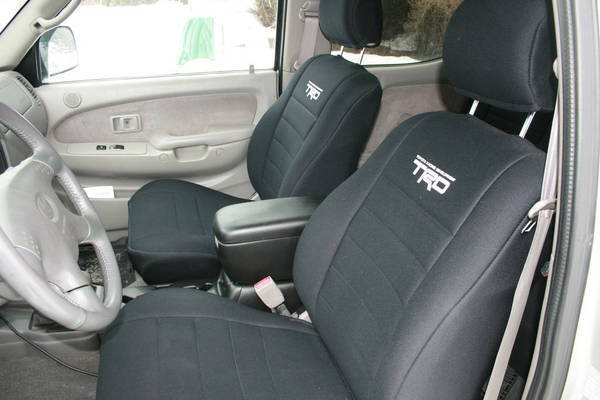

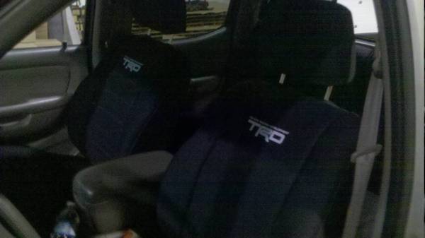

    Frame swap, suspension, seat covers installed.

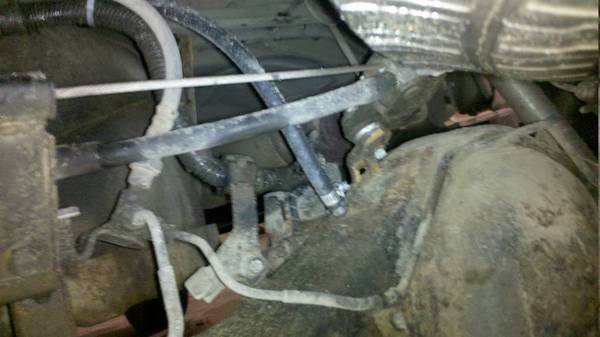

    When I took my truck in for provincial inspection it failed the first time -
    Leaking rear axle seals (quoted $1300! got my uncles mechanics to do it for cost of parts - $900)
    and no DRL (there was a module hanging in the engine bay!)
    So I took it back for reinspection and I got them to install the rear diff breather mod for the whopping cost of the union! ($10)
    Gave them this guide:
    http://www.tacomaworld.com/forum/1st-gen-tacomas/15223-diy-differential-breather-extension.html

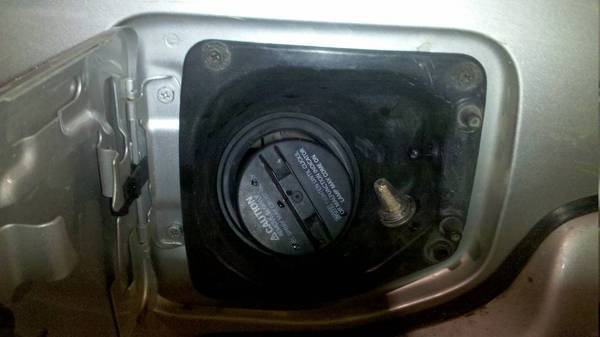

    A few random photos:
    Dump run, no problemo

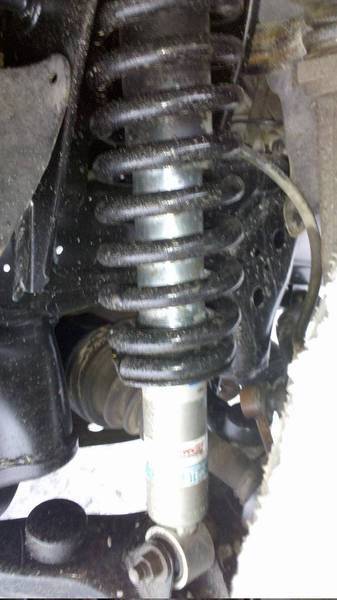

    crappy pic of front suspension

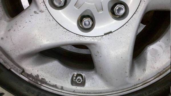

    Valve cap

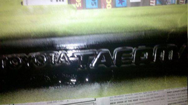

    Plasti dipped my emblems. some success, some fail
    This one turned out perfect:

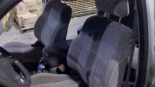

    those look like wet okole seat covers. wetokole.com
    when you plasti-dipped what did you do differently when you had success vs when you failed?

    nice seat covers bro

    There are 2 types of emblems on my truck. The front door "Toyota Tacoma" had a nicer, newer finish. When I first started with peeling the excess, i was kind of tracing around the letters, and sort of cutting away as I peeled because I was fearing pulling would tear it off the emblem as well.
    I sprayed too heavy on the first emblem, and it kind of pooled at the bottom of the letters. So I eased up on the thick coats on the rest.
    I put too little on the tailgate emblems. They are also made of something different than the door ones, and I was still using the trace of tactic, left the result sloppy.
    On the door "limited" small lettering, They were deteriorated before I sprayed them, so the rubber stuck of little more to the letters. I also lifted the "L" off when peeling, so I'm gonna debadge the "Limited" on the rear door.
    The badge that went perfect was the passenger "Toyota Tacoma". Perfect amount of spray, plus I just peeled it off, no toothpick, it came off very clean.
    I cleaned the badges with isopropyl and did 4 coats, 30 minutes between and a very light heat gun from 2.5 or feet away for 15-20 seconds, just enough to get some wind on em right after I did a coat.
    Hope that helps!

    I got them in the Wet Okole group buy. http://www.wetokole.com

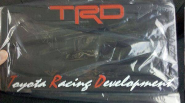

    Front License plate. looked cheap out there all alone
    Purchase frame from ebay.
    I think i'm gonna spray it all black.

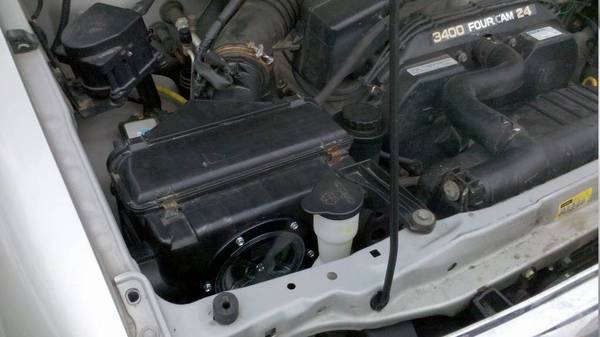

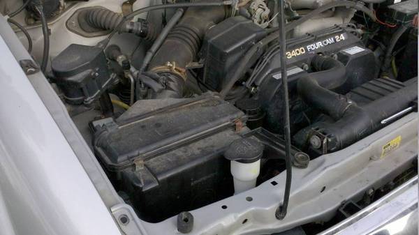

    Deckplate Mod complete!
    Before

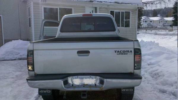

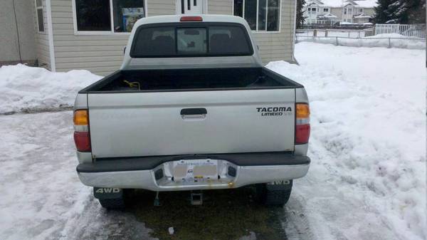

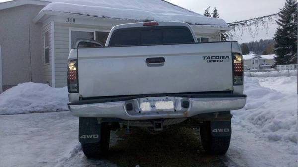

    LED Tails came today:
    Normal lights on:
    Turn signals were white:
    One reverse light had the wrong bulb in it:
    Went and bought amber bulbs for turn signals, and used a white bulb to fix my reverse:

    Did the deckplate mod help you out any performance wise? Did it produce a cool sounding sound after installing?
  16. Feb 2, 2011 at 6:35 PM
    #36
    SlimDigg
    SlimDigg [OP] We Back!!
    Sep 1, 2010
    #42613
    1,428
    Calgary, AB
    Coming Soon....
    It has been dyno'd and you get 8hp.
    I think the acceleration is a bit peppier.
    I never really get my truck over 2500rpm, but when you hammer it it sounds more like a truck. Not super significant but it's there.
    For a total of less than $20 you cannot pass up this mod. Get a hole saw, it made it very simple for me.

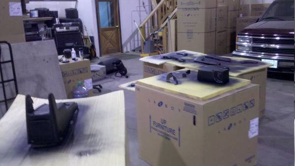

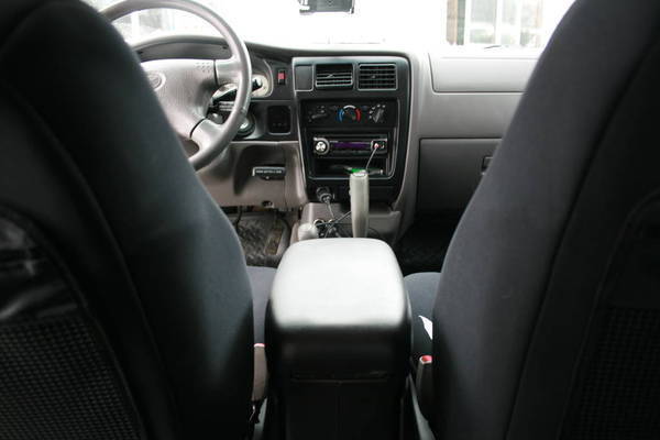

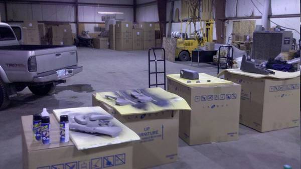

    Plasti dipped the floor trim today:
    I'm going to do the seat pieces tomorrow

    Calgary, AB
    Coming Soon....
    After doing the floor pieces and liking that so much, I thought i'd do the console and seat pieces. I thought the inside plastic piece on each seat would come right off as well, but as far as I can tell you have to remove the whole top half of the seat. So they stay grey :(
    :D :thumbsup:
