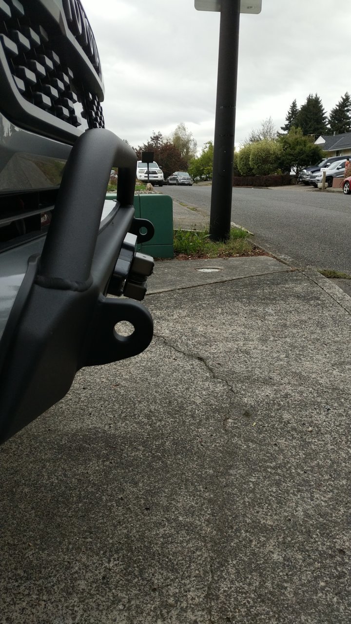

    One thing which matters a lot to me is the shape and location of recovery points and radiator hoop. I have such a tight parking situation and I want to get strollers and bikes in/out of the garage as smoothly as possible and I really don’t want to ding my shin walking around the front of the trick to get to the garbage cans. So I’m an oddball buyer looking for as smooth and flush as possible and I would really prefer no hoop and no recovery points (or recessed recovery points). Rather than ease of functional use which I suspect is what most of these bumpers are designed for?

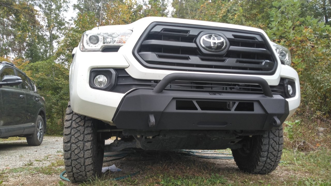

    Just installed the Body Armor today. Massively strong, straight forward installation. Good price. Highly recommended. KIMG0074.jpg

    Any lower shots? Looks great.

    Meaning lower angle? I'll take some. The phone camera distorts things so much - it's hard to get a photo that looks like real life.

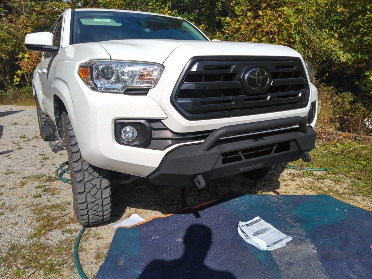

    More photos.

    Very clean.

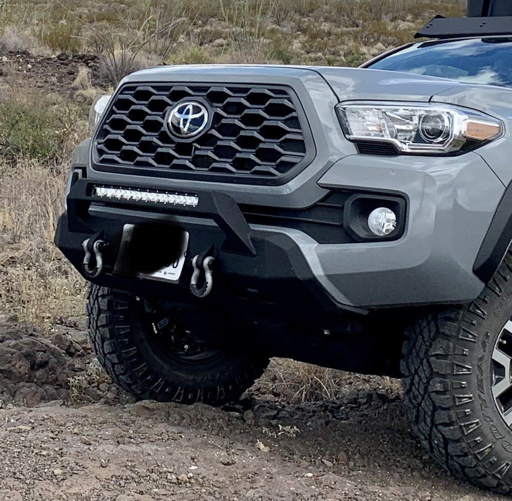

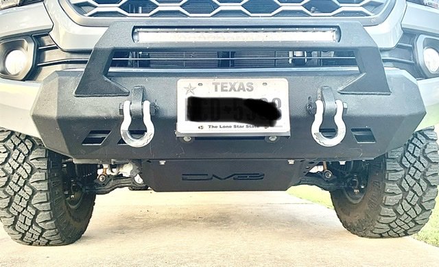

    I have a DV8 Off Road Low Profile, no cutting required, not my first choice, but got it for $338. Had to make a few mods to the L brackets to give it more strength, But it is serviceable. 74DD4FFF-9565-4157-B7C1-F92CB5927930.jpg

    Can you post a few more pics. Maybe a side view?

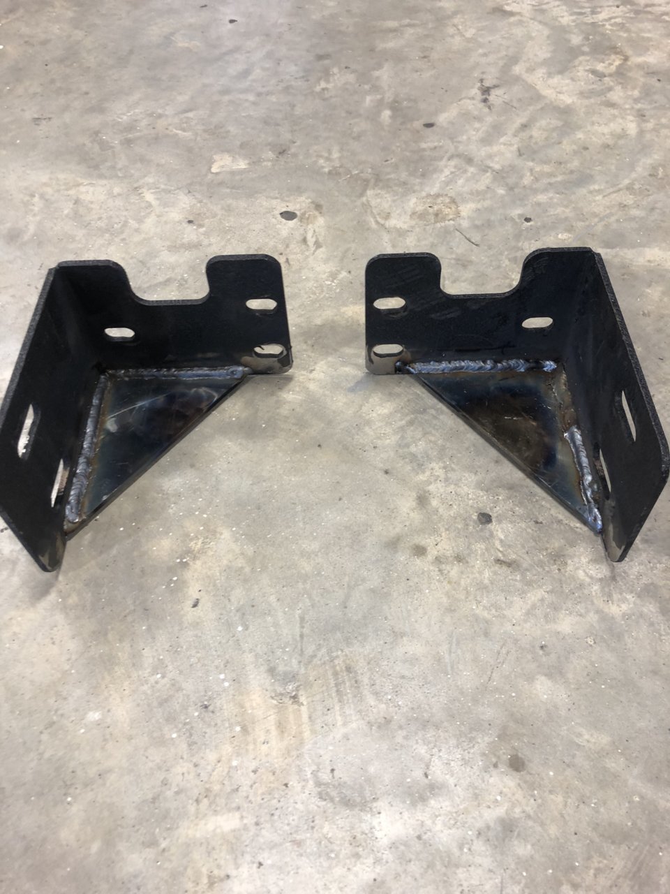

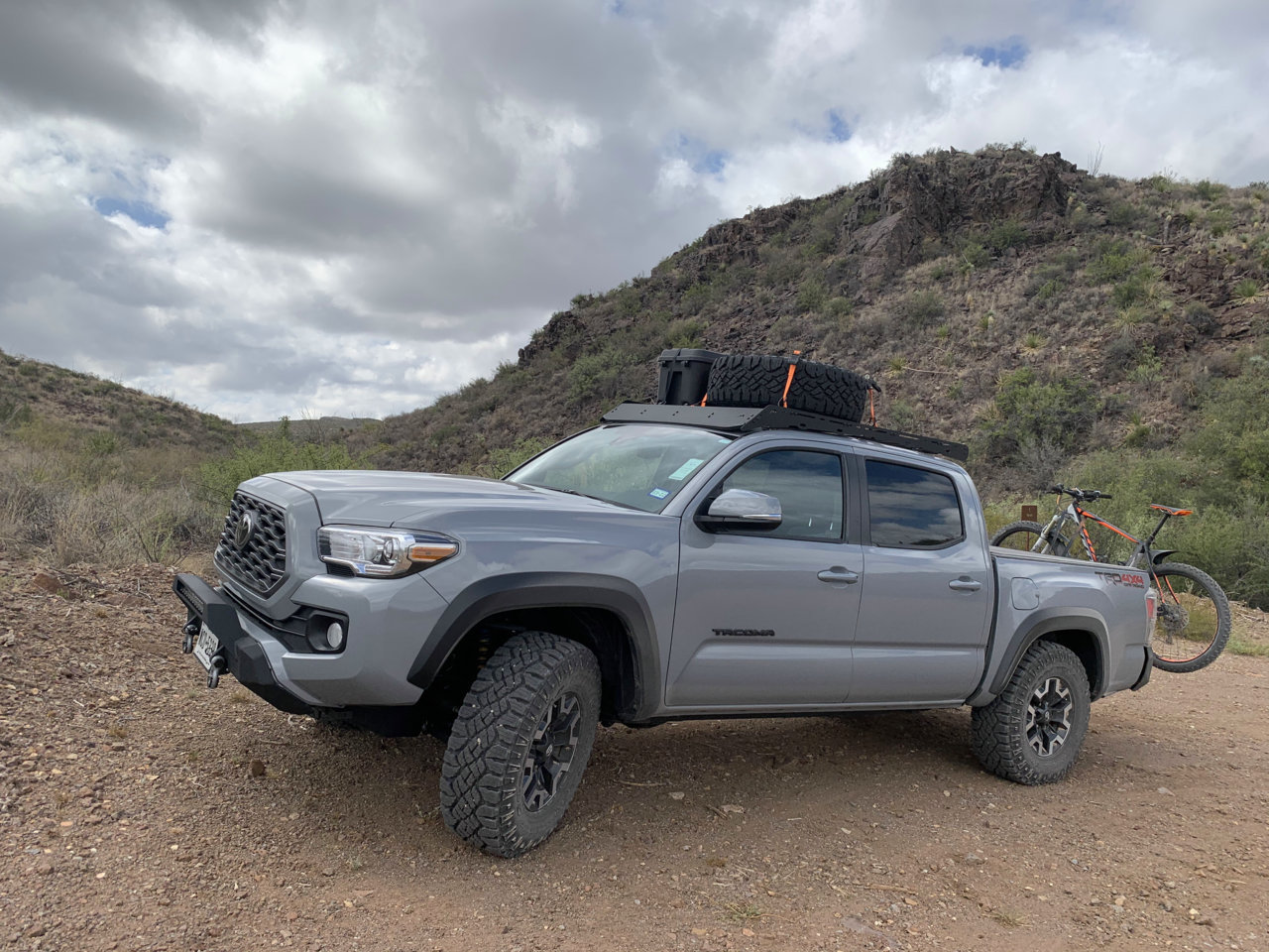

    Here's a couple, The light bar does stick out farther than I would like, but again, I was somewhat price driven. I also include a photo of the gussets I welded to the L brackets to strengthen for a lateral pull. The mounting brackets share the same mount point for the winch tray. If I was to place a winch I would probably weld the L brackets directly to the winch tray to provide even more additional strength. If you are considering installing a winch I would discourage you from purchasing this type of bumper. While compact, and tidy looking, a full bumper with additional mounting points on the lower frame to disperse the pressure points would be a better bet.

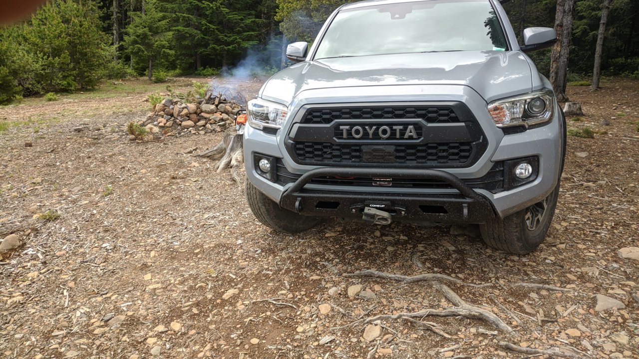

    I really like mine. The hoop is low enough it doesn't interfere with the sensor. It is tucked in nice and close to the truck, so close you need to cut curves for where the hoop attaches. Bumper weighed 37 lbs and the winch 89. I believe on the stock suspension it brought me about 1/4 inch lower (I had sliders on before measurements so ymmv)
