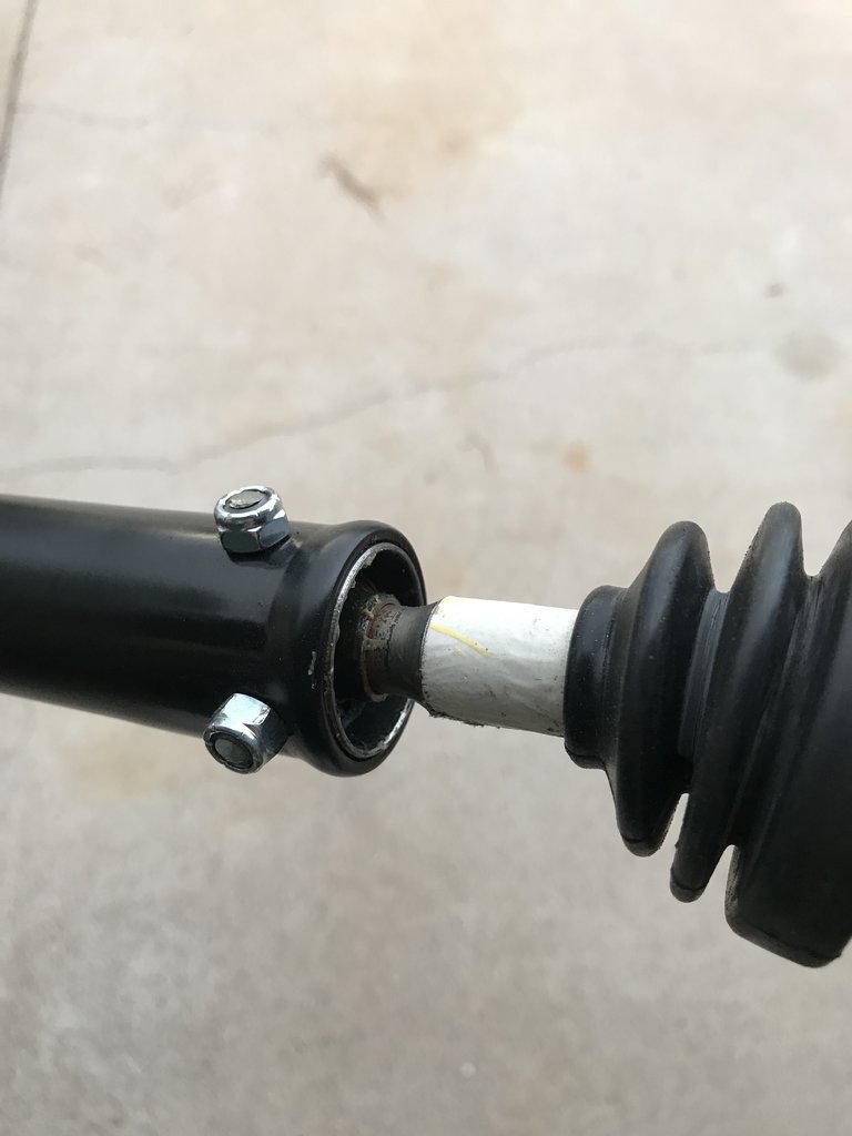

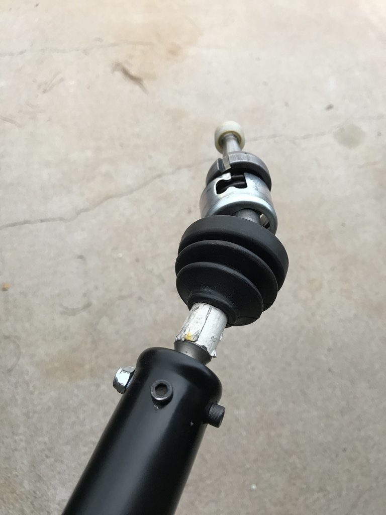

  17. Jul 31, 2017 at 7:44 AM
    #57
    turbodudey
    turbodudey New Member
    Jul 31, 2017
    #225486
    Another way to tighten up a sloppy shifter. The rubber isolator bushing was complete mush, leaving about 5" of slop with in gear. (Could hardly tell the difference between neutral and in gear)
    I used two #10-32 machine screws (3/16") and nyloc nuts. I drilled it out by hand, and it wasn't very difficult. It's not a hardened steel shaft.
    kozy, prowler, Baloobies and 4 others like this.

    YASS! Finally someone with an answer to my very same problem. I will definitely do this to mine before dishing out $300 for a new shifter assy. THANKS TACO BROTHER!
    prowler likes this.
