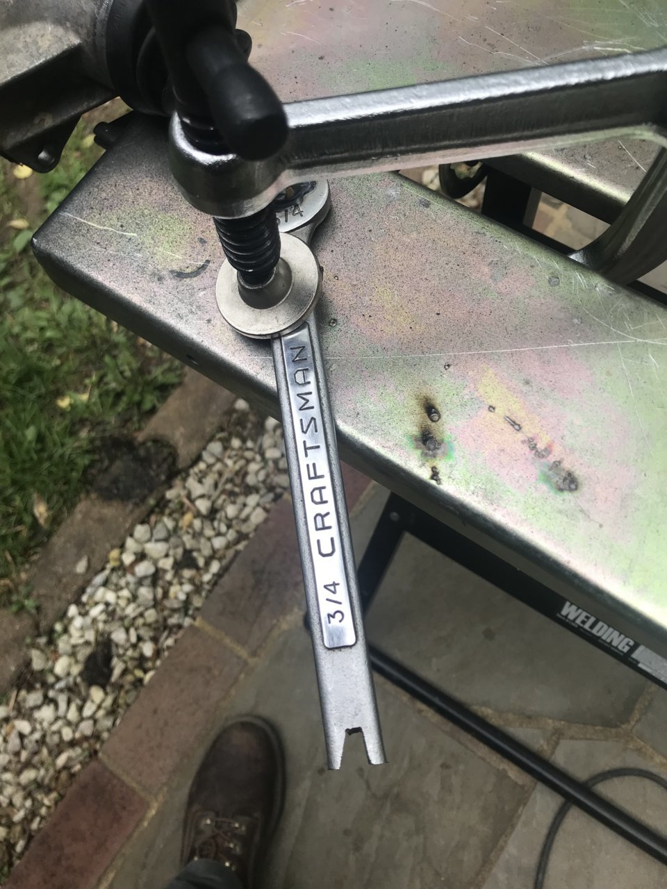

    Haha, Love it !! This fix has me written all over it. Off to warm up my crappy drill and dull bits and do this!! Thank you sir!!!
    edited. No luck, my bits wouldn't even dent this steel...

    I may attempt something similar. Would be a fun project and make the truck unique. I kinda wanna use something a bit different, because really, sky's the limit. Maybe a wrench in there?

    Well, I did it haha came out awesome.

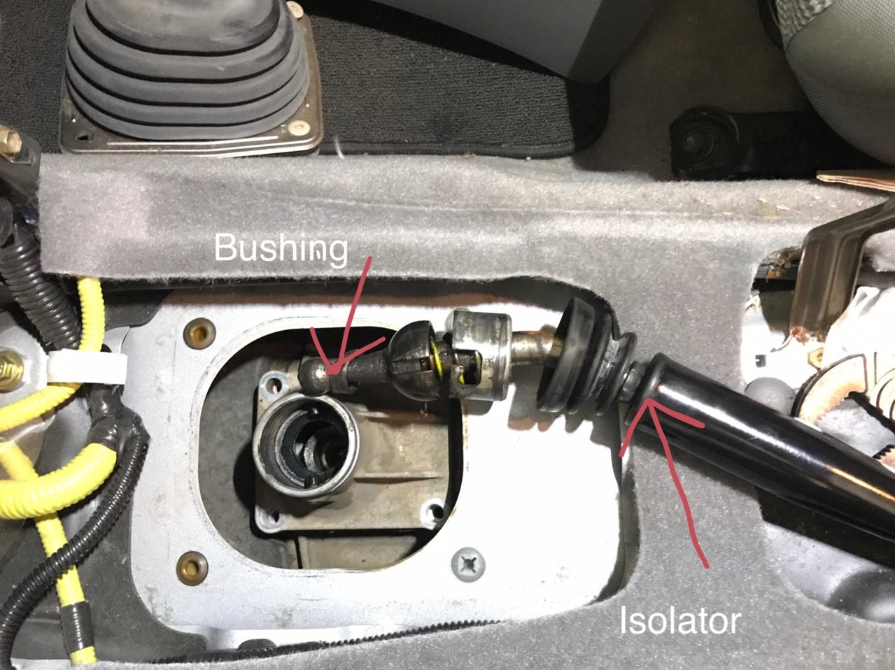

    Anybody find a solution for isolator slop? I took my shifter apart and see that the bushing is bad, the seat is good (surprisingly), and a lot of the slop is from the isolator. Once the bushing is replaced I figure I'll still have slop from the isolator but I don't want to eliminate the isolator completely.

    Just a few posts up, someone put a few machine screws through the shifter to stop the slop. Might be worth trying.
