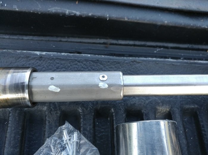

    Just did this to my wifes taco today which has worse play than my taco.
    I drilled the holes with a 9/64 bit , 3/8 depth and instead of a roll pin i used two 1/8" dia x 1/4"L aluminum pop rivets opposingly placed.
    Reasoning is the shear strength (i hope, from my research) of the pop rivet is 120# (x2) which is much lower than a roll pin's 1875#-1900# (x2?).
    Wife loves the firmness (theres a joke there somewhere) of the steering now.
    Tomorrow i'll do it on my taco.
    I'll report back if the rivets fail in the future.

    did this today to my taco. this time with just one pop rivet. so far its working also.
    You can tell the difference when you go thru potholes and other road imperfections, no more jiggly noise and motions.
    lovin it! will report back if it changes.
    CK

    Wondering if one rivet will eventually wear down and allow a little bit of play. Although I bet it will never wear back down to where it was before.

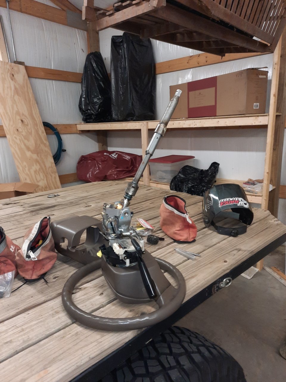

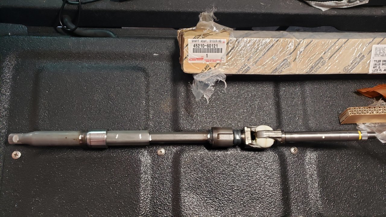

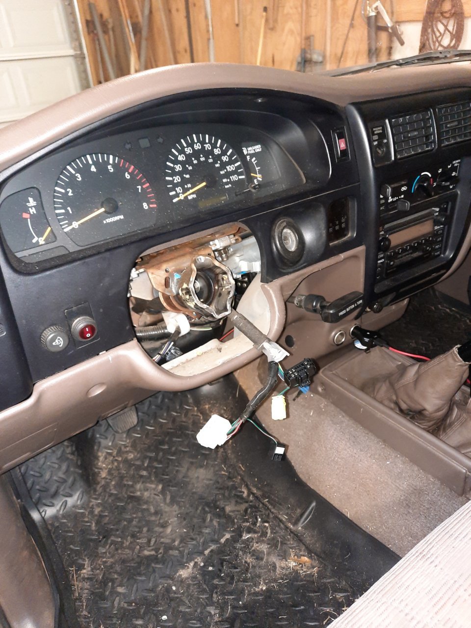

    Only took me maybe 1.5hr because I found one on eBay and ultimately just decided to buy brand new shaft (to keep safety measures) and do a quick swap

    hey man, can you explain how you did this shaft swap? im trying to do the exact same thing but im stuck. How did you remove the old shaft? Im cant figure out how to remove the upper shaft from the steering wheel/column thing. From the FSM it appears to be held in place with a compression spring and snap ring but I havent a clue how to remove and replace. Also did you replace the bearing (the FSM says its a non-reusable part)

    Hey, I just followed all the steps in Timmy's video that was shared above by Dalandser. Thanks!
    But I guess I didn't mention, I actually did not replace that upper 6" shaft section into the steering wheel (since that was fine) I left that in place and just replaced the white tilt bushing and lower shaft with the new parts I got. Just tilts to one side 90 deg to then separate, I think he shows it in the video too
    Also I don't think I did anything wrong, because it does all only go in one way. But I still needed an alignment after to straighten my steering wheel back up to normal. But now everything is super tight like brand new!

    Ah ok thats what i ended up doing exactly. Except I took my steering wheel off and re-installed it straight. No alignment needed. Thanks for the update.
