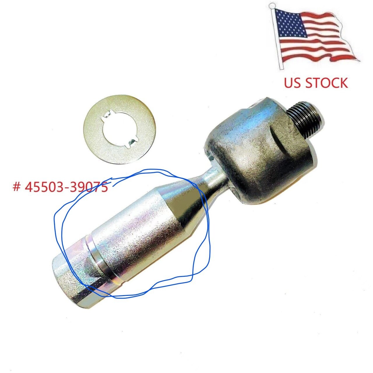

    You can adjust each tie rod a tiny bit....equal on each side....
    to carefully precision align the wheel...
    those small amounts wont make a difference in track geometry or range of motion....
    put the steering at wheel a 12 oclock...and then adjust to point the wheels forward.....but Equally
    one goes out half turn.....other side has to go in half turn...
    and both wont be perfectly straight forward.....they should both be 'toed in' slightly....
    most likey your rack is not perfectly centered for range anyways....
    unless its the original with the original tie ends...
    Careful when you adjust these.....if that inner tie rod's lock washer is not staked out correctly.....you could bust the inner rod loose from the rack......
    seen that happen a few times........but that would of come apart eventually anyways...

    Also if the inner tie rod spins too easy.....that means its wore out...
    should be significant resistance to spin that.....

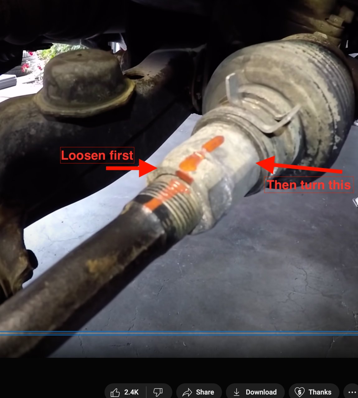

    Ok so just to be sure im following.... I would first loosen the tie rod nut, then turn the inner tie rod?

    Pull / slide off the constant tension clamp....
    put a little silicone spray on that boot opening...
    when you spin that shaft....make sure its not loosening where bolts into the rack...
    its got to spin on its ball joint....and if its new.....its gonna to be tight....
    be gentle with it.....take your time...
    if that pops loose and spins freely from the rack end where it screws in, you'll have to slide the boot off the other end....and retighten that, and restake that fang washer...SO SPIN THAT SHAFT SLOW AND CAREFUL....feel that joint slip.....
    If you turn that half a turn its barely perceivable....
    full turn on each side you'd definitely notice....
    soooo...somewhere in-between there....
    baby steps....
