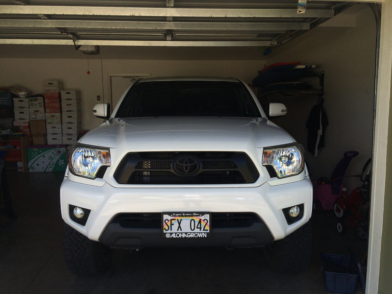

    11/24/2018 - current:
    welcome to my build. On 7/4/2014, I caved in and upgraded from a 2003 4dr to a 2014 4dr Tacoma. I wanted to build a truck capable of handling semi-difficult trails to our local camp/fish/dive sites, but since it's my daily driver, I'm not planning on going all-out... I think.
    Big mahalo to all the local TW Oahu ohana for their advice, help, and guidance. I still have a few more things to upgrade, but with a 4.5 yr old, and 1.5 yr old twins, I think I'm good... for now.
    Basics:
    2014 Toyota Tacoma TRD Sport 4x4 (Super White)
    Heavy Duty Vinyl Flooring
    All Weather Floor Mats
    Tow Package
    OEM Bed Mat
    Suspension
    Front -
    Icon 2.5 Extended Travel Coilovers (58635)
    SPC Light Racing UCA's (set to 3.5 degrees caster)
    Wheeler's Front Superbumps
    Removed swaybar
    Rear -
    Bilstein RCD 5100 (F4-BE5-B110-T5)
    OME Dakar Rear Leaf Pack (CS047R)
    All Pro U-Bolt Flip Kit
    Wheeler's Rear Super Bumps (mounted on AP flip kit strike plate)
    Currently measuring 22.75" (front) and 23.75" (rear), hub to fender.
    Wheels & Tires
    16"x8" Konig Countersteer Offroads (Matte Bronze)
    265/75/16 Goodyear Duratracs
    Full-size matching spare
    Protection (or lack of) & Recovery
    Pelfreybilt Aluminum IFS Skid
    All Pro APEX Bolt-On Sliders (no fill plate)
    Factor 55 Hitchlink
    Smittybilt Quick Release Shackle
    Masterlock 1469DAT Hitch Pin
    Lighting
    PIAA Xtreme White H4's
    Foglight Anytime Mod
    Morimoto XB LED Foglights

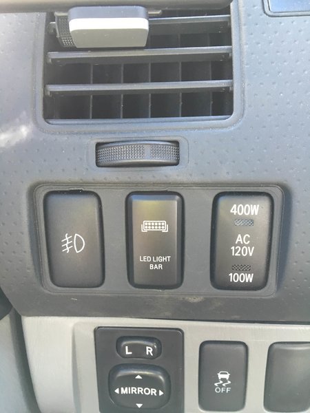

    OPT7 22" LED Light Bar (wired to Mictuning illuminated dash switch)
    Interior
    Mirror Relocation Bracket (by @ImMrYo)
    LED Interior Lights
    Wet Okole's (front/back/center console) - Black w/ Charcoal Piping
    Ultragauge EM Plus (wired)
    Exterior
    Rear Diff Relocation Mod (behind driver's side tail light)
    Toytec SS Extended Rear Brake Lines
    Fumoto Oil Drain Valve
    Debadged & Plastidipped Front Emblem
    SlyBracket No-Drill Front License Plate Mount (by @ernhon808)
    Snugtop XtraVision Camper Shell
    Yakima Roof Racks
    Yakima Powderhound (Small) Rack (for fishing poles)
    TJM Awning (Small) - 7' x 6-3/4'
    OEM Bed Mat

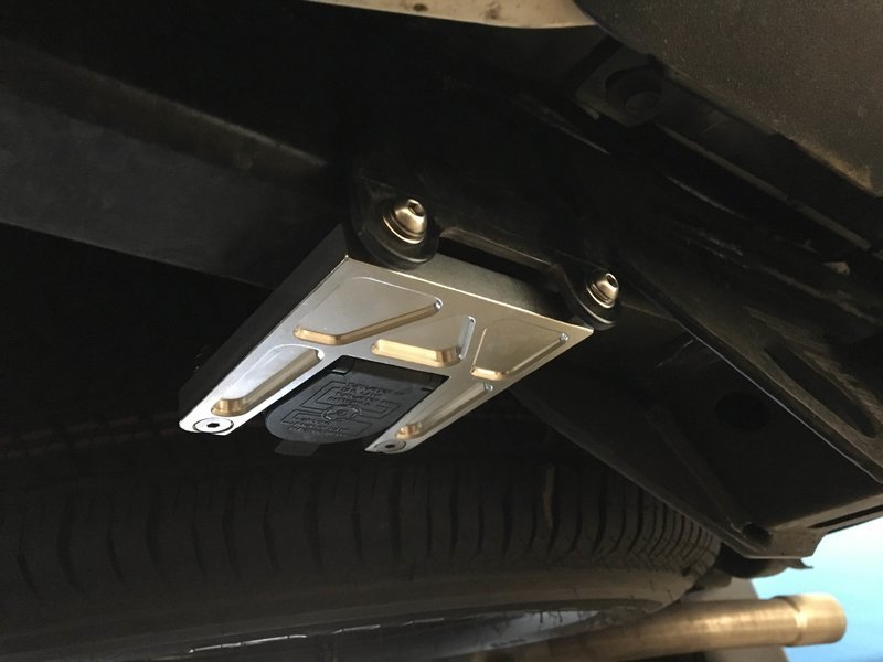

    Custom Trailer Harness Relocate Bracket (by @bullaculla)
    Non-Scoop Hood
    Trimmed OEM Front Mud Flaps (cut ~5")

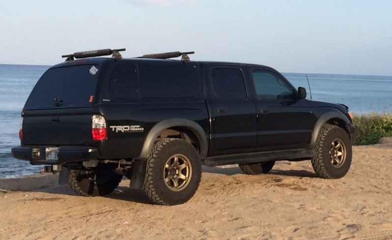

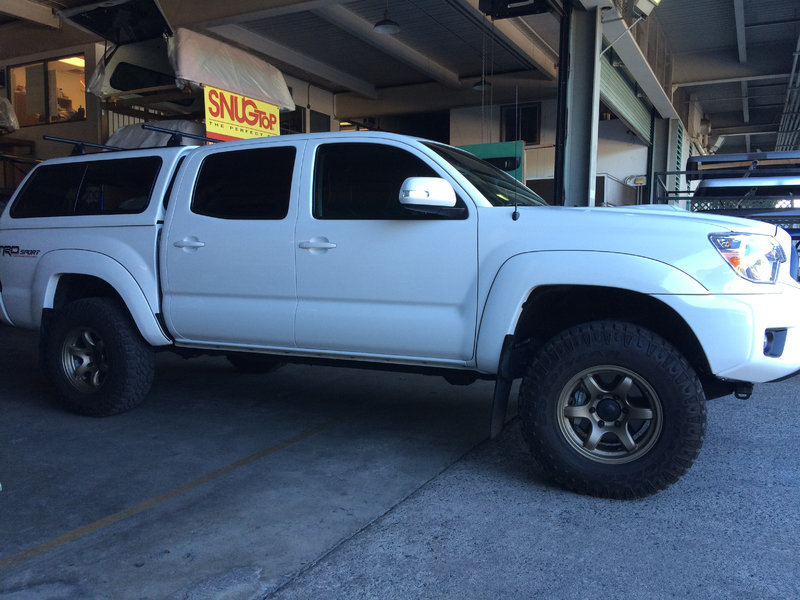

    Said goodbye to this, to upgrade to my current Tacoma -
    7/4/14 - took delivery with only 4 miles on the odometer -
    7/5/14 - mounted up my matte bronze Countersteers wrapped with 265/75/r16 Goodyear Duratracs from my old Tacoma... matched pretty nice. I only had to remove the mini front plastic flap, but other than that, no rubbing issues -

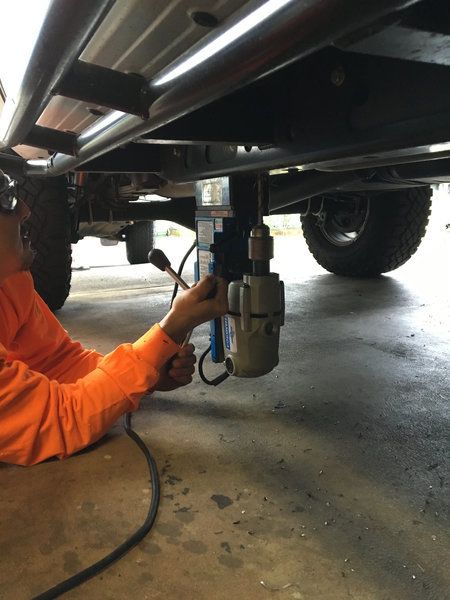

    9/14/14 - my first real upgrade... basically watched @bullaculla and @luka install OME 885x/5100's, rear 5100's, and Icon AAL's. I never got into tinkering around on vehicles, so this was my first big learning experience, so hopefully I can tinker/adjust/upgrade stuff myself -
    took a little break thinking I was done, but the more I followed the TW Hawaii forum, the more I realized that I should've bought the "good stuff" from the beginning. thanks to Sarah from Boss4x4 (@LikeABoss4x4), I was able to get all kinds of goodies through Hawaii group buys. so off we went...
    7/2/15 - caved in to a camper shell after months of searching for a snugtop locally. Snugtop XtraVision (XV), interior LED light, roof-mounted gear net, sliding glass and screen windows, flip-down front sliding glass window. spent an ungodly amount on this due to the fact that there's only ONE authorized dealer, and shipping to Hawaii is absolutely insane.

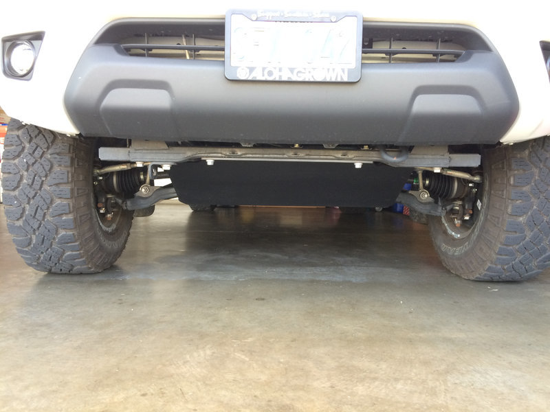

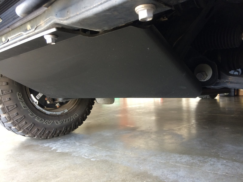

    7/8/15 - painted (Rustoleum satin black) and installed a Pelfreybilt aluminum IFS skid, purchased through Boss4x4 Hawaii GB -

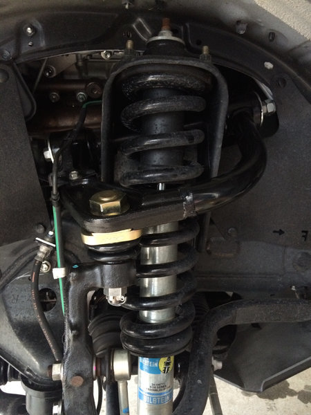

    9/19/15 - installed the SPC LR UCA's. when I stay "installed", I mean, basically watched @hacklerjason install it. haha, but it was a good learning experience for me.
    11/7/15 - took advantage of All Pro's free shipping to Hawaii deal, and hooked up with @1uzrnr to get a smoking deal on a set of APEX bolt-on sliders, without fill plates. got them locally powdercoated semi-gloss black (mahalos to @hacklerjason for the referral). bolted them on myself, which was an interesting feat, and thanks to @deeezy for the mag-drill help.

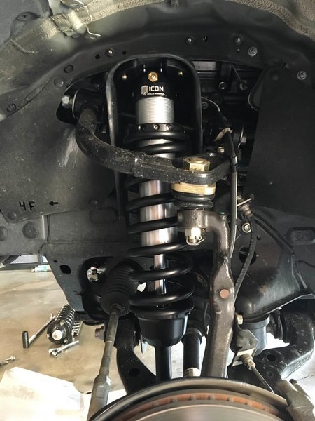

    11/14/15 - received my Icon 2.5 extended travel coilovers a couple weeks prior, and had to setup a rear leaf swap (my stock + Icon AAL for OME Dakars) and suspension install at the secret Hawaii shop :D. also scored @rka's used Icon VS rear shocks and ended up selling my 1 year old suspension (885/5100's) to recoup some of my money. I also removed my front swaybar and ended up selling it on Craigslist. also, at some point prior to this, I installed the All Pro u-bolt flip kit and front/rear Wheeler's Superbumps.

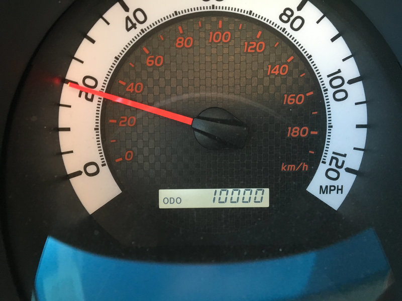

    12/17/15 - finally hit 10,000 miles. yes, I don't drive far.

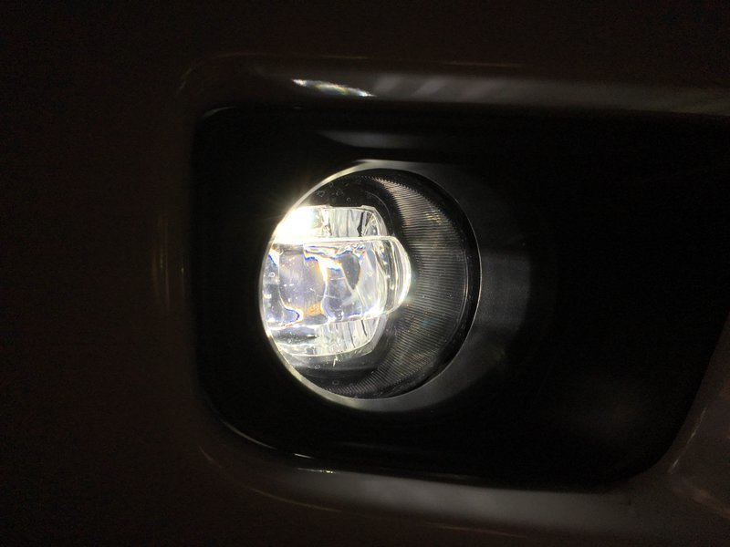

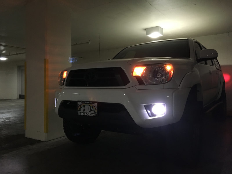

    12/18/15 - scored a used set of Morimoto XB LED foglights from fellow TW Oahu member @hoenah808. installed and I'm happy with the output and color.
    12/21/15 - got my trailer relocation harness from fellow TW Oahu member @bullaculla, along with some of his infamous Bullaculla tritium FOB's.
    12/27/16 - last upgrade before moving from Oahu and back home to the Big Island. @kh7nm was nice enough to install my 22" OPT7 LED light bar and wire up the Mictuning switch to my dash. super stoked he was able to install cause this was way over my head. used an iron bar mounted to the stock crash bar brackets, so I could tuck the light bar behind the lower grill (no cutting).
    a couple shots of the XB LED fogs and OPT7 LED light bar -

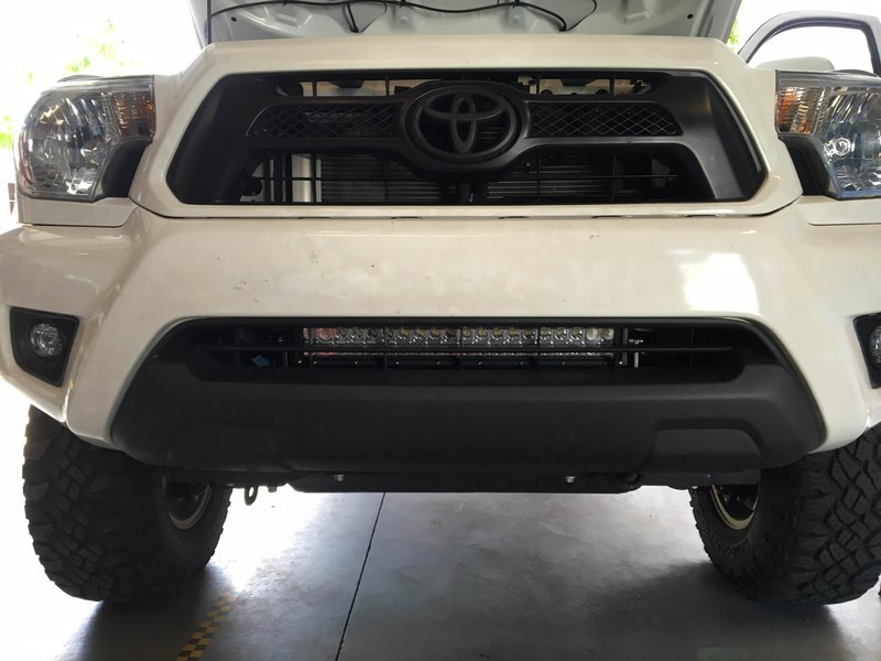

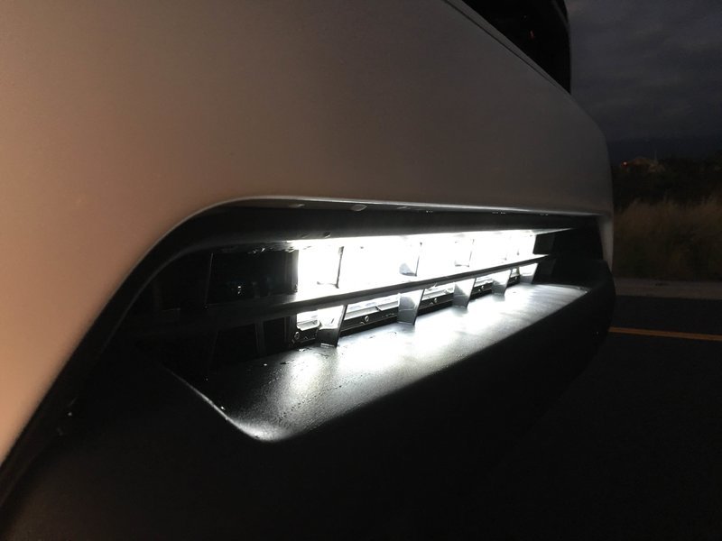

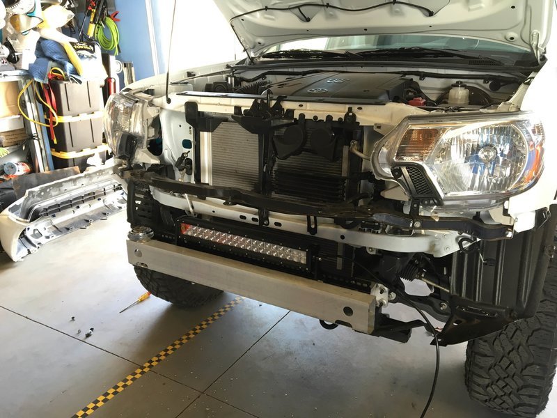

    Do you have more pics of how the iron bar is mounted behind the bumper?
  17. May 18, 2016 at 11:18 PM
    #17
    cubiclesurfer
    cubiclesurfer [OP] Well-Known Member
    Aug 1, 2012
    #83894
    1,422
    Kailua-Kona, HI
    I keep flip-flopping between the 255 KM2's, 285 Cooper ST Maxx or STT Pro, or playing it safe and sticking to 265 Coopers (so I know I can fit the spare in the stock location). I wanted 255 ST Maxx, but Lex Brodie's won't bring them in, and Amazon Prime won't ship them here :mad:
    I don't have exact pics, but this is basically how I did it:
    https://www.tacomaworld.com/threads/led-light-bar-mounted-in-lower-bumper.255567/page-5#post-9611644
    if you pop the hood and look down at the crash bar brackets, you'll see 2 holes (unused). basically, I measured the thickness of the bracket and hole size, bought 2 screws and some washers, and lined up the angle iron to the existing holes and bolted it on. if your angle iron doesn't line up exact, you may need to enlarge the holes, but at least you don't need to drill new ones (unless you wanna mount the bar back a little). if you look at the pics, the bar is right behind the lower grill, but not touching. the only downside is that you can't fit a cover on (i.e. amber, smoked, black lens) cause there's no room. I had to use angle iron cause my light bar is a 22". I think the 30" ones span the gap, so you don't need the angle iron. I can post some pics on here tomorrow.

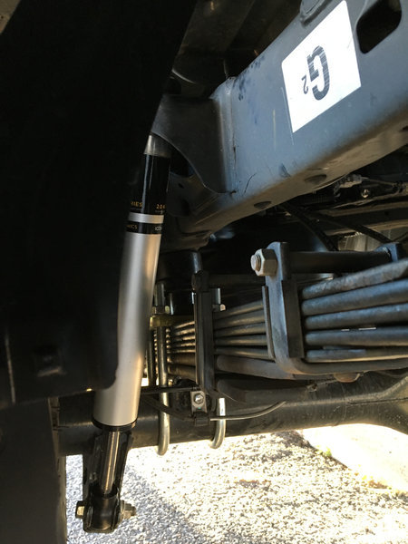

    Kailua-Kona, HI

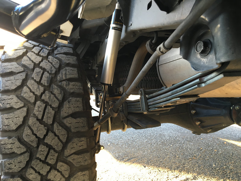

    now that I have my tires on order, my next issue is rear shocks. I'm really stuck on what to get with the Dakars. according to @OZ-T's Dakar measurement thread, I'm sitting about 7/8" lower (23-3/4") than the average result for a DCSB, with the full leaf pack. I'm not sure if this is the result of running a camper shell, and broken-in leafs though :confused:
