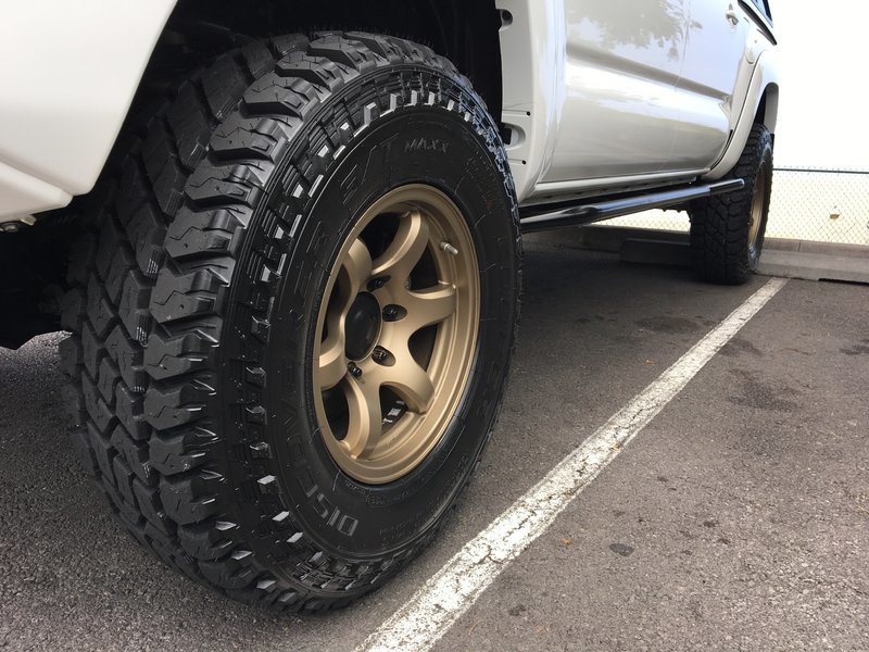

    got the Cooper ST Maxx 255/85's installed (finally).
    first impression: tires are WAAAAY quieter than my duratracs. can feel a slight difference (lag) in acceleration due the increased weight, but it's not bad. stoked at the way these feel.

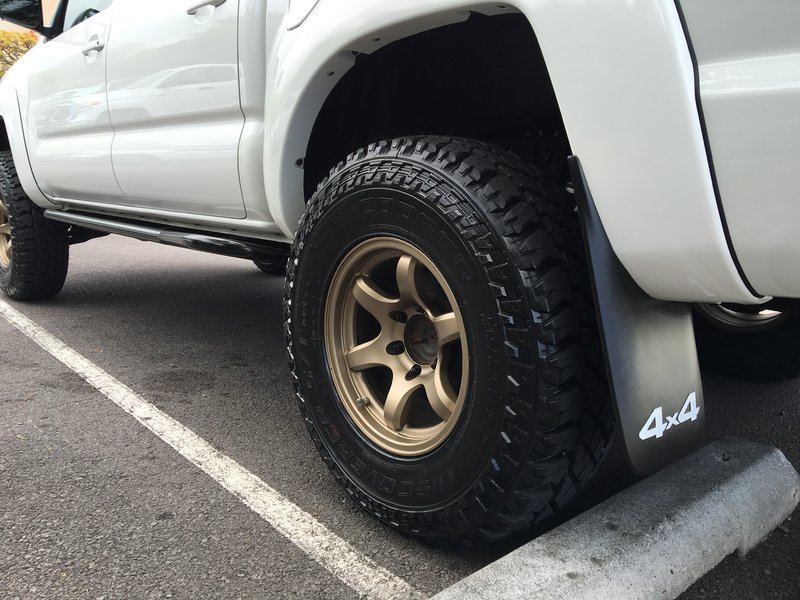

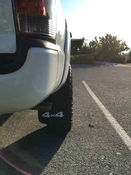

    in case anyone ever needs pics for reference... fills the wheel well way better than the 265/75's, sits perfect under the fender, and can even run front mudflaps (for normal driving) :bananadance:
    front Icon's ~2.5" lift
    rear Dakars ~ 3.25" lift
    Cooper ST Maxx 255/85/r16
    Konig Countersteer Offroad 16x8", 4.5" BS, 0 offset
