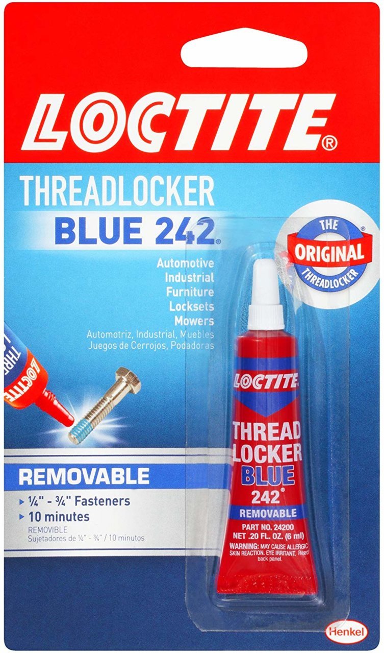

    Honestly, my biggest complaint is the shifter knob twists super easy when the cab is hot. That one thing drives me crazy

    (although i suppose you could have a clip version without threads)

    No clips, it twists. I'm familiar with loctite, use it all the time in my line of work. Just not sure it will work with the amount of expansion and contraction that is happening with the heat. I'll try it one day I'm sure
