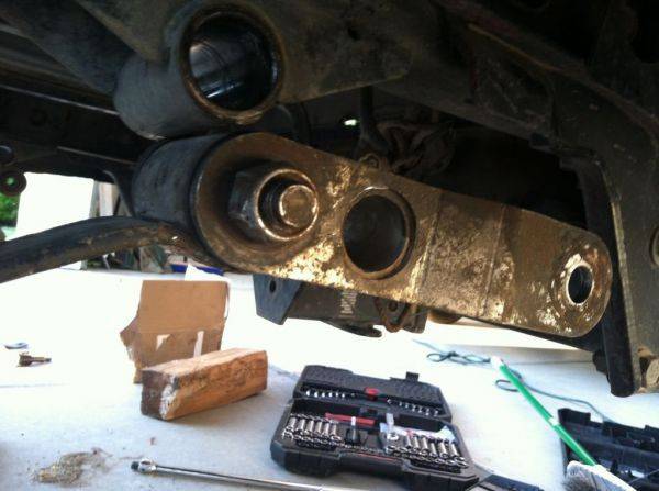

    got some new daystar 1.25" lift shackles from Jon.

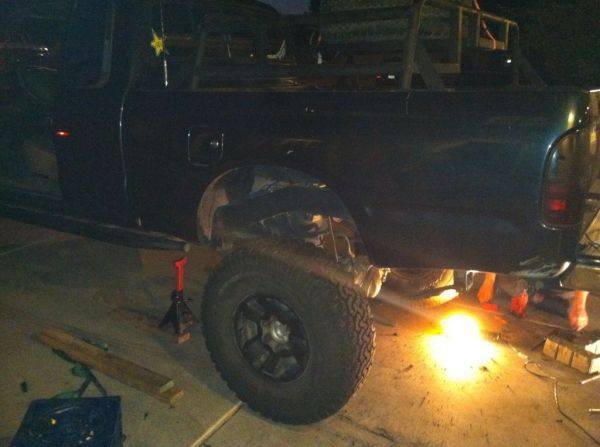

    As always I began a project the night before I left on a major camping wheeling trip. I will never learn. I got out the factory leaf bushings and discovered the bushings wheelers sent me didnt fit in the leaf eye let at all.
    someone said something about a metal sleeve being in there but I didnt notice one or see anything move, so i may have derped and done all this for nothing but ill rip it apart and see if i can find a sleeve and order new bushings.
    by this point it was either cut up the new bushings to make them fit or dont go to wyo. so i grabbed the hack saw and make the new bushings fit snug and called it a night and finished at 11pm. I planned to leave at 4am. I still had to pack the truck so i didnt actually leave till 7.
    I will take the shackles out and redo the bushings with ones that fit and aren't cut up with a hack saw fairly soon.

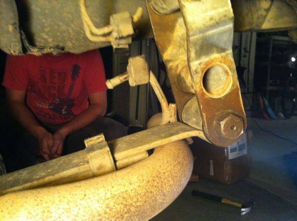

    getting the shackle on, massive pain in the ass. took a lot of work to even get here.
    got the other side on and drooped it and measured. eye to eye is 24.5" and my shocks are only 23" at this point. so my 5100s are limiting my droop bad now. sad day.

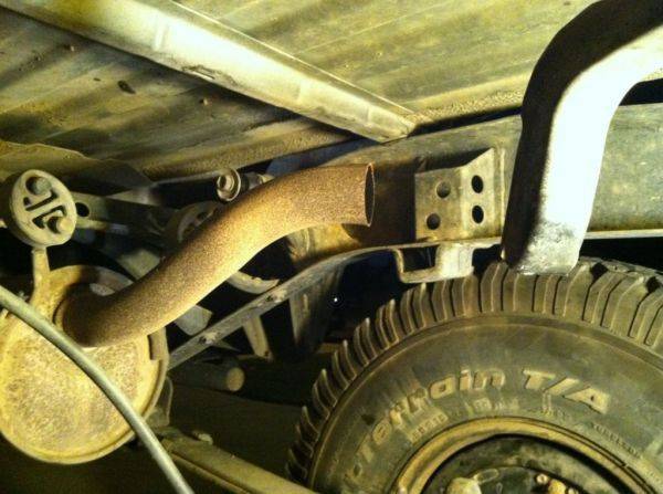

    noticed the shackle was getting in the way of the exhaust badly, so that got chopped off.

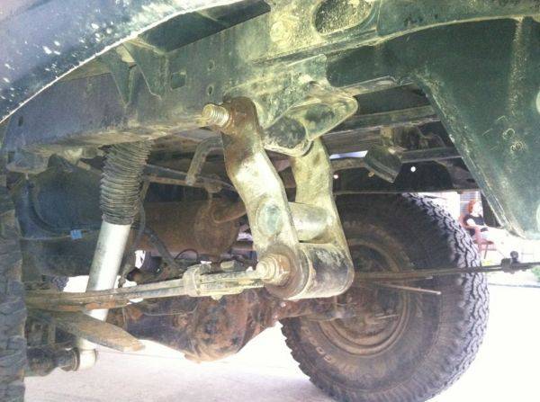

    just another quick shot of the new shackles

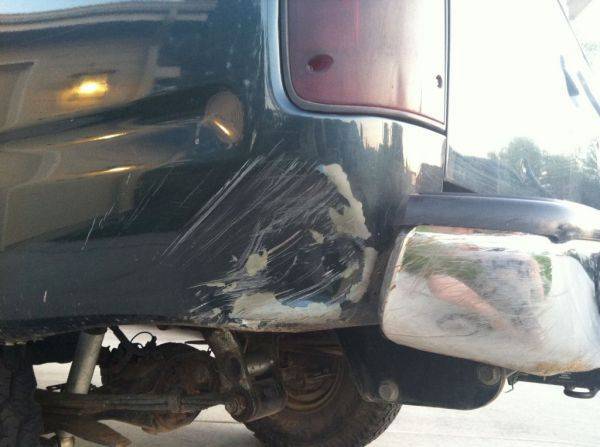

    throwing up the trail damage I got wheeling in july. Worst body damage ive gotten so far. however I only see it getting worse from here
