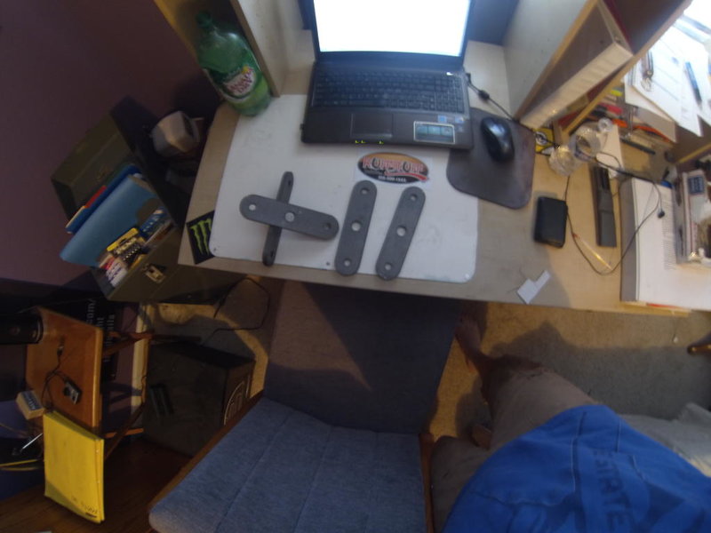

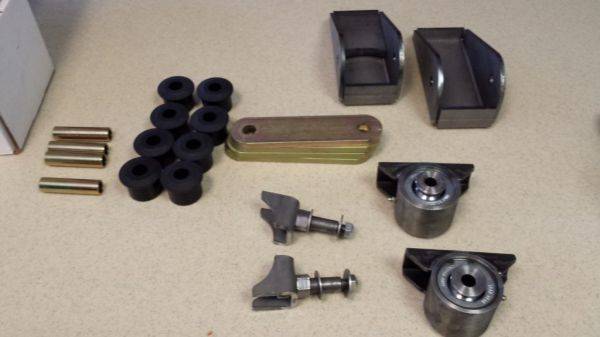

    right then, here is most of my stuff for the 63 swap. parts are waiting and ready to go
    have to remember to get some extended brake lines too.
    had annoying, small snag, factory toyota shackle/leaf bolts and factory chevy leaf bolts are 9/16ths. so when I ordered toyota shackle plates from low range, what size did I expect the bolt holes to be? 9/16th, I got them and apparently all of their shackles are an m18 size hole :frusty: so i i send those suckers back and buy some plates from ruff stuff which come with a .5" hole drilled in them, so ill be able to drill out a bit bigger for the 9/16th bolts. love taking a hit on restocking fees and return shipping :rolleyes:
    got the correct shackle plates

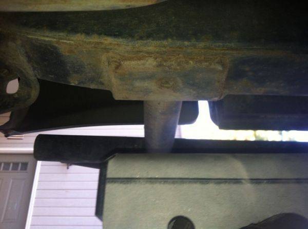

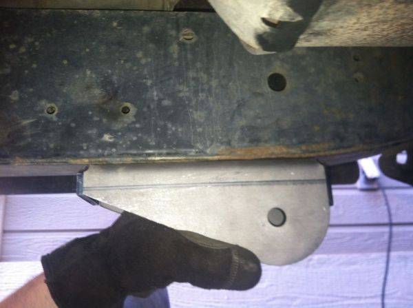

    In preperation for the 63 swap, I had to remove some slider material from the bottom of the legs so the hangers can sit flush
