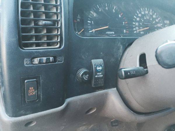

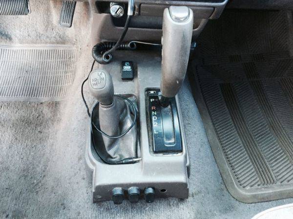

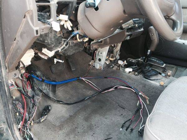

    I am now officially wired for a front locker, and the pump worked first time! Gasp!

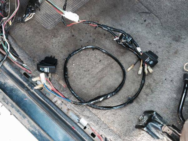

    Extended the pump isolation switch harness so the pump switch wasnt right next to the locker switch
    Cleaning up all of my gross wiring
    Locker switches
    and the pump switch. In the process I moved my LED light switch down to the center console so the RR diff lock switch could take its place

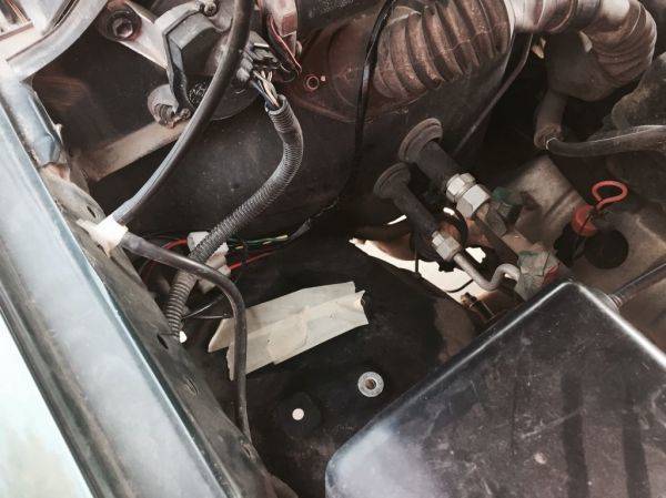

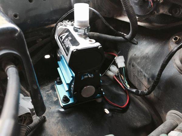

    Nice and easy mod today. Got my arb compressor all mounted and secured in place. Its like the pump was made to go here. Drilled a couple of holes, added some spacers so the mounting plate sat level, and bolted it in! Next step is to actually get the locker wired in and im ready to rock!

    Nice! I need to mount and wire mine ASAP... What compressor is that?

    He has the mini ARB. It's only good for running lockers. The mid grade ARB isn't bad for airing up tires, but the dual ARB is where it is at!

    Okay, yeah I got the mid grade one from a group buy a few months back.
