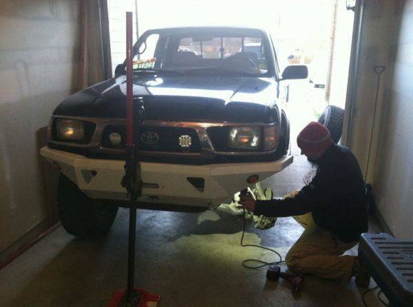

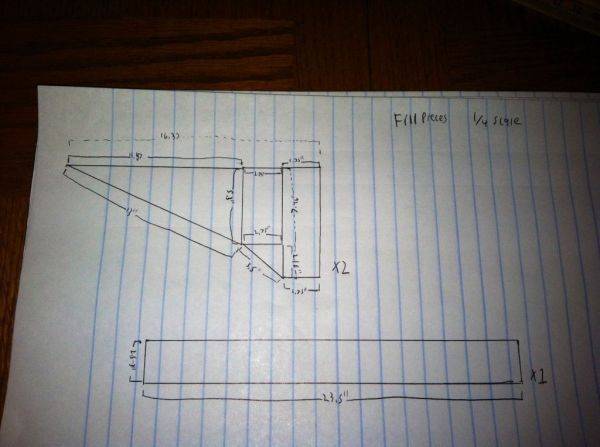

    Also, here is my design for the bumper fill pieces, lets see how close they come to working and how well they match the design in reality.

    Bumper looks good Mark! now gold plate that bitch you can out shine brady and his chrome

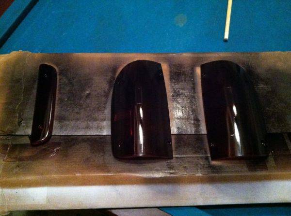

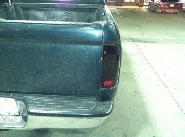

    Just going to add a few things in here so I dont forget. (ill get more pics of the bumper when its done and painted, whenever that will be).
    Tinted tails was the latest project..
    wet sanded it with 2000 grit, sprayed on 4 coats of vht night shades and then sprayed 3 coats of gloss clear. Love the way they turned out.

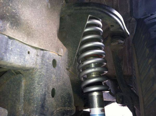

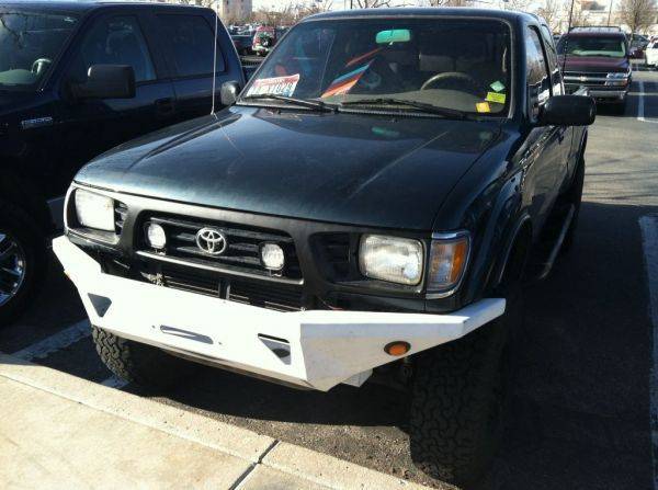

    Just updating a few more things in the build thread.

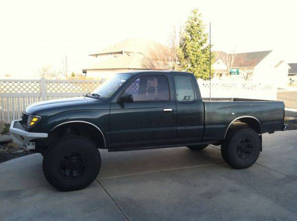

    Installed some Eibachs with andy's help. Actually, it was more like andy installed some eibachs and i watched lol.
    Gave it a significant amount of lift, which is now possibly causing other issues. A diff drop will be ordered soon.
    Some bro lean. Love the look tho!

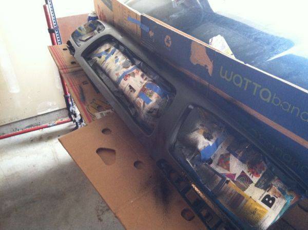

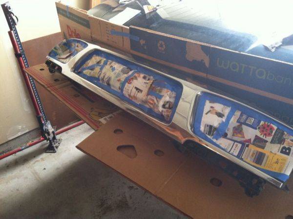

    Also dipped my grille. Ill get to the corner lights and fender trim later.
    I think I ended up doing 4 1/2 coats of dip. Really pleased with how it came out! SOOOO much better than chrome!
  19. Mar 28, 2013 at 7:16 PM

    i have the same front lift as you...now i can clear 37s no prob right!
