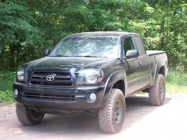

    U have a picture of how your truck sits so i can get an idea?

    5100s all around with front @1.75 and the toytec 1.5 AAL.

    ^ Looks pretty damn good imo
