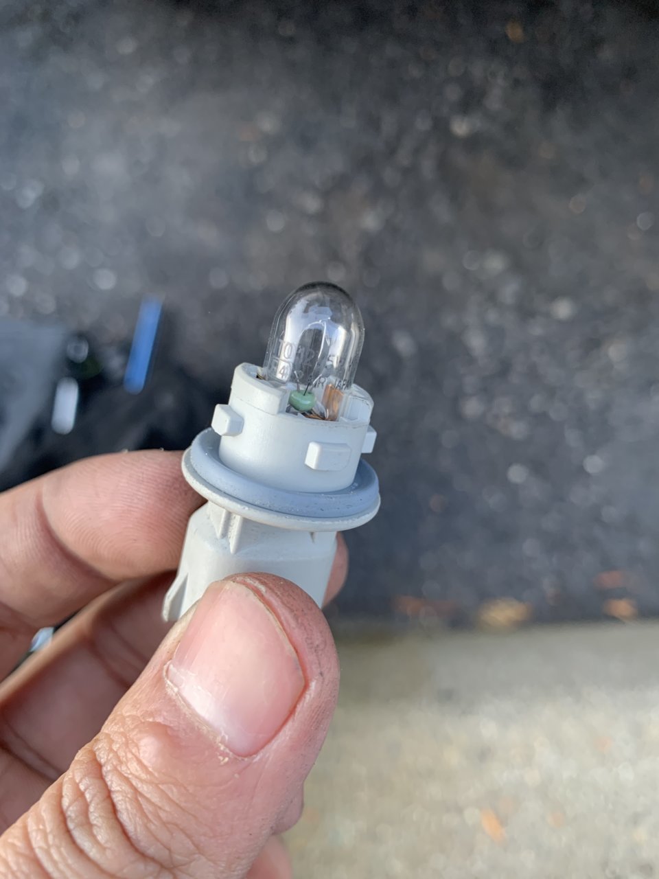

    Does anybody know how to remove this bulb? It’s from the headlight side signal

    Those peanut bulbs just pull straight out.
    I know they sit tightly in there (by design). In case you need to see for yourself:

    Yea don’t be afraid to pull, they’re tough to get out sometimes.

    Pliers..it is cheap

    Until you break the bulb and can't pull out the stem. Then you're buying the whole buld retainer assembly. Ask me how I know :rofl:

    Straight out. Over time with the heat of the bulb they can tend to bond to the socket. If you use pliers be gentle.

    Wrap it with some tape leaving a “tail” of tape you can grab. Then pull straight out. It’s the same thing for the interior map lights.

    Maybe use something like that thin rubber made to help opening stuck jar lids...
