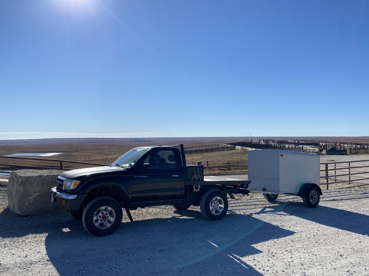

    For the low low price of “we never want to see it again”

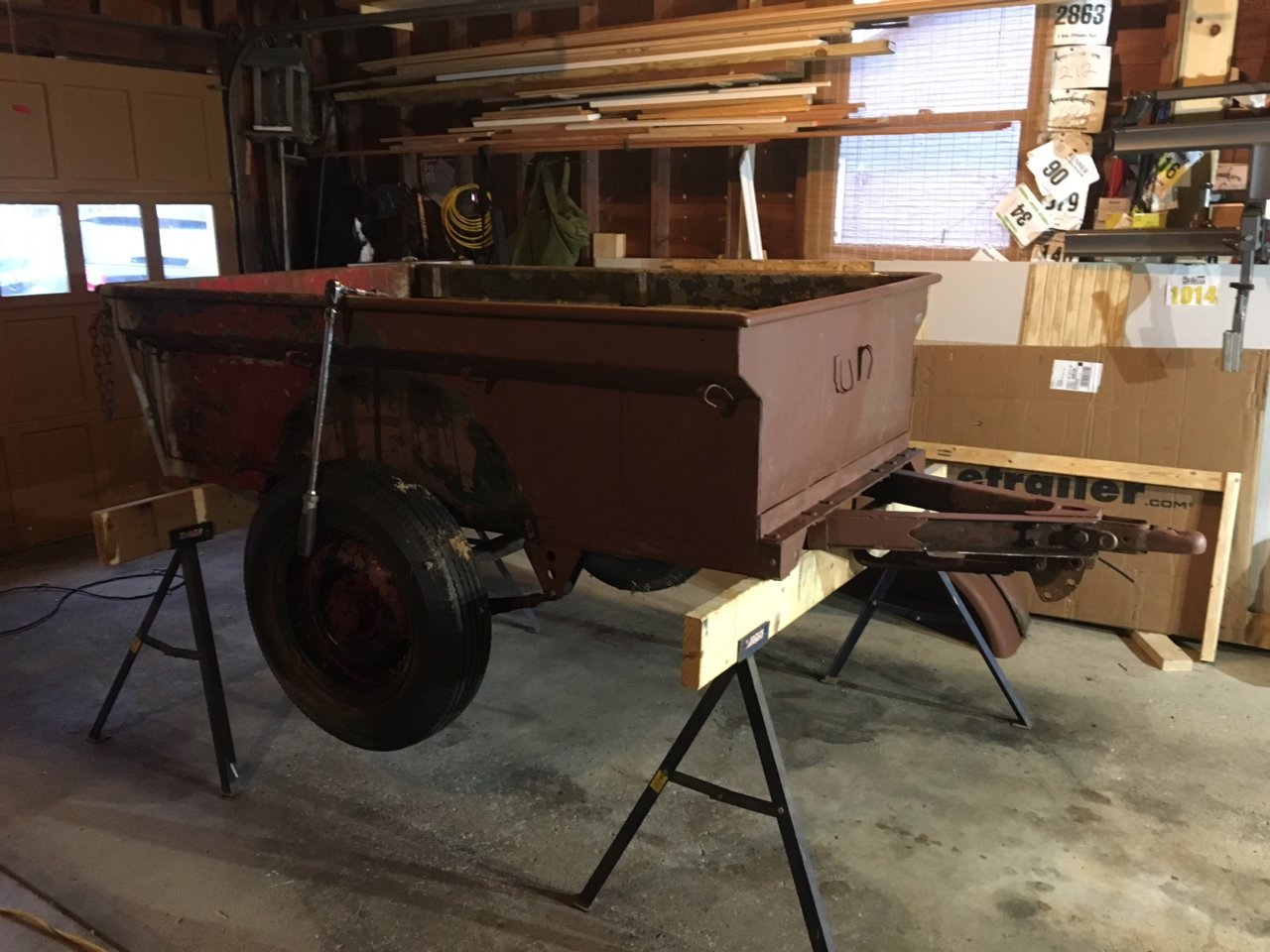

    446F3618-0FDA-4EF1-8FFE-4027334DFF47.jpg Mine got welded and primed, then we moved and it’s been hiding (from my wife) DFBCCB76-3798-43A2-A5DA-1D50911191B4.jpg 9BFE6785-3977-4D2D-BC89-4562C0D92516.jpg under a tarp behind the shed. New leaf packs, ID plate, and I’ve got to come up with a good looking light system.

    now thats a pretty good price lol
    Slashaar and 0xDEADBEEF[QUOTED] like this.

    oh wow an old bantam thats something you dont see often! does it have the tailgate? they normally do
    Rexfordian13[QUOTED] likes this.

    You find another deal like that you call me!
    0xDEADBEEF[QUOTED] likes this.

    thats a bit small for your tall ass lmao
    Slashaar[QUOTED] likes this.

    Yes sir, welded new hinges on in the last couple years. It’s been our family firewood trailer as long as I can remember.

    oh nice i tried finding one for the tail gate but couldnt find one before i found my m100
