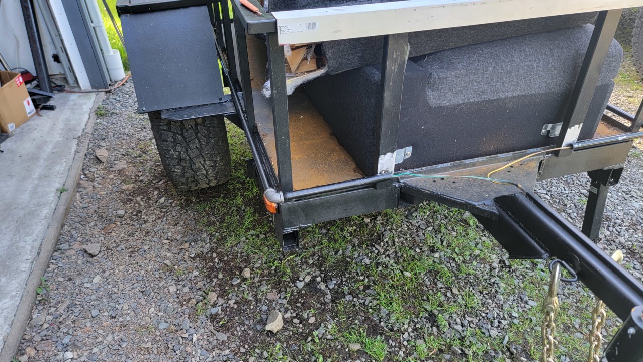

    Marker lights installed and re-ran the wiring. Got some schedule 40 pipe and ran it along the lower edge. That way it's protected and if I even need to change something I won't have to climb under the trailer

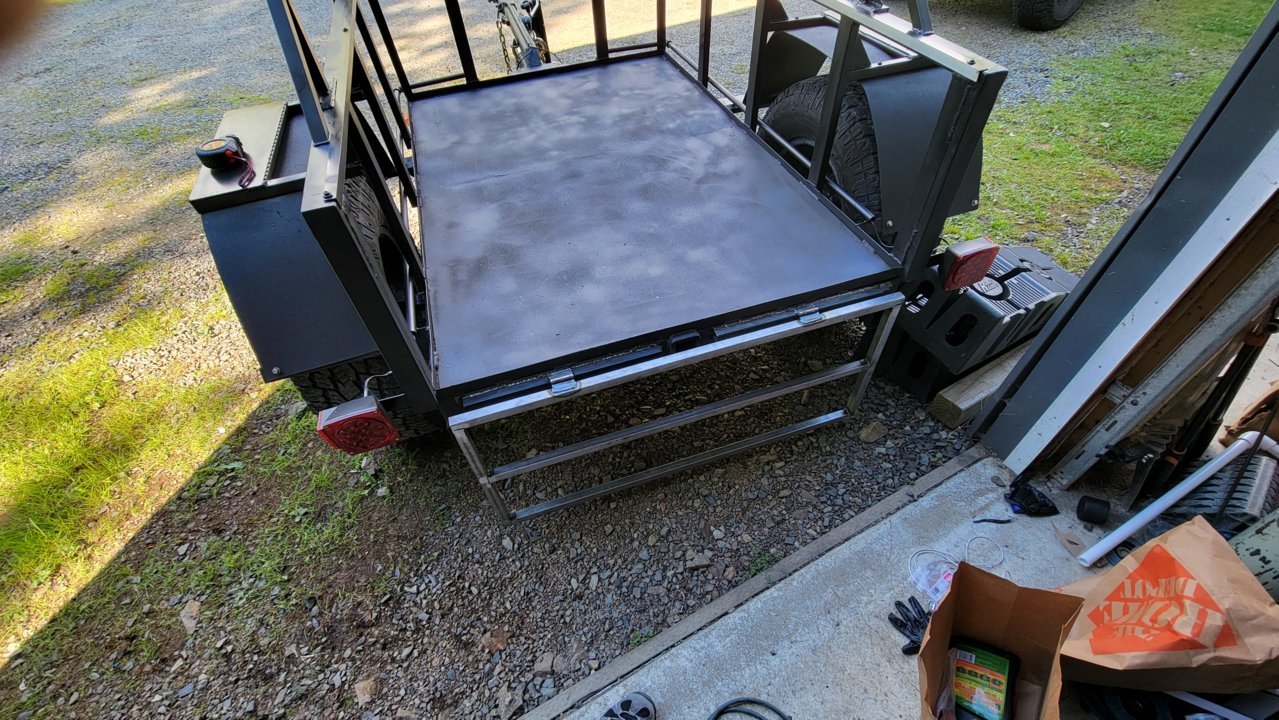

    Tailgate made, just need to skin it with something and figure out a way to secure it. I'm going to make a thing that slides into the receiver hitch to act as a support for it in case I want to use it as a "bed extender"

    Pretty much done now. Just need something to secure the tailgate and then go about getting it inspected by state patrol to get a title. Also need to get my tent on it, but should weigh it first

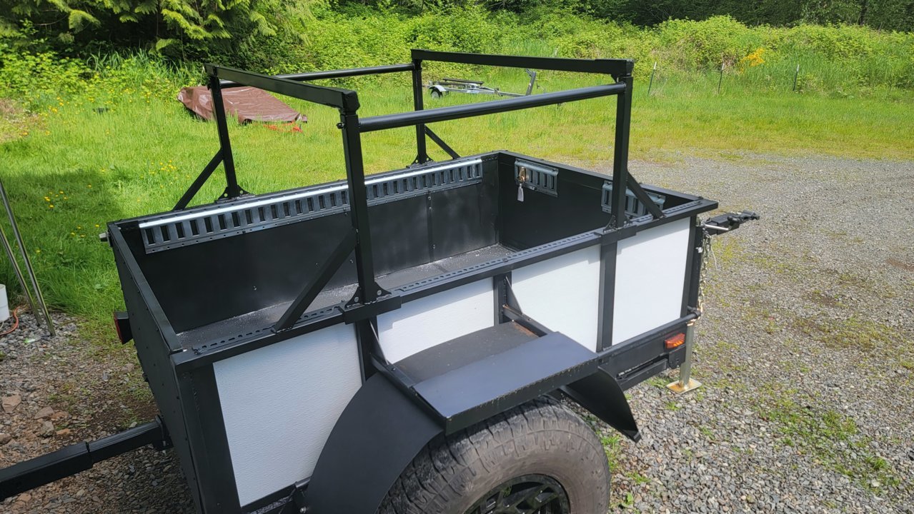

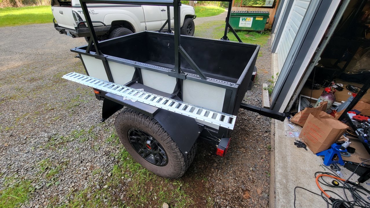

    I admit I have a mod problem, even already. I was thinking about tie down points and how I don't really have any when I remembered E-track is a thing and is stupid cheap at Harbor Freight. So for $92 I got a all the track and clips I could need.

    E-track installed. The death star is fully operational...oh wait, no my bad, the trailer is fully operational

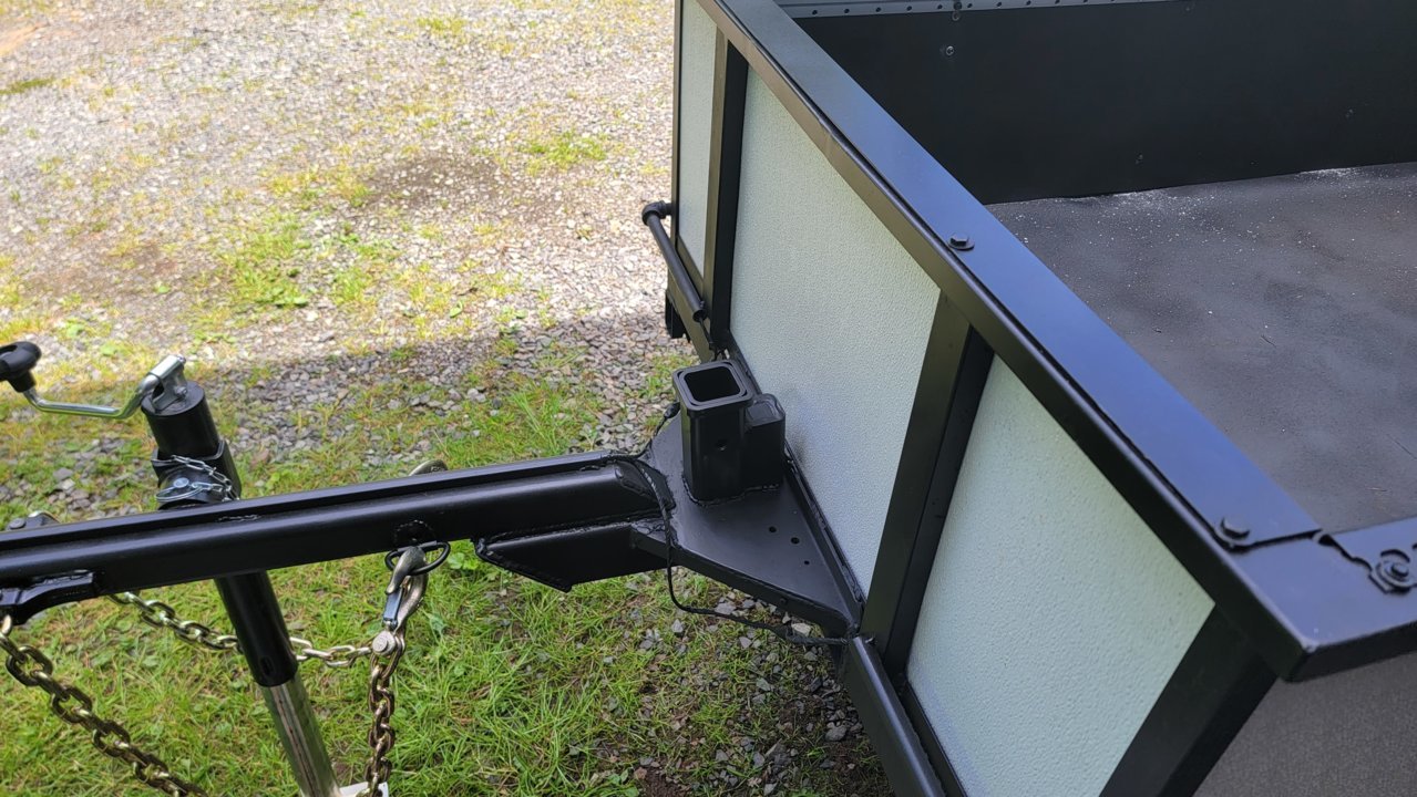

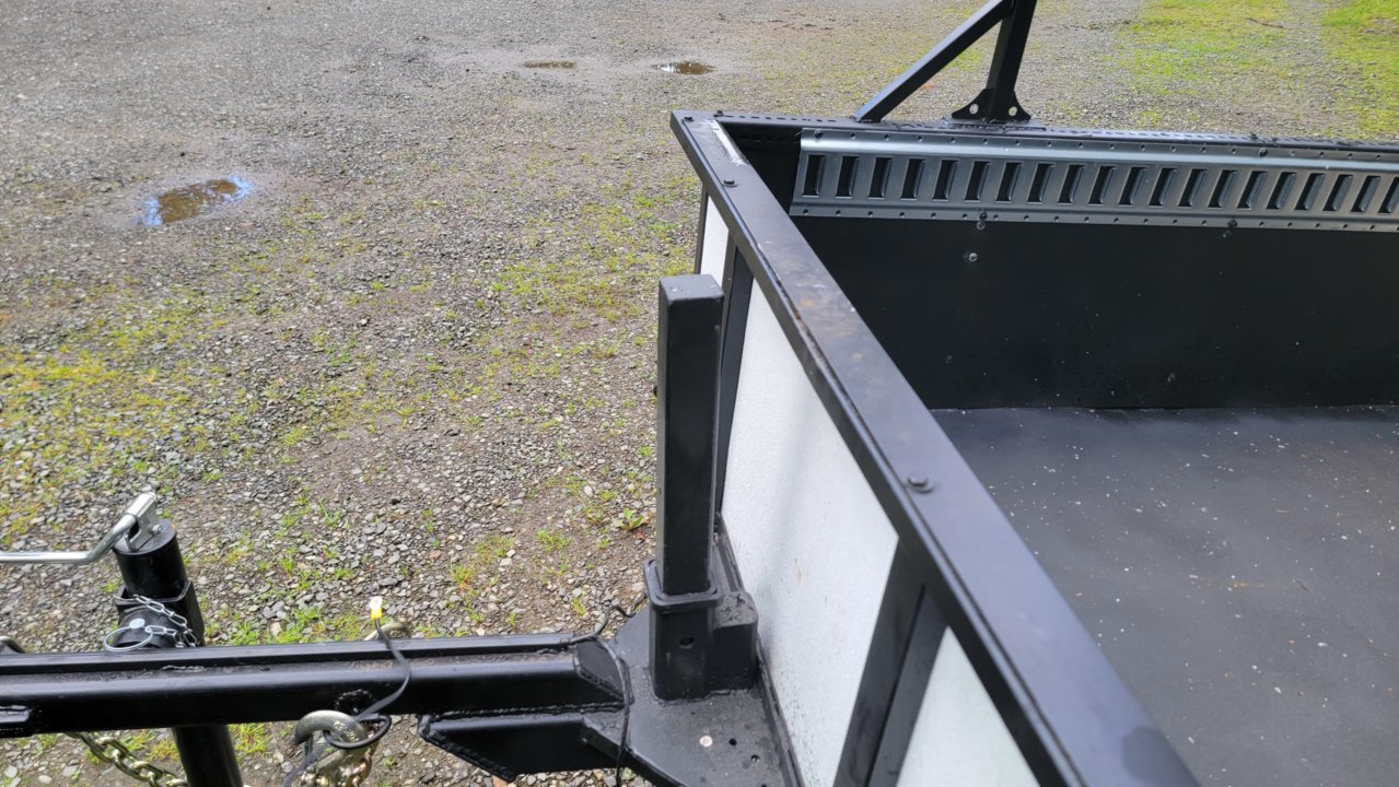

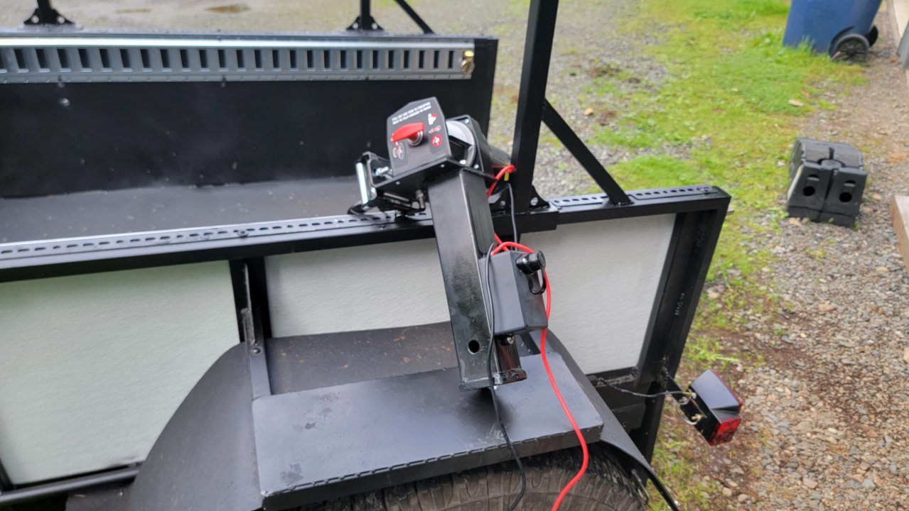

    I also had another ridiculous idea. I want the option of putting a small 2k winch on the front, but not always. Extra hitch extension laying around? Perfect. Now I can drop in a little winch and not worry about strength

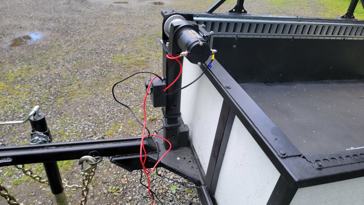

    Removable winch project mostly complete. Need to figure out a power source still, but the whole thing is removable without a single bolt, screw, anything

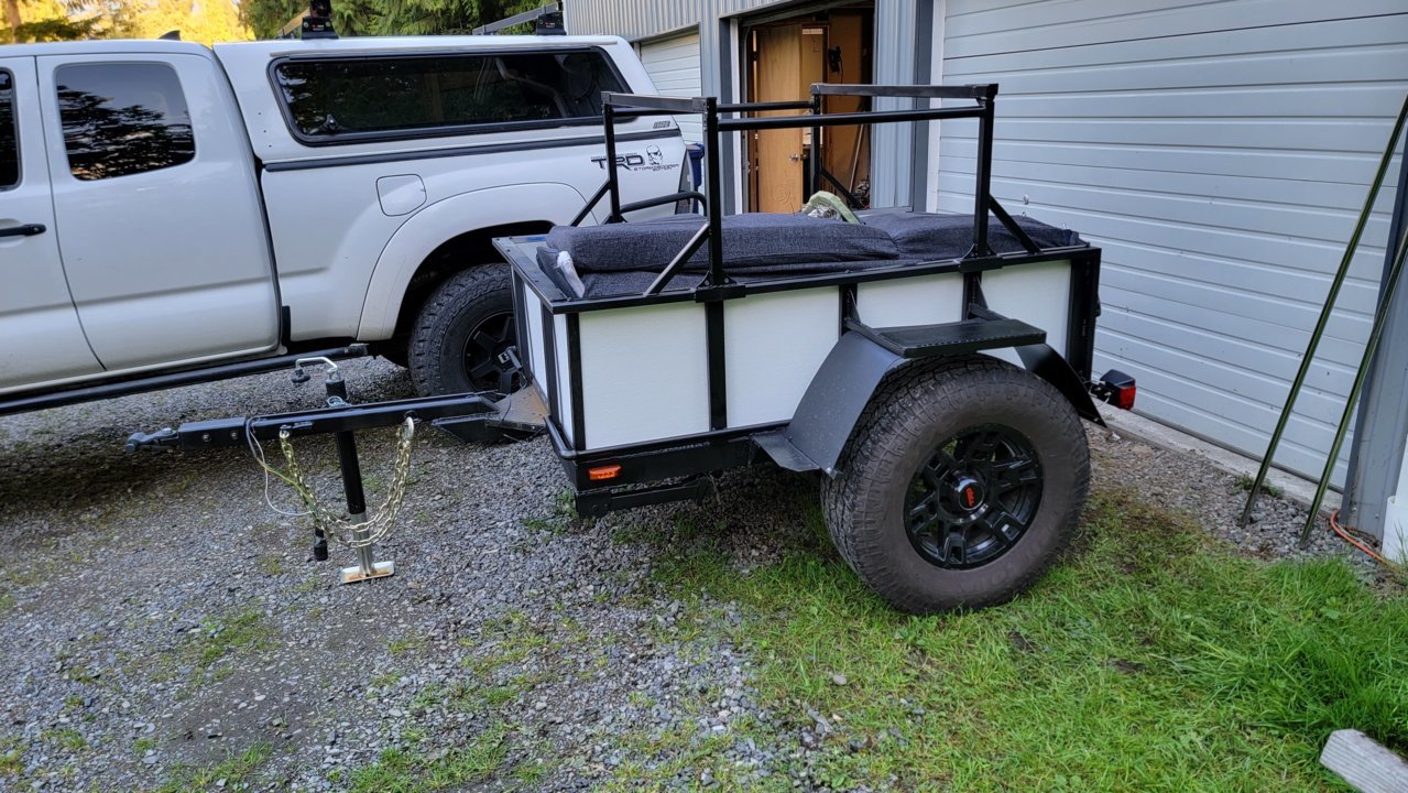

    I like how you did your fenders...I got a new axle with toyota bolt pattern for my little trailer, but my measurements were a little off and it's a bit wider than I wanted. Was messing around trying to figure out how to mount or make super wide fenders with the full size tires but it just looked goofy. What you did is pretty simple and looks good! I don't have any fenders on mine at the moment but might have to mess around with it again

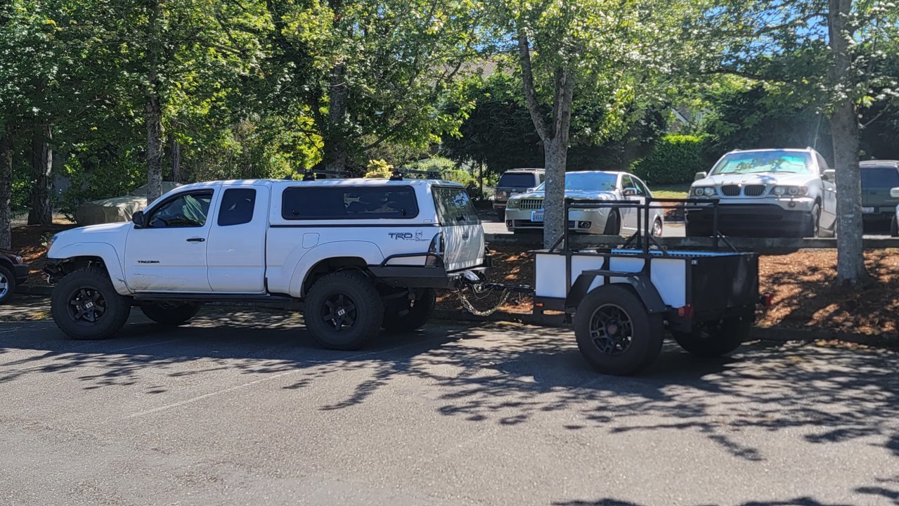

    My method is just start by doing something and figure it out as you go. Actually got to use it today for hauling a bunch of stuff for work. Can't even tell it's back there
