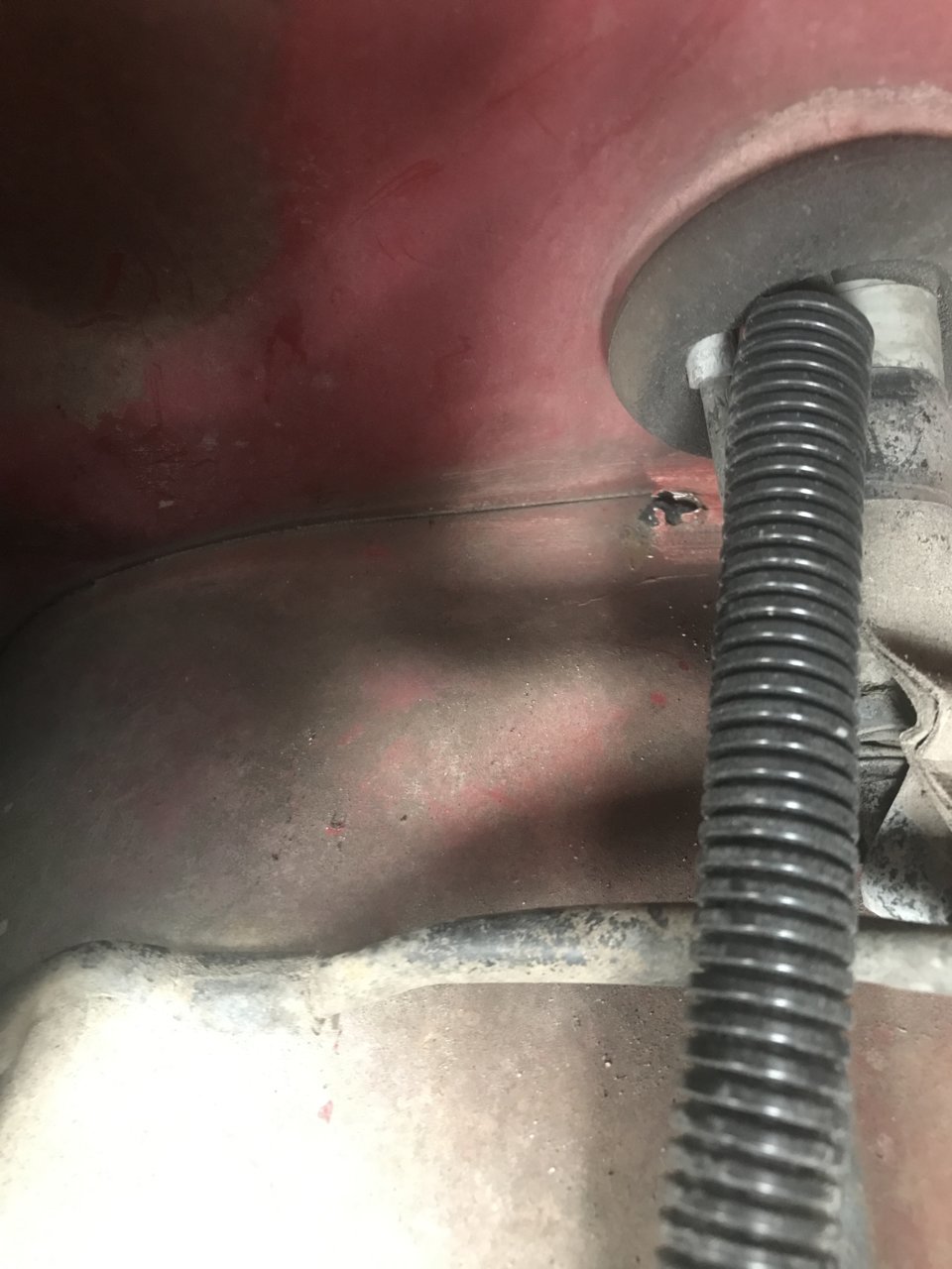

    check your firewall by your left foot. mine was leaking water onto the carpet- pull that carpet back if it's wet, or has water damage. That will tell you if you need to silicone any voids in the firewall.

    Would that be a concern. This is the firewall on the driver side

    bingo. silicone that sucker up! pull your carpet back too, to make sure it can dry out completely
