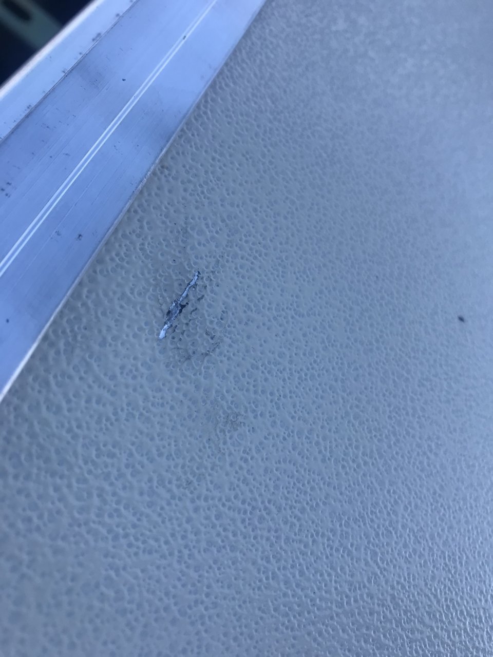

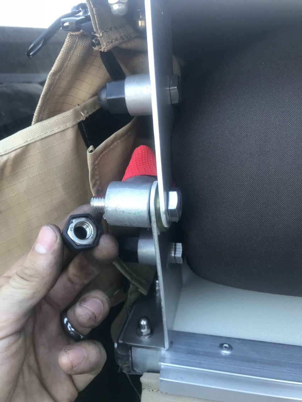

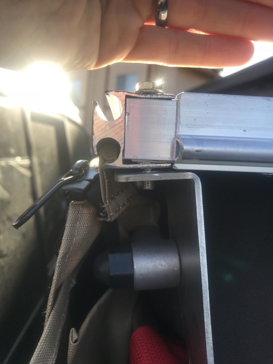

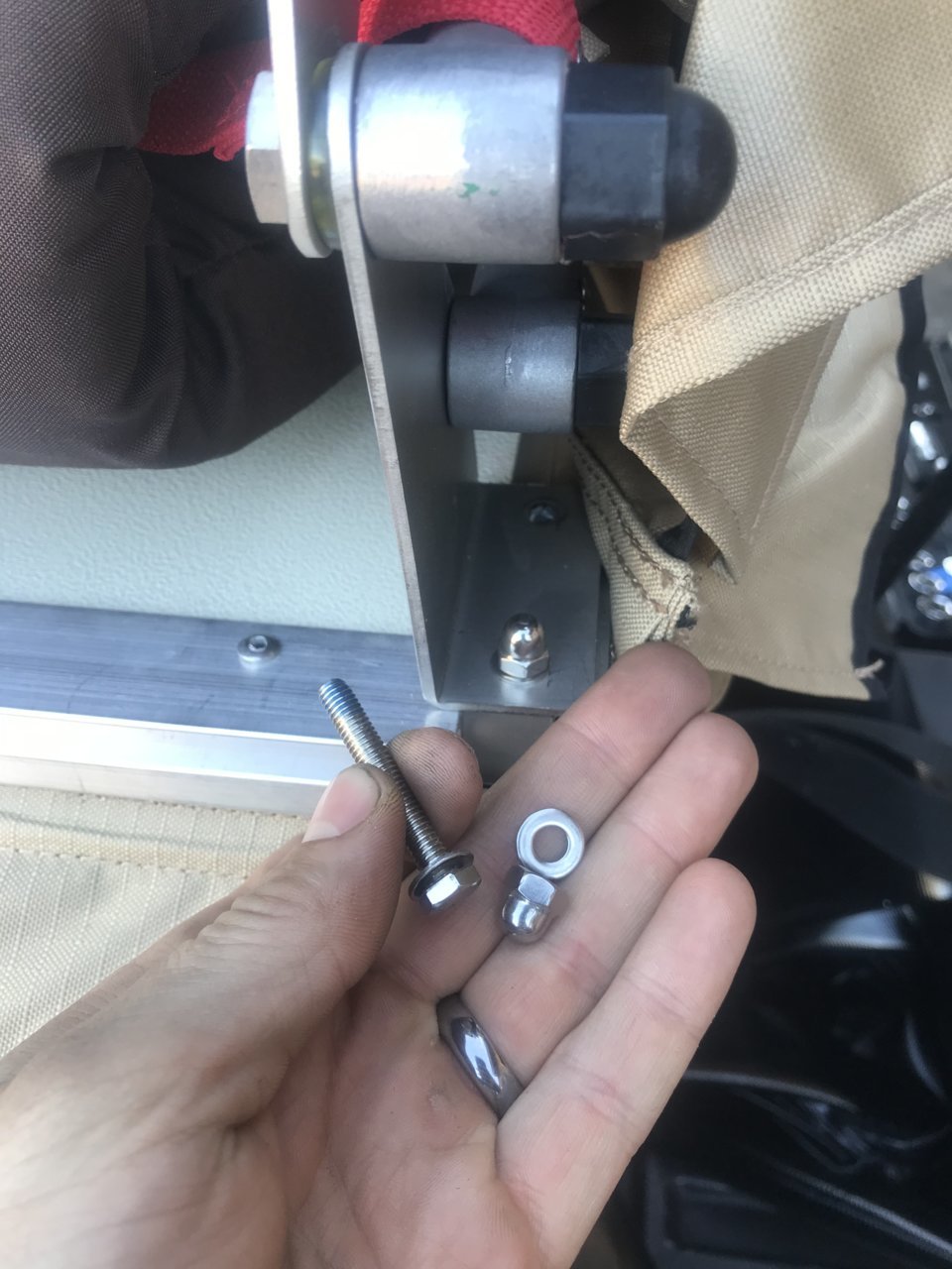

    Just got mine installed, already noticed a few things. Basically all the bolts on it that I didn't install we're finger tight including all 6 of the main bolts that hold the folding mechanism together. I noticed them loose after seeing two nuts and a bolt in the bed of my truck after having the tent on the truck for a day. Also noticed that the rubber stoppers for the ladder do nothing and the screw used to install them is all that's resting on the hard material ontop of the folded tent. In two days it's already worn dents into the material. Gonna have to email smittybilt with photos so they know this has already happened so I don't have any issues warrantying it when the "roof" is completely bent in from the ladder.

    i know its new so its frustrating, but i check my tent bolts every other trip just to make sure. Even my older CVT still backs out from time to time. Nothing catastrophic but still part of the game. Same with the floor where the ladder lands, itll get beat up fast regardless.

    Yeah I'm just surprised they didn't used lock washers or locktite on anything. Im just going to pick up some rubber stick on stoppers to put on the roof to keep it from getting smashed in since the ladder is supposed to be used to open it up and all that leverage is put on the two screws on the roof.

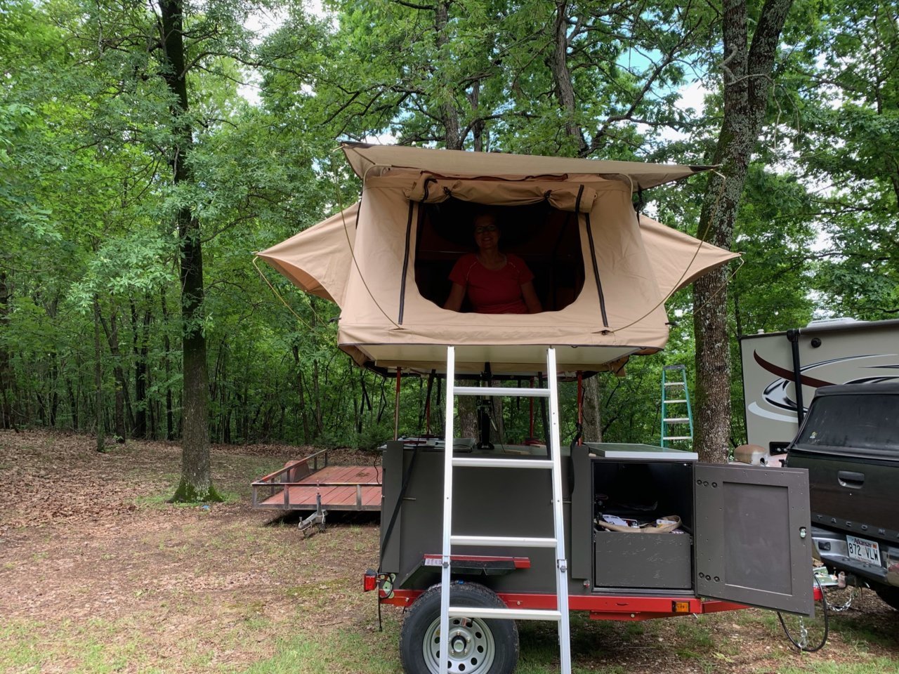

    I built a trailer for my RTT.

    nylock nuts should fix that...
    And for the ladder, a simple aluminum plate there would do wonders, or at least rubber feet on the ladder.

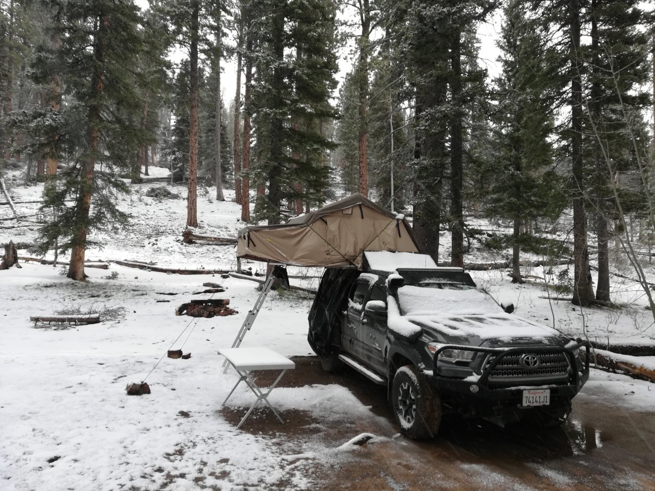

    snow testing in Grand canyon
    nothing happened, a lot of snow after snowstorm
