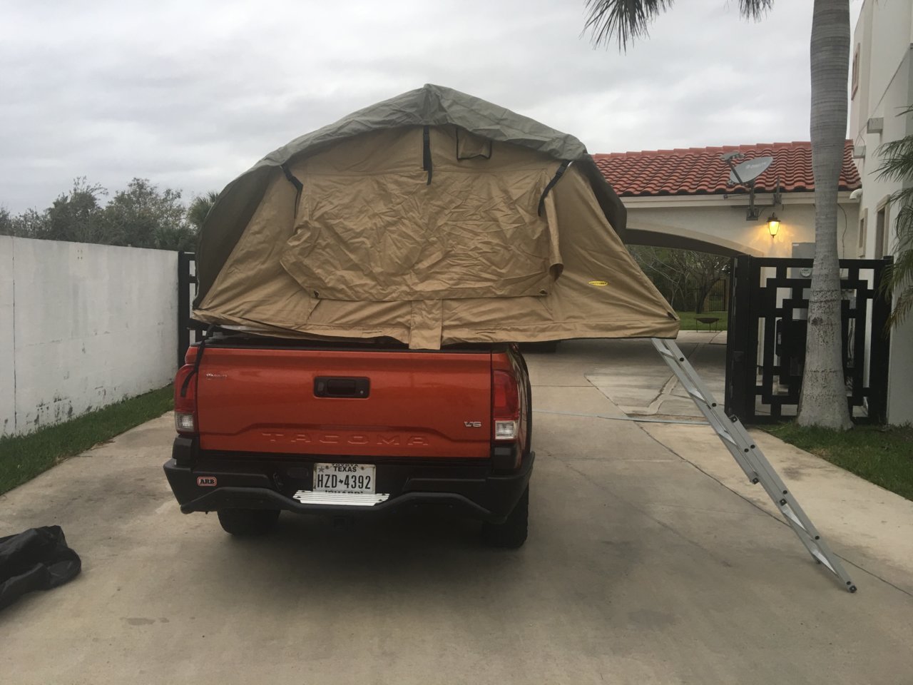

    So I got the tent installed today. Its a smittybilt overlander regular, not the XL. Almost took off to SPI because I really wanna camp in it, but...since half of it just kinda hangs Im not sure if it safe to use just like that. The half that hangs id the half in which Im supposed to climb in through. My gf had no problem getting, but then again she weighs like 100lbs and I weigh 300lbs (down 30lbs, and dropping), so I dont want to snap it in half getting in/out during a camping trip. Should the ladder act as a support or is it just for getting in? Hopefully someone who has one or works at smittybilt can chime in.

    Collapse your ladder to get it straighter. The ladder is used to support that end of the tent.

    Yes, the ladder should be at a slight angle so you need to collapse it more

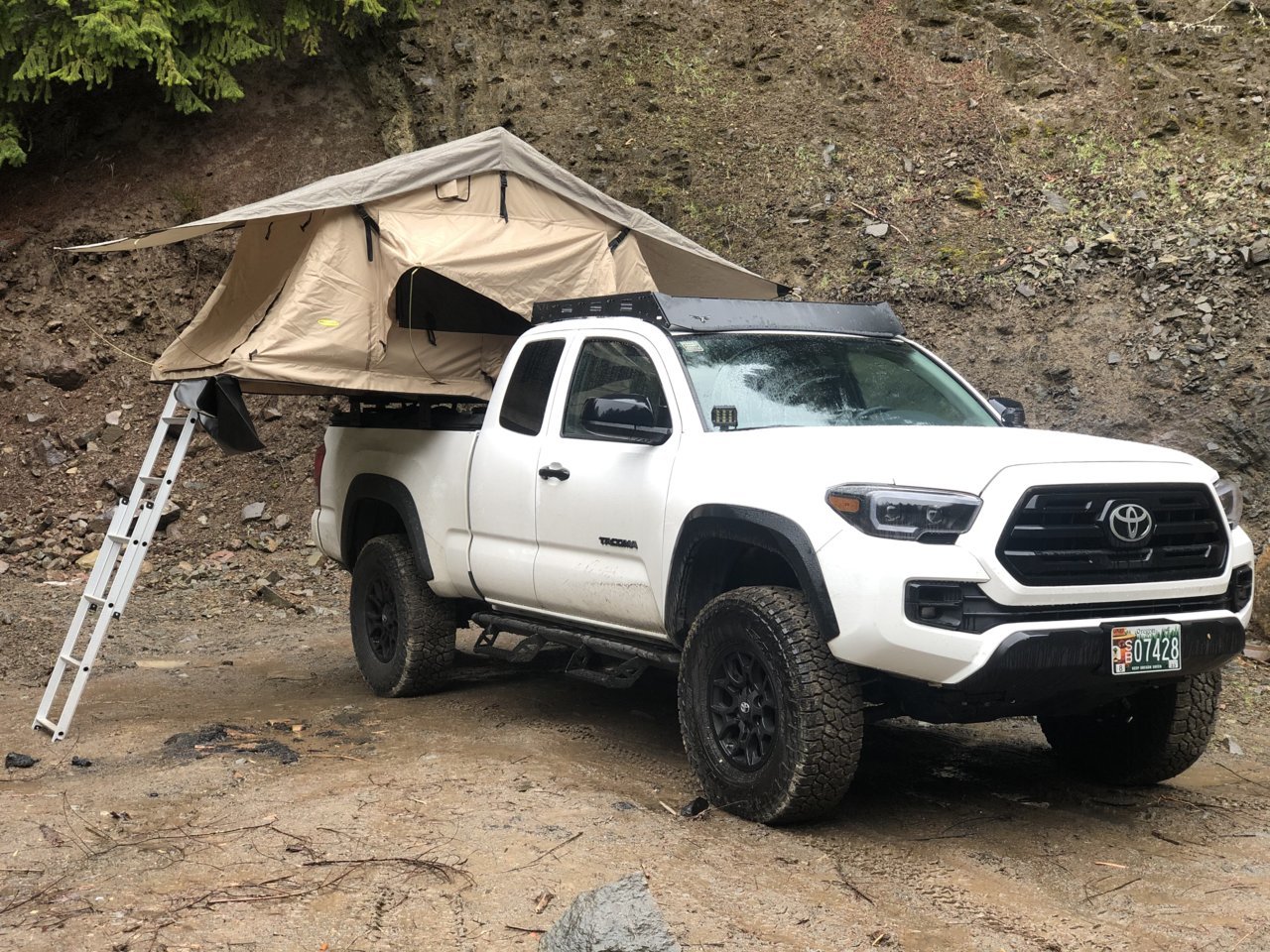

    Yes it’s a support beam, essentially. It should never be at that sharp of an angle. Place it so it’s just slightly less than vertical. From there you can tie a trucker’s hitch from the bottom rung of the ladder to your truck somewhere. It’ll prevent kick-out.
    This is a pretty good angle for the ladder to be at. If you are having a hard time getting both feet to touch then you can use some rocks as shims or level the truck better. You can always drill holes to get a custom length for your bed height.
