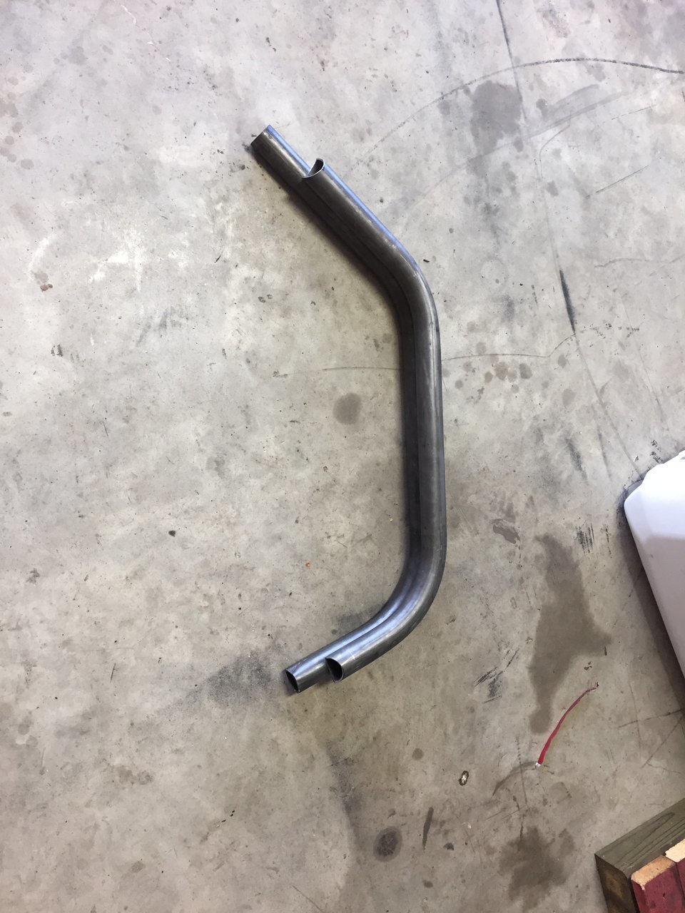

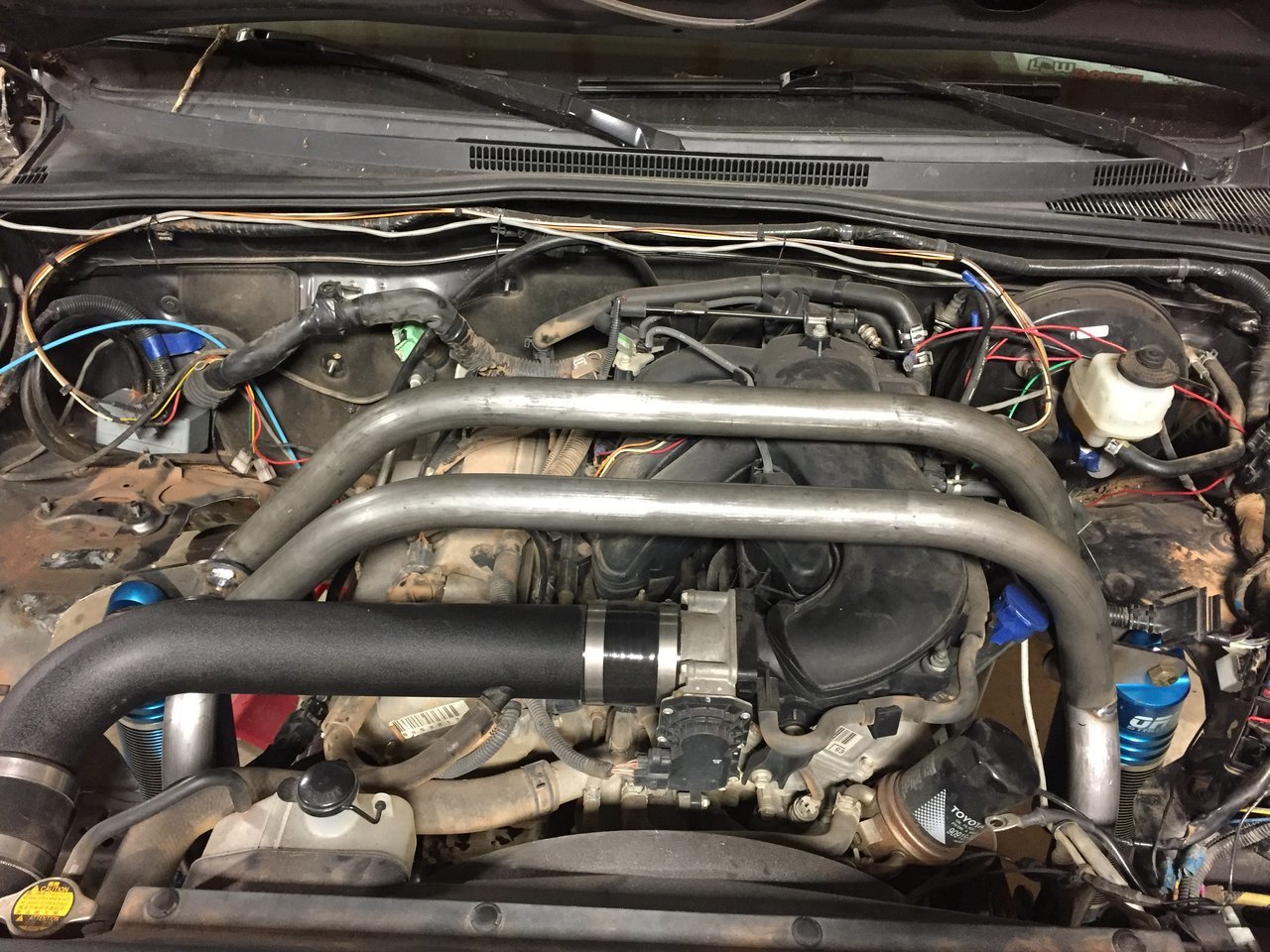

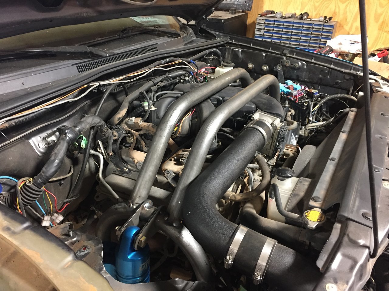

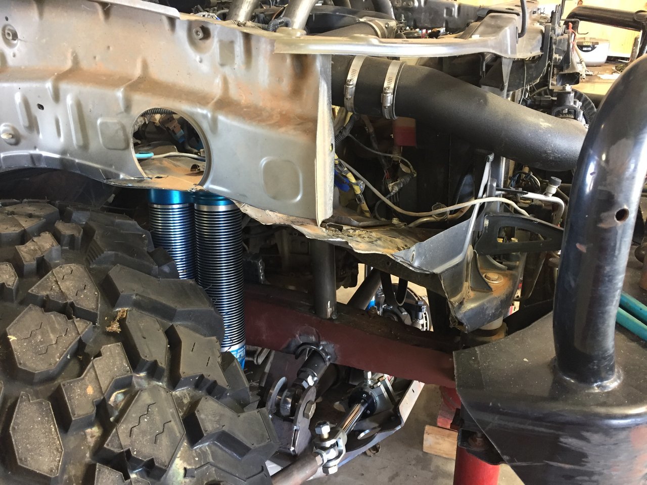

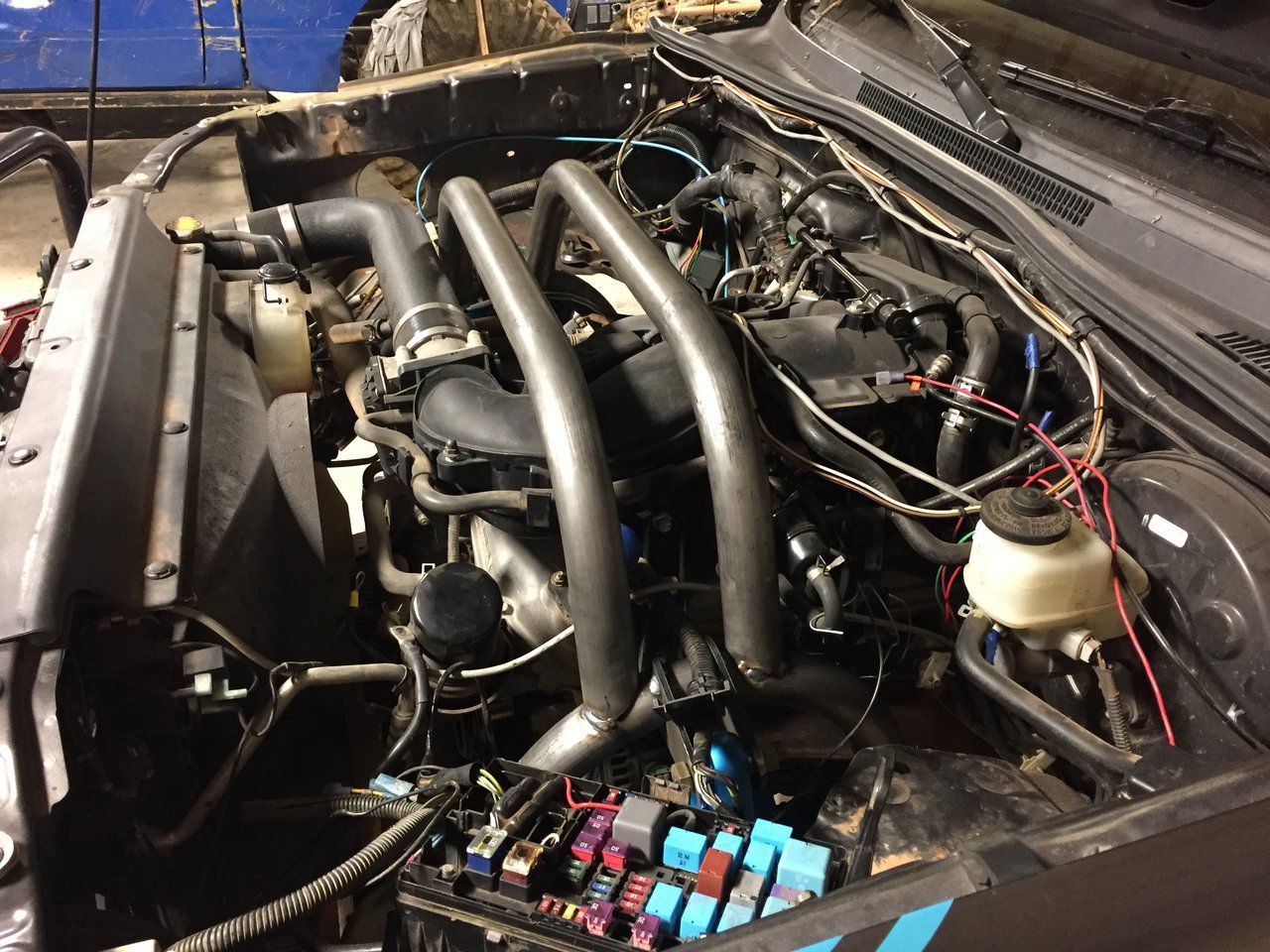

    It took forever to get the second hoop to match the first, but I got it done. And yes they’ll be removable when I’m done.

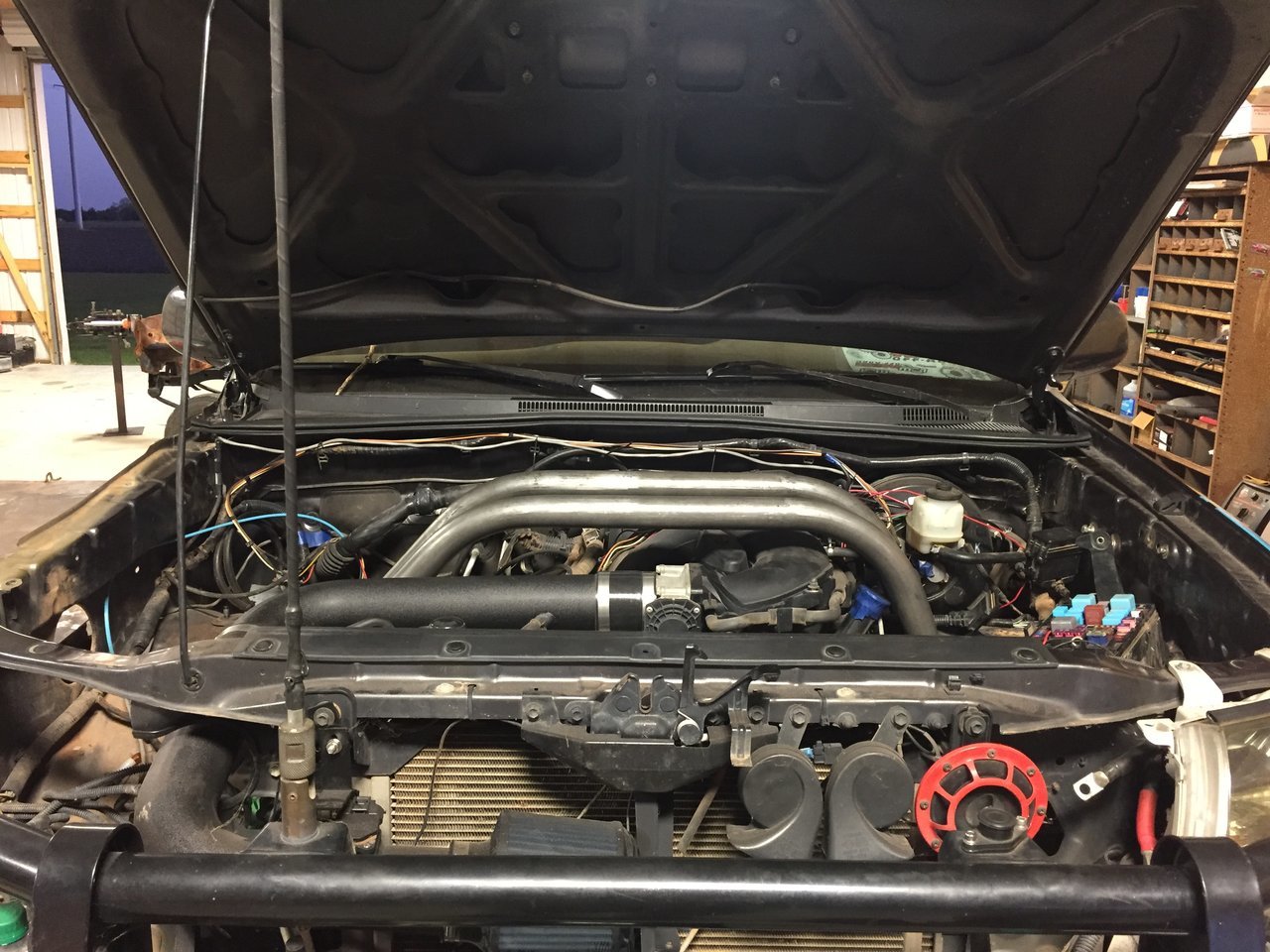

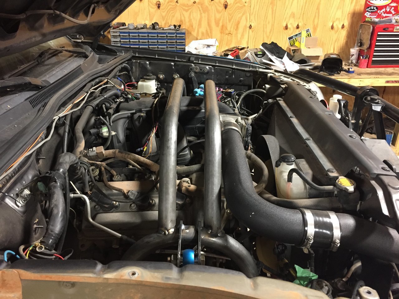

    And thanks @Torspd for the heads up on the different oil filler neck options. I’m going to pick up both the FJ and Tundra neck to see which one works better.

    Swap looks to be coming along nicely. Hope to see it at Jambo 18!

    People tend to get impatient with these builds :D
    Interesting. I think this is the first time I see a double brace like that. I like it a lot.

    This is screaming for some dimple die punched plate boxing to tie them together.

    It sure is. :D

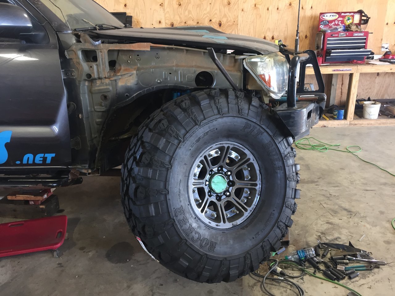

    My fancy wheels are the main driving factor. The backspacing and lower link placement weren't playing nice for one. The tire would hit the link before I reached full extension on the ram. Second, the damned Hutchensons have a slightly smaller bore diameter than the hub on the axle. That was a fun one to find out.
    All of that stems from me buying parts before I had the axle or knew what I was doing. :D It was cheaper to buy the quality hub and wheel centric spacers than buy new wheels.
    I'm also running a spacer on the rear to keep from having to notch the frame for the shocks.

    What thread is that? I had to shave down my Oil fill cap BC of the supercharger

    There isn't a thread that I know of, I just called him. :D
    I ordered the Tundra version and should have it on Tuesday to try out.

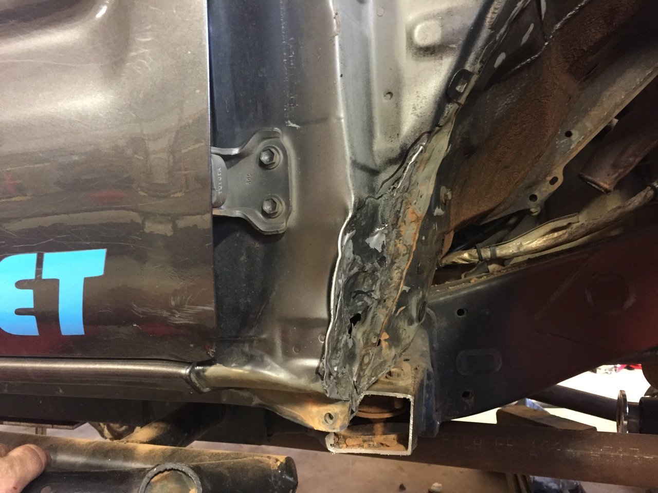

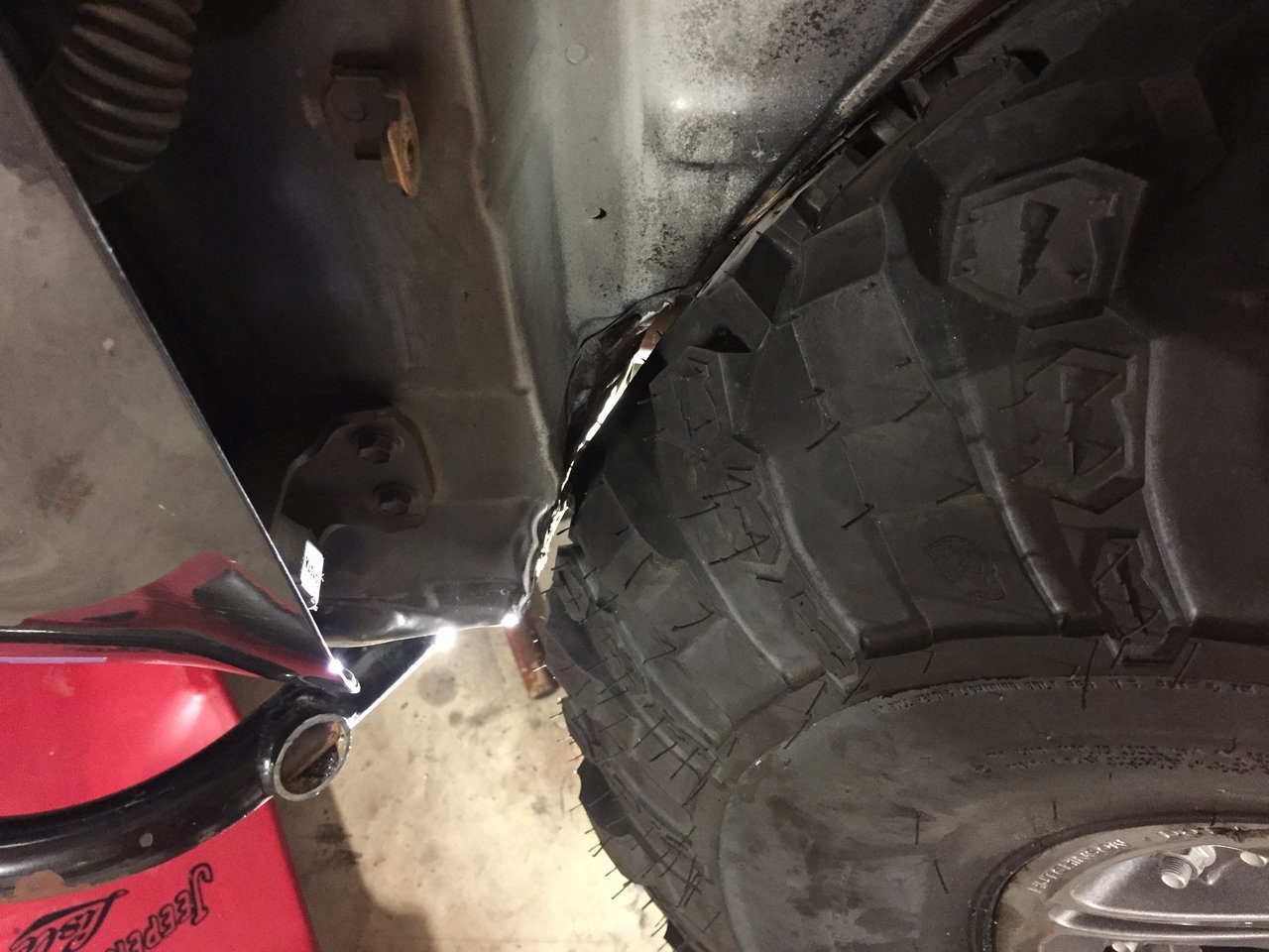

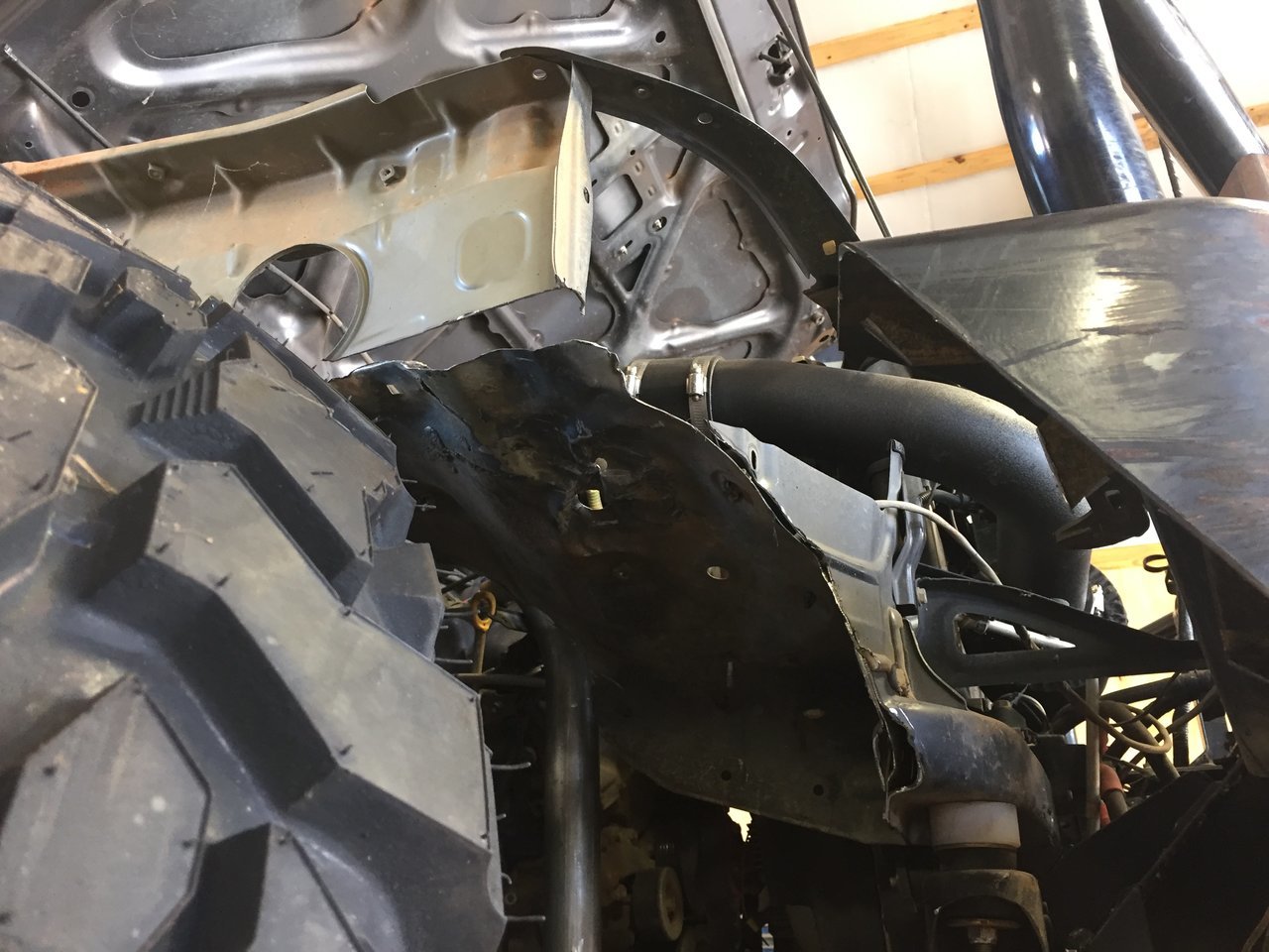

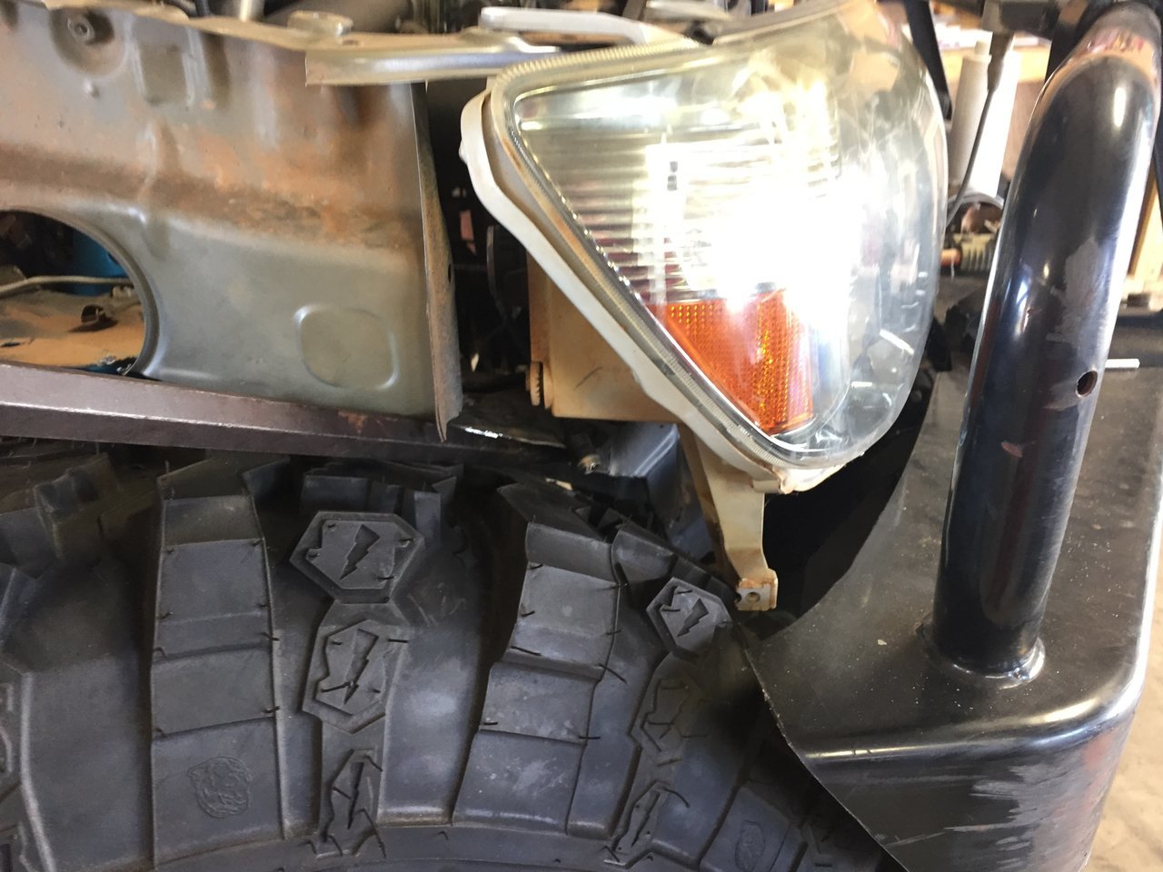

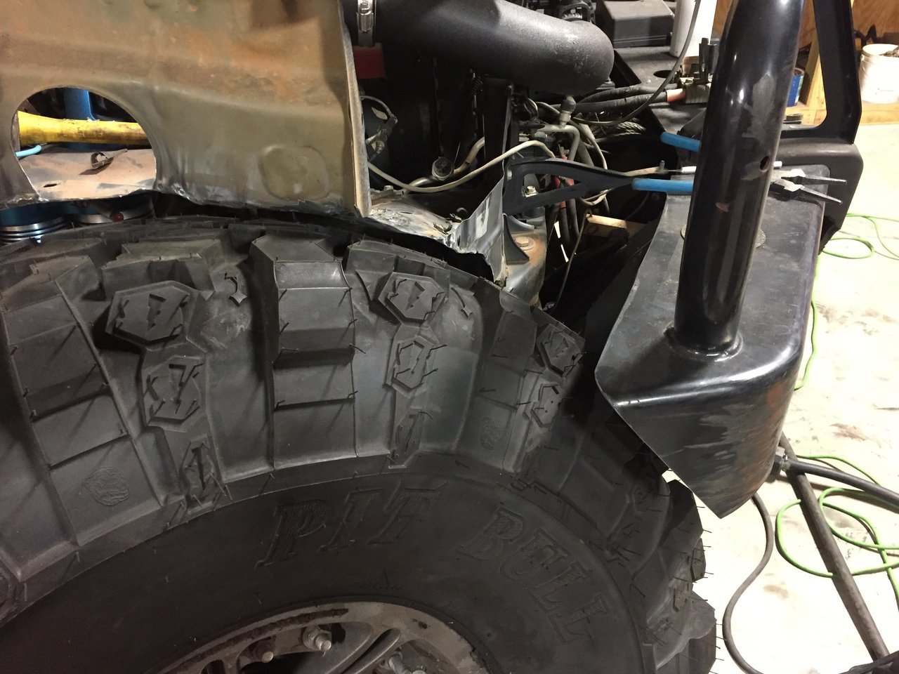

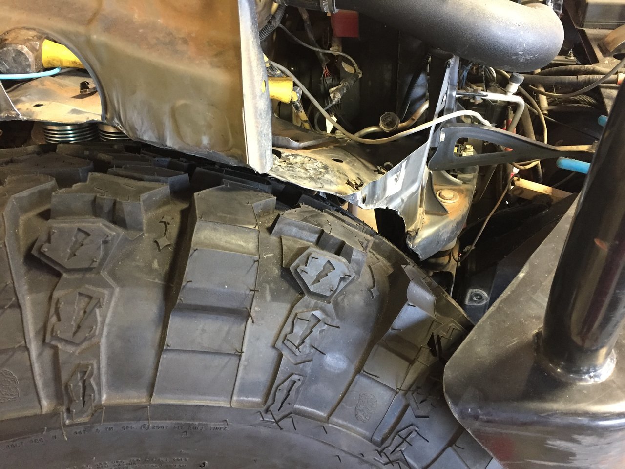

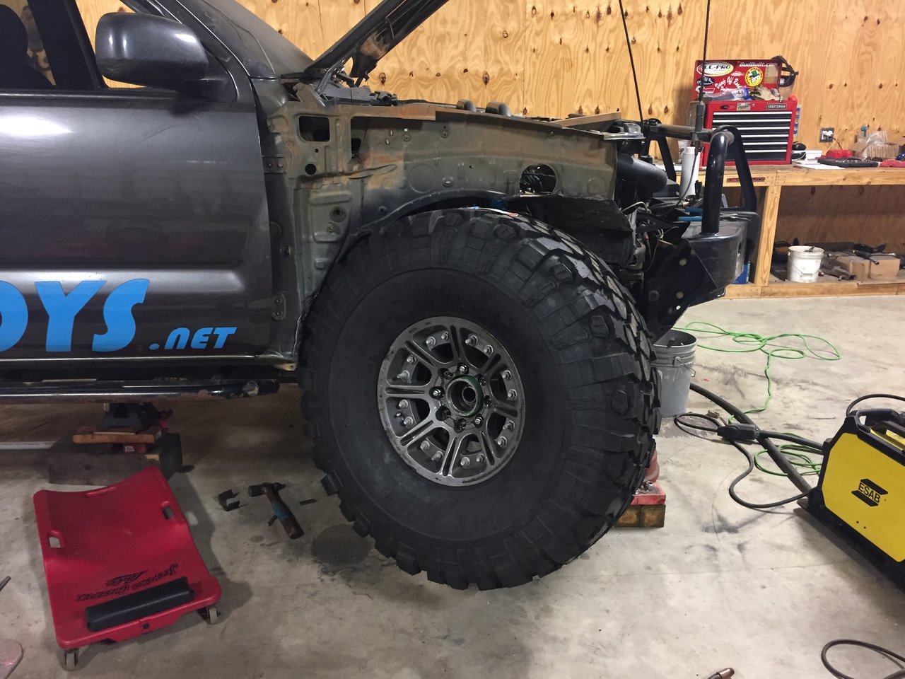

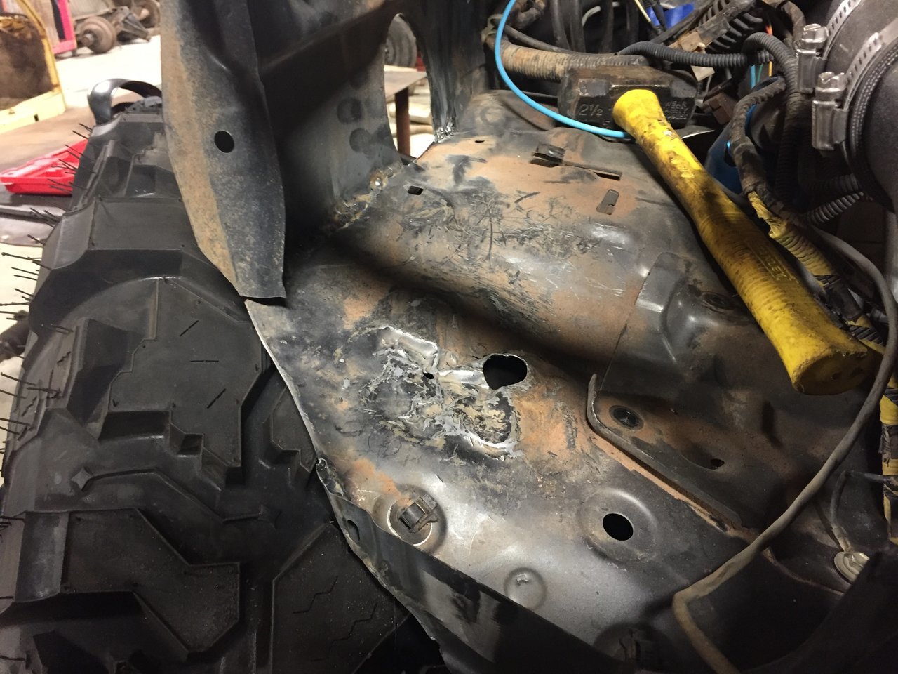

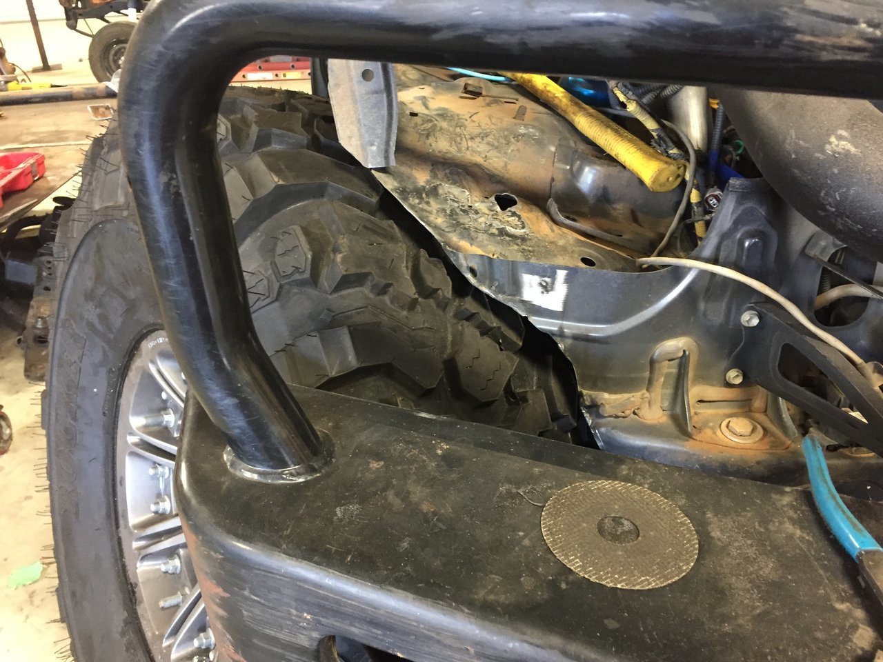

    I trimmed, sliced, welded, and beat my way into the passenger side tire clearing lock to lock at full stuff.
    Photo Dec 02, 2 17 45 PM.jpg Photo Dec 02, 5 45 35 PM.jpg Photo Dec 02, 2 20 08 PM.jpg Photo Dec 02, 2 20 12 PM.jpg Photo Dec 02, 2 27 09 PM.jpg Photo Dec 02, 2 30 13 PM.jpg Photo Dec 02, 4 15 36 PM.jpg
    All welded up. I'll have to make a new lower bracket for the fender and headlight, but they'll both still fit.
    I beat the shit out of the firewall, but didn't have to trim anything. I might have to bring the bigger hammer out to move it a bit further back.

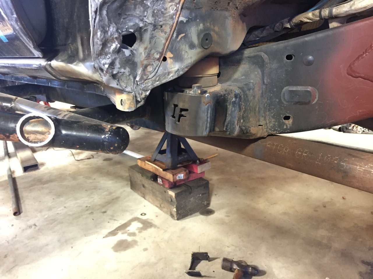

    With the axle moved forward I didn't need to relocate the body mount, but I did add a body mount chop plate from Insane Fab. The bull nose plate works out pretty damn nice.
