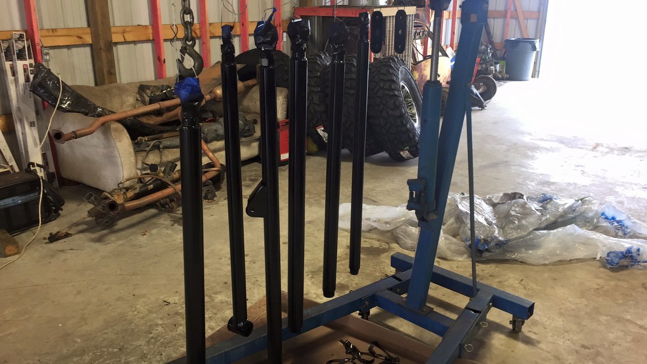

    Let's see, today was a whole lot of little stuff. All of the links are welded and painted, both cab mounts are welded in and painted, and both firewall tubs are welded and seam sealed.
    Welding bungs has lead to a couple of the heims seizing in the bung, which sucks! I did a little digging and read up on how folks go about it. The "best" method is to weld the bung in without the heim in place and then run a tap through the bung once everything has cooled. That's all fine and dandy, but I would have to buy several right and left hand taps and that just wasn't going to happen. So the next best thing is to slather anti seize on the heim and go to town. That seemed logical so I gave it a shot. It worked, but I still had one failure on a bung, thankfully one that didn't really matter. So the new tactic that I developed today was to apply copious amounts of anti seize to the bung and heim and then start welding. Instead of laying the three or four beads to get around the bung all at once I stopped after each bead and made sure the heim was still free. Twice I hit a snag after a bead where the heim didn't want to turn, but after applying a little torque with a screwdriver it came free. I then reapplied anti seize and laid the next bead. I had one heim that got stuck on two different beads, but by breaking it free after each stuck it ended up free and clear at the end. So take that for what it's worth. Hopefully that will help someone keep from ruining a heim.
    Here's the one and only pic I took today. lol
    Oh, and tomorrow should be interesting. My orbital column showed up today. :D

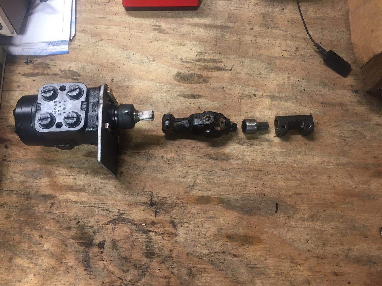

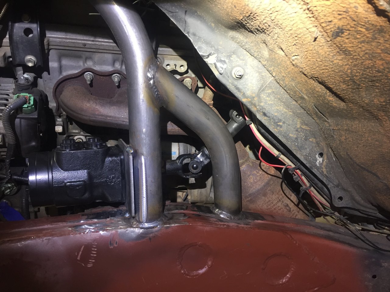

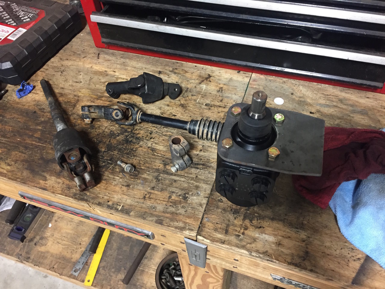

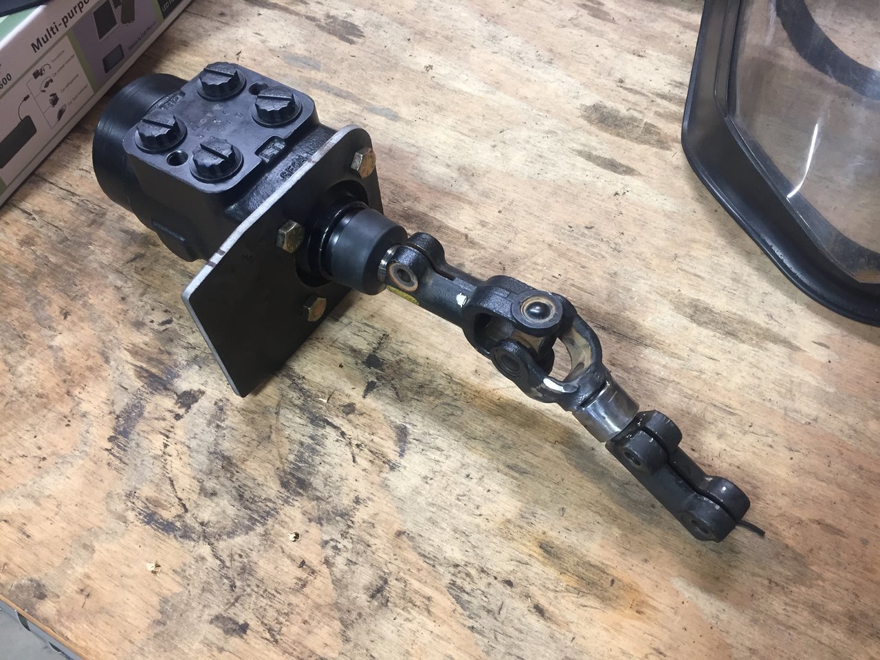

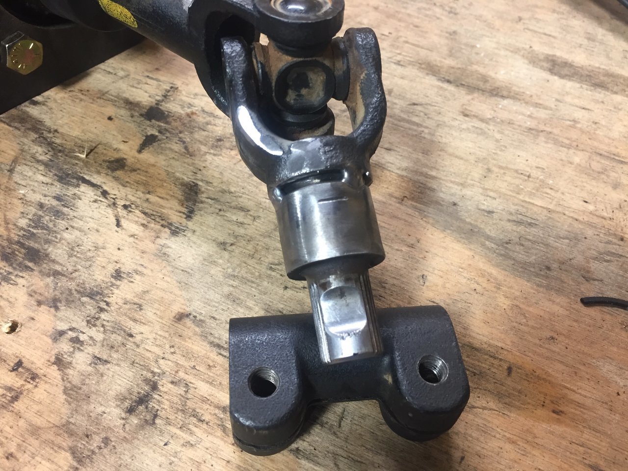

    The orbital now has a home in the engine bay, well kinda in the engine bay. :D
    This is the pile of parts I started with. The joint and shaft with a bell on it are out of the donor Lexus, but I ended up not using them. The stock shaft from the taco ended up working beautifully, albeit a tad shorter. The stock shaft is the one with the collapsible bellows on it. That was quickly cut off.
    That long shaft ended up as just the ujoint and the spline from the other end. Here's what the whole system will consist of.
    And here's where she's going to live. This position was the best bet, though pulling the accessories will be interesting when the time comes. I'll be building in extra length to the hoses so I can just pull the orbital out of the way for maintenance.
    Photo Dec 31, 2 23 19 PM.jpg Photo Dec 31, 2 23 39 PM.jpg Photo Dec 31, 2 23 49 PM.jpg

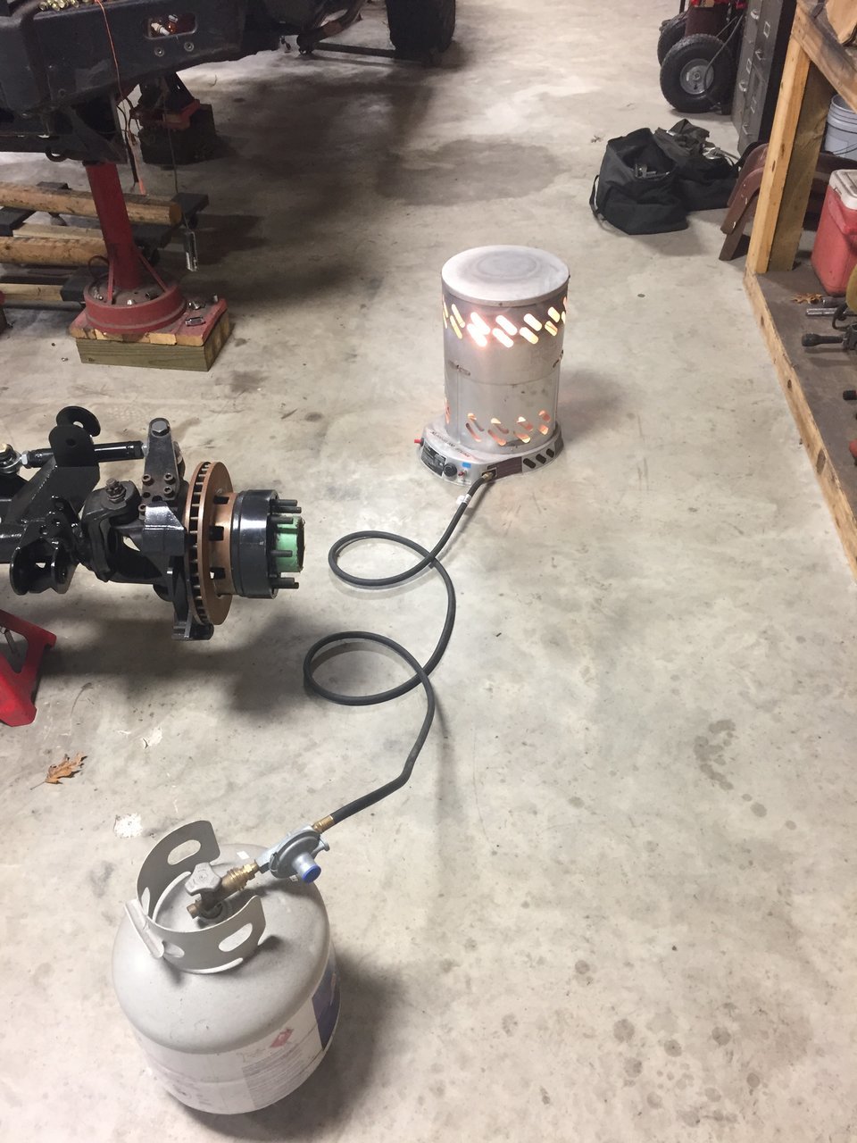

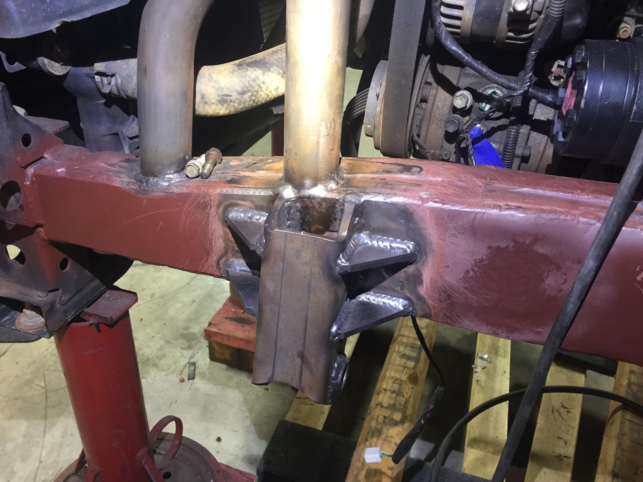

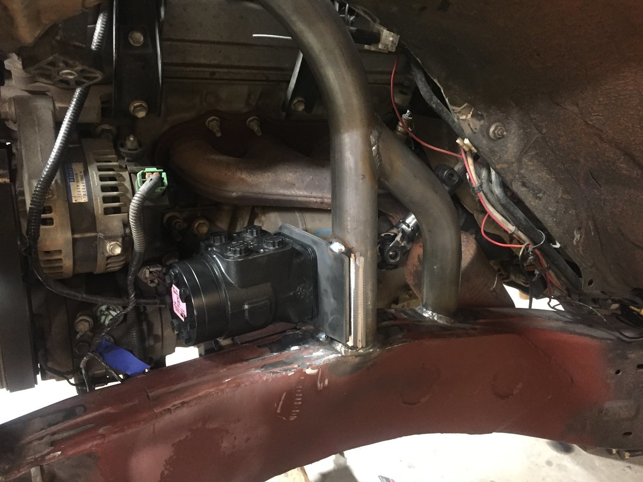

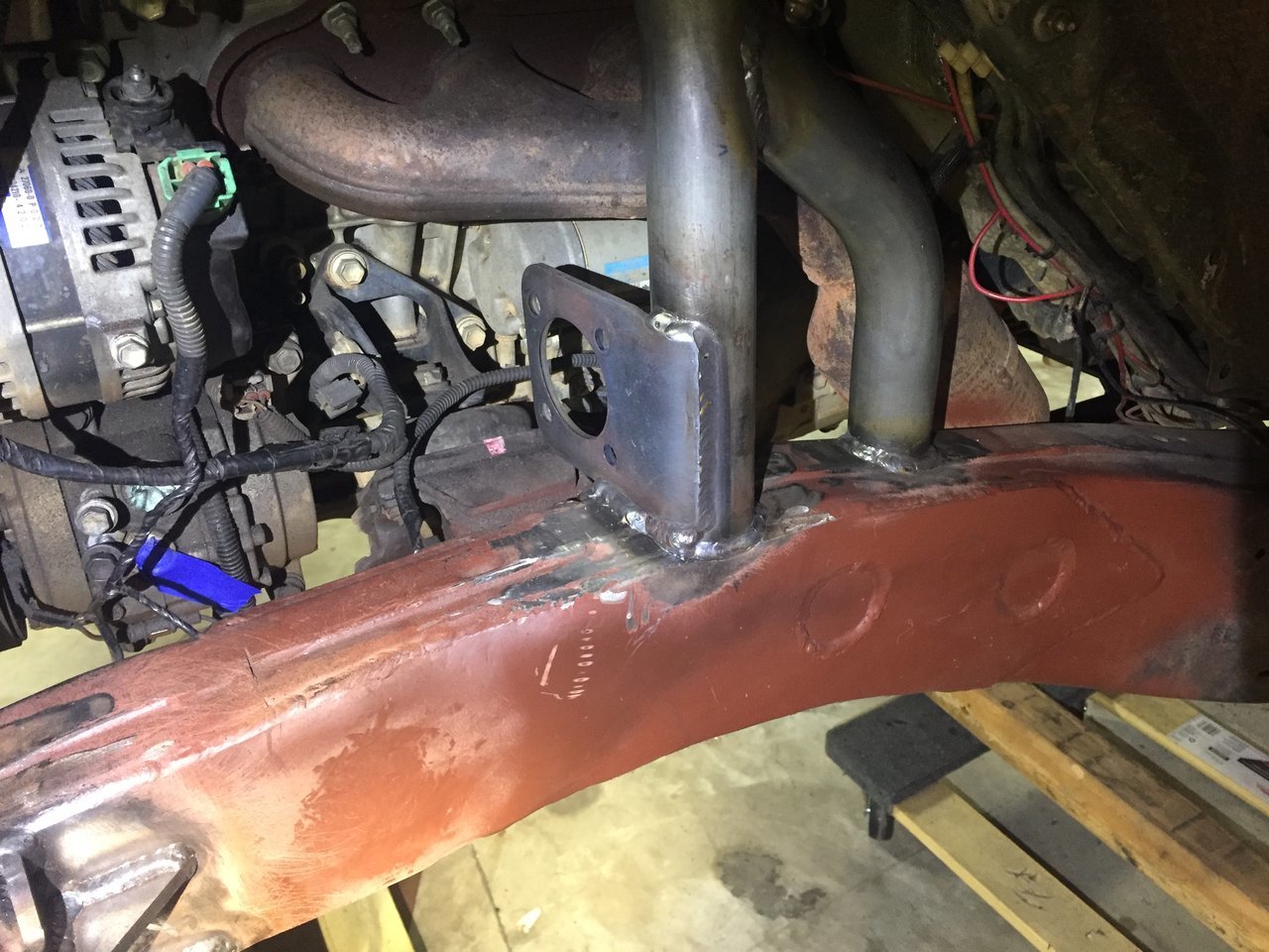

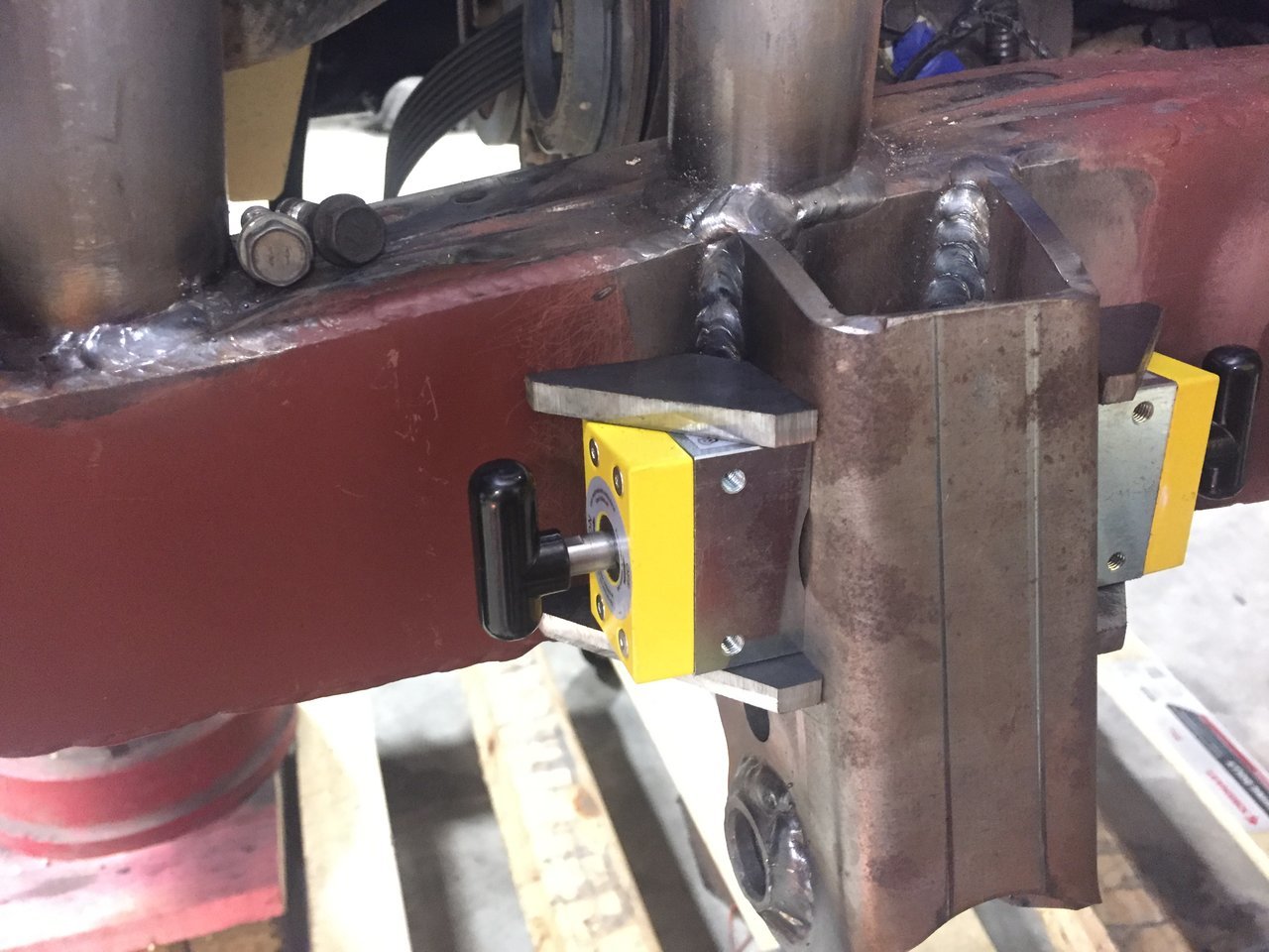

    I finished the panhard and orbital mounts today. I'll paint the driver side hoop tomorrow and get the engine cross member back in.
    I also swapped the brakes on the 14 bolt to the front of the axle to allow me to mount the shock mounts on the rear of the axle tube. I'm now an expert on taking the axle shafts out of the 14 bolt.
    Thanks for letting me borrow your heater @greeneggsnspam. That was a lifesaver today.
    Thanks @TXSmiley for the switchable magnets!
    Photo Jan 03, 1 37 41 PM.jpg Photo Jan 03, 2 09 58 PM.jpg Photo Jan 03, 7 45 28 PM.jpg
