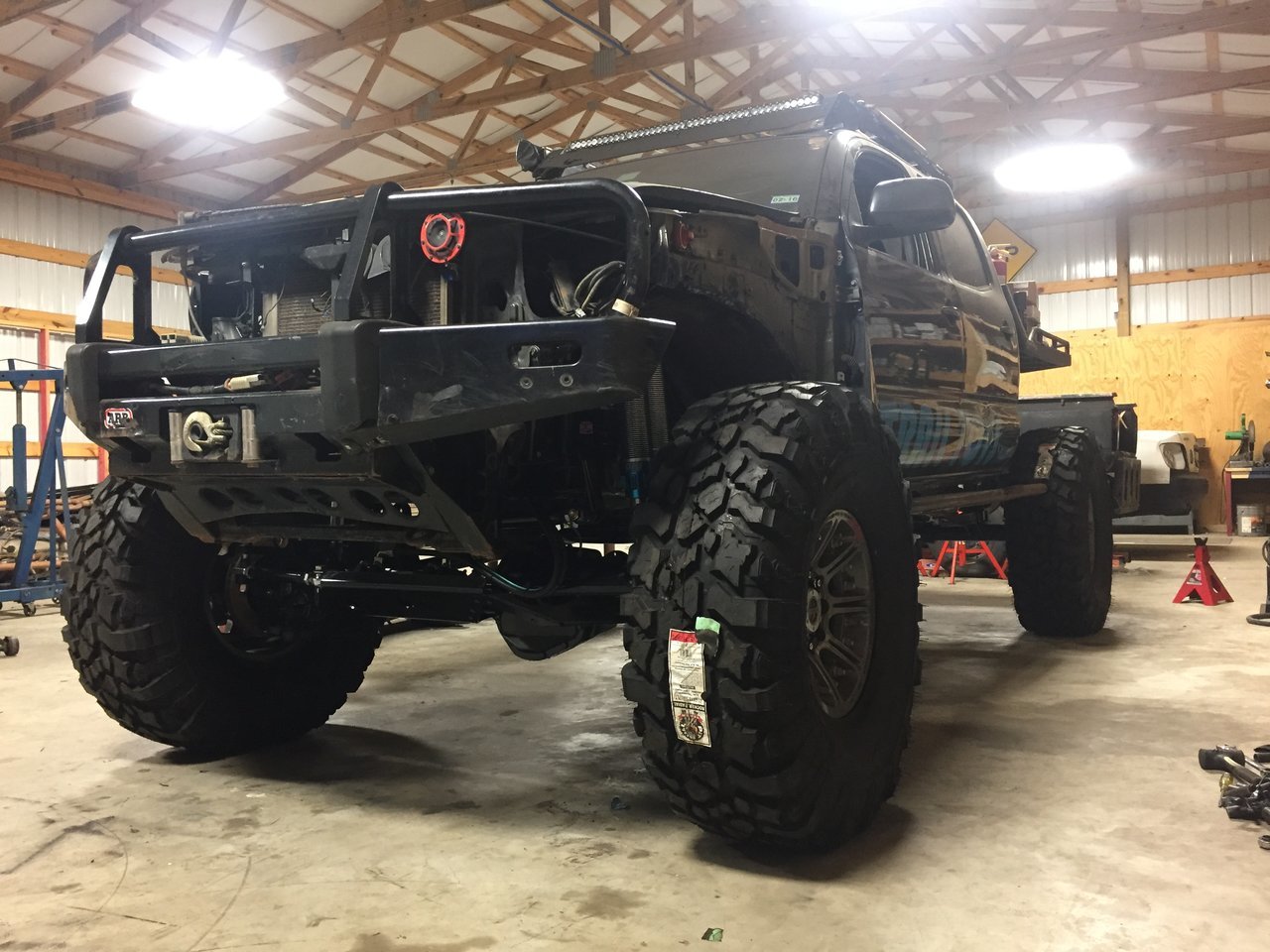

    Major milestone alert! She's officially off of the jackstands!
    Items accomplished yesterday:
    1. Welded 14bolt tubes
    2. Welded rear leaf mounts
    3. Fabbed and installed bump stops
    4. Painted 14 bolt
    5. Filled and bled ps system, that sucked
    6. Wired winch
    7. Installed ORI's
    8. Charged ORI's
    9. Removed JACKSTANDS!
    Photo Jan 10, 10 15 54 PM.jpg Photo Jan 10, 10 17 17 PM.jpg Photo Jan 10, 10 17 02 PM.jpg Photo Jan 10, 10 19 55 PM.jpg

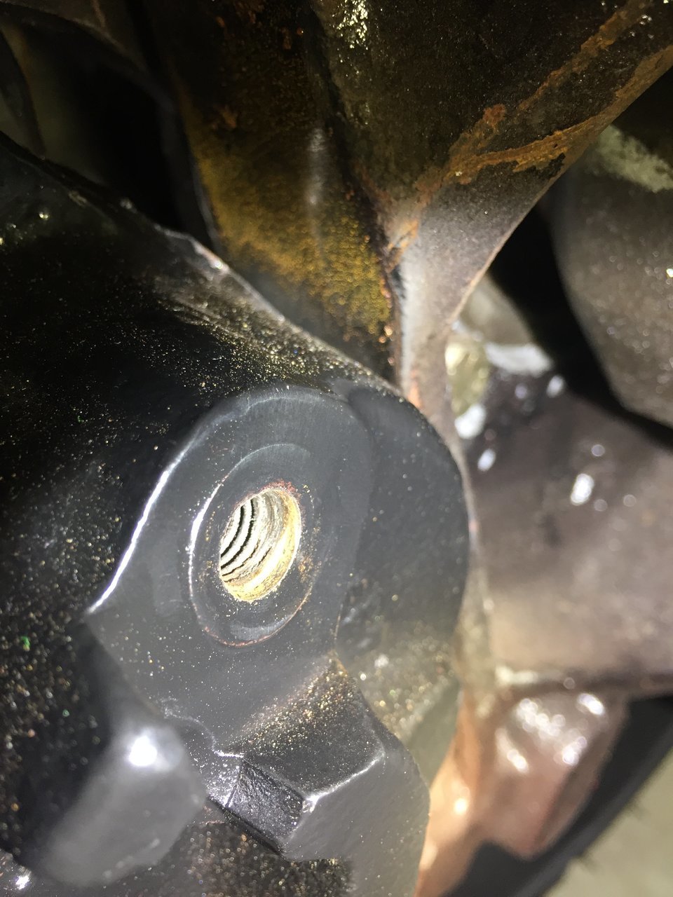

    I found two nice snags yesterday. The first was the pinion seal not sealing around the pinion flange. It's real fun when all your diff fluid comes running out the front of the housing. So that had me a bit bummed yesterday, but I found the solution. The older 14 bolts have a smaller diameter shaft, so the seal is smaller. I picked up a new seal and will get it installed tomorrow. That should solve the issue.

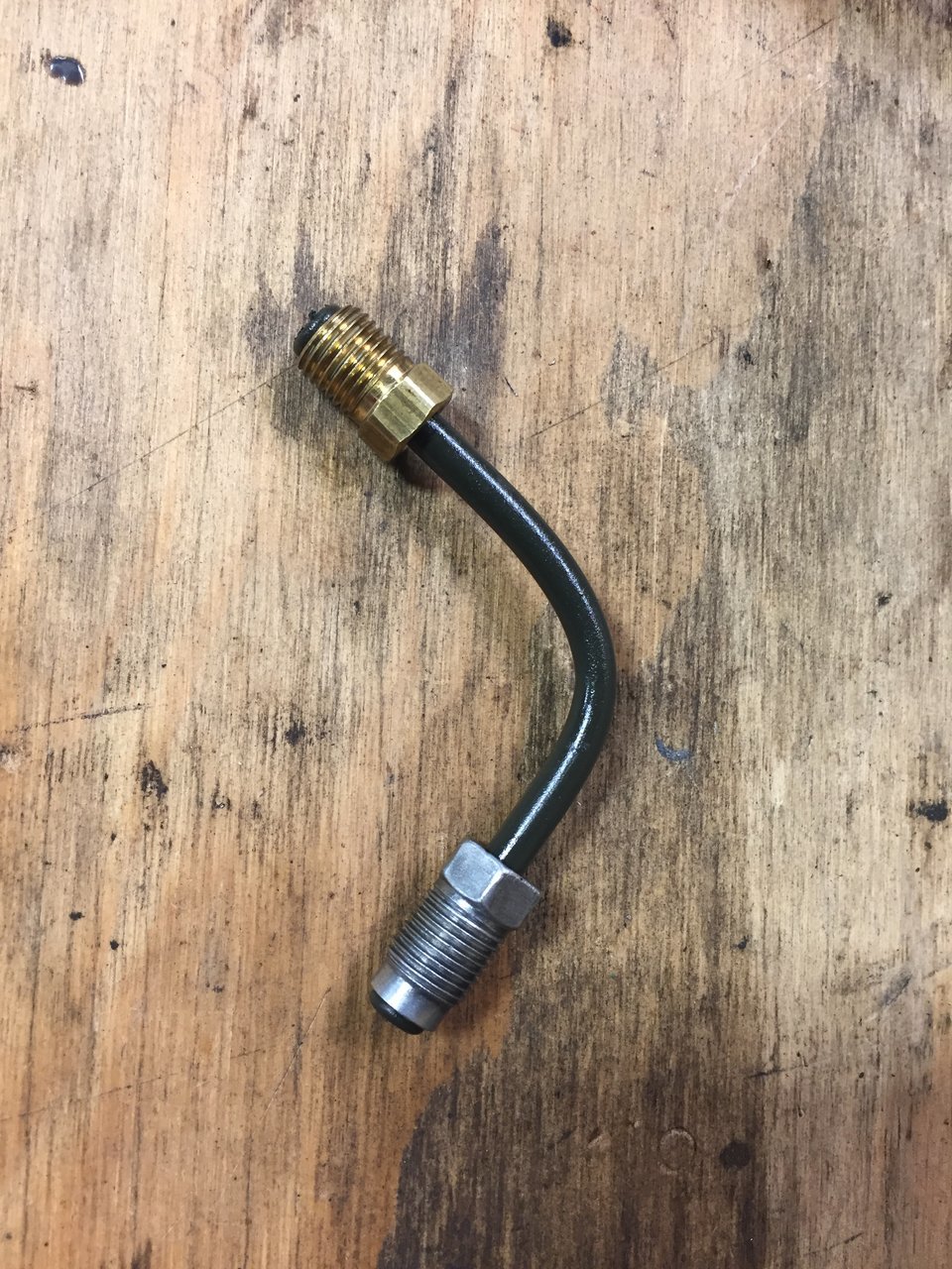

    The second issue was the threads for the banjo bolt on the driver side front caliper being stripped. That was the first time I had pulled the plug so i didn't do it. I'm going to take my tap and die set out to the shop tomorrow and hope I have the right tap. Otherwise I'll put a new caliper on.

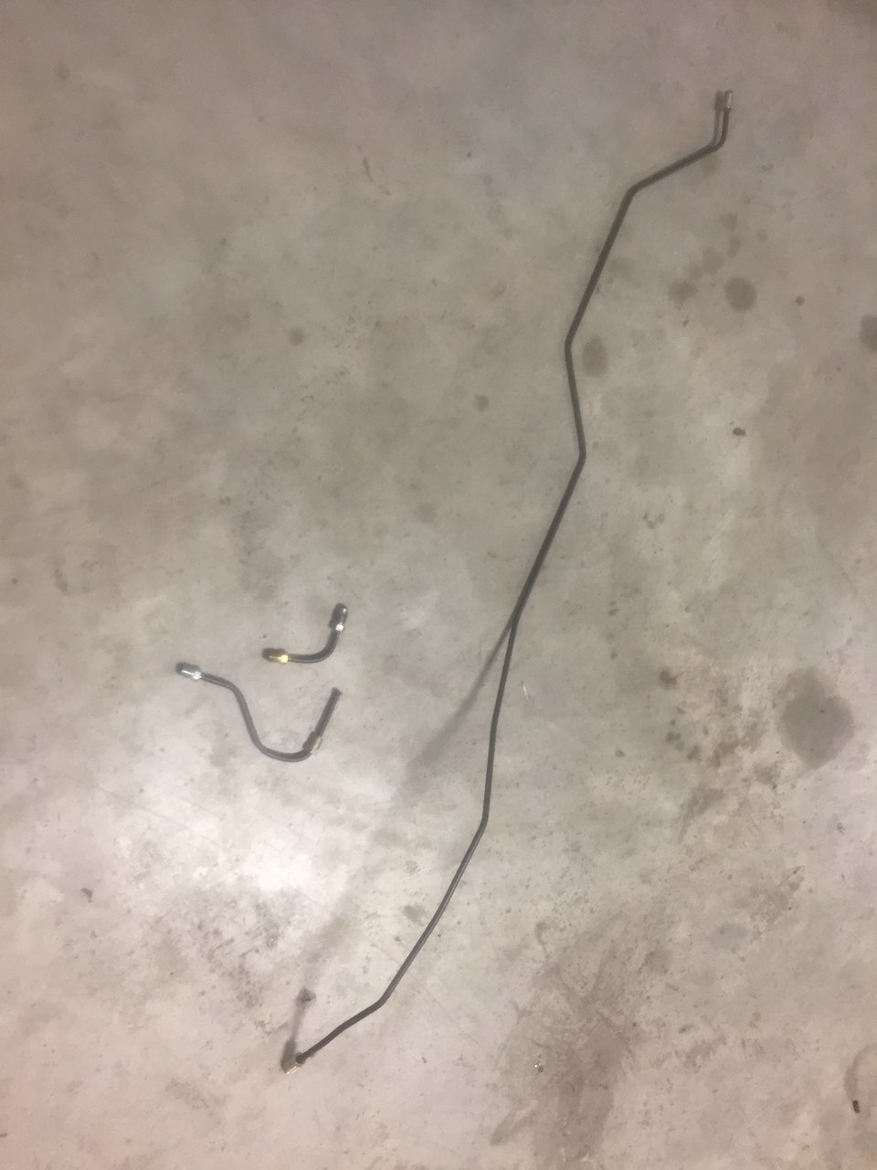

    I did manage to run the new hard lines for the front brakes though. That was the first time I've flared or bent a brake line. I'll get some pics of the new line installed tomorrow.
    The frankenstein mishmash of standard and metric fittings is laughable, but it should work. Here's the adapter from M10x1 to 3/8-24 I made up.

    the buggered threads

    Here are the lines that will live on the 60. I don't have a pic of the line from the master to the soft line, but I'll get one.

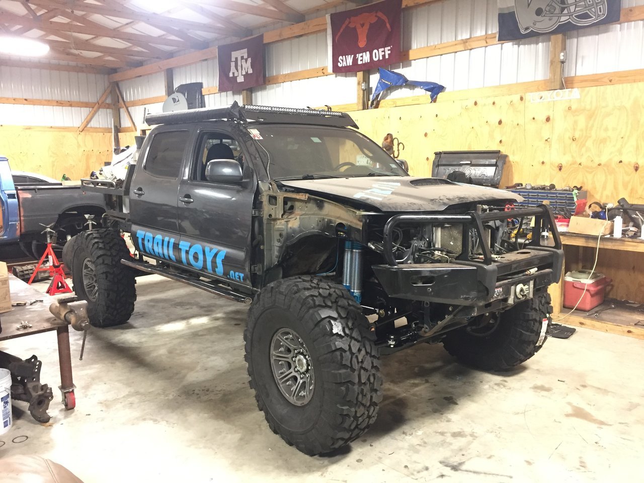

    The super poorly fitting Rock Auto fenders are on the truck and the headlights are back on. She's getting closer.
