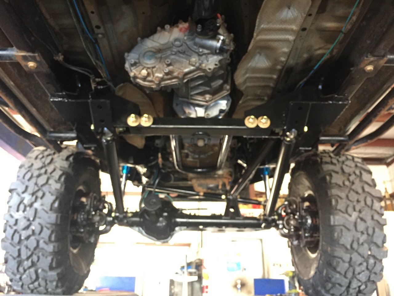

    I loaded up the taco and drug her into town for a bit of work. The exhaust shop I've used twice before for Smokey did a great job at stuffing the exhaust in there. She's still a little louder than I want, but I'm out of room for more muffler. After the exhaust I had the ac lines I had to remove remade where they wouldn't interfere with the suspension or get chopped up by the fan.
    After all of that I headed out to @Torspd 's place. Turns out he had the exact booster and mc I was looking for, one out of a 5.7L Tundra. I'm going to do my damndest to get that sucker installed tomorrow. Thanks buddy!
    Photo Jan 15, 9 40 45 AM.jpg Photo Jan 15, 11 51 10 AM.jpg Photo Jan 15, 12 47 07 PM.jpg
