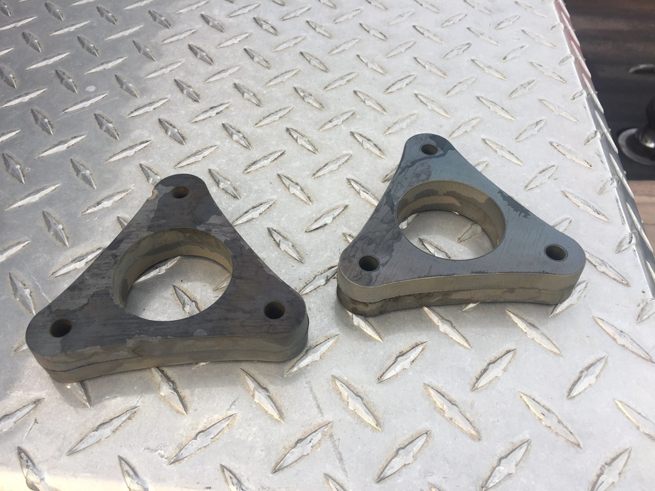

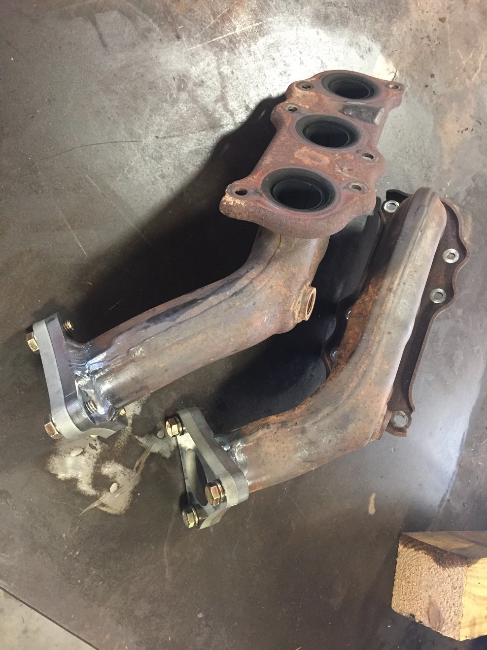

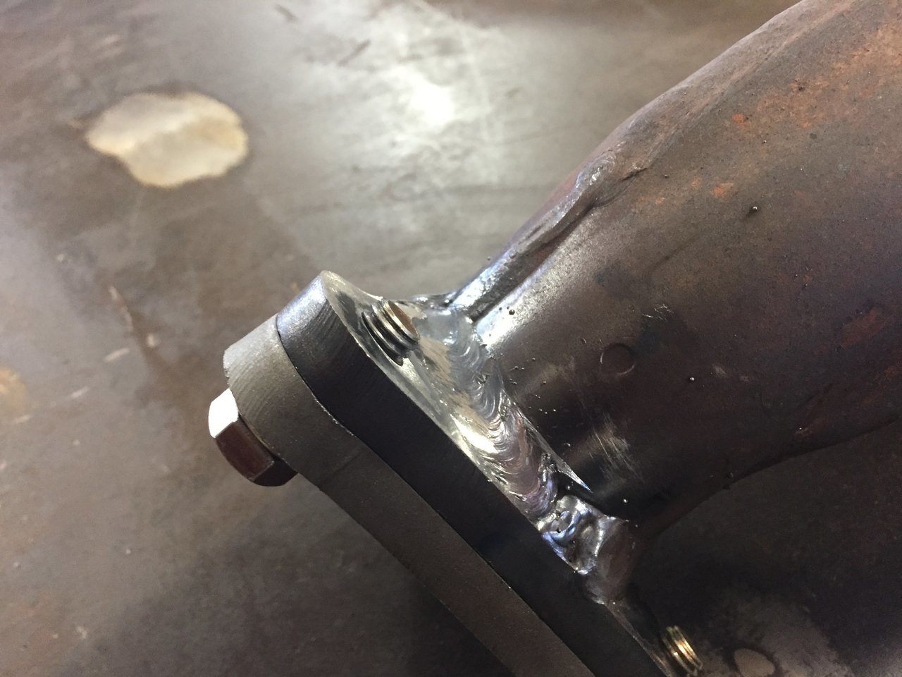

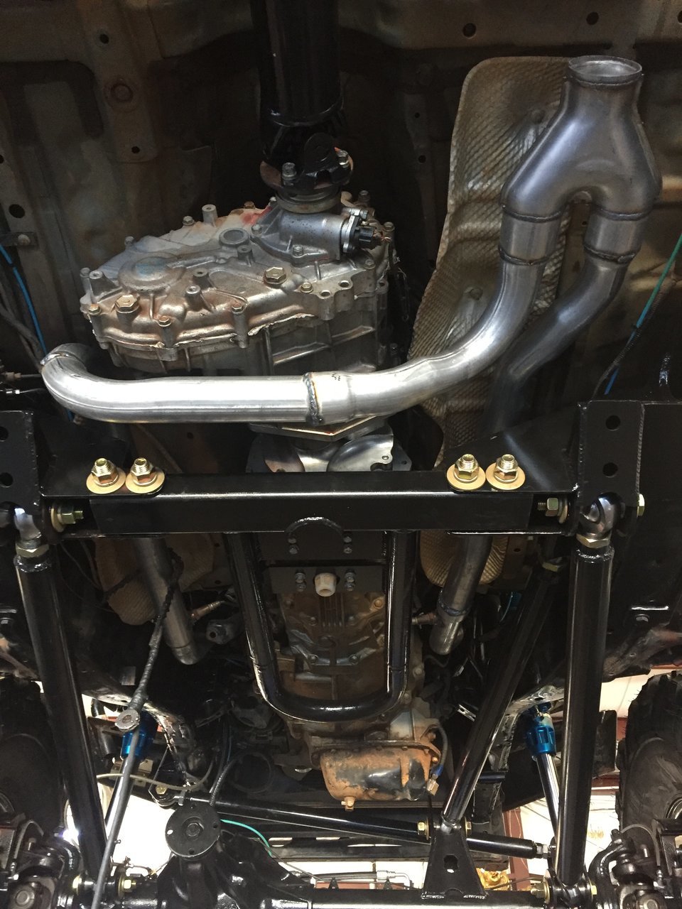

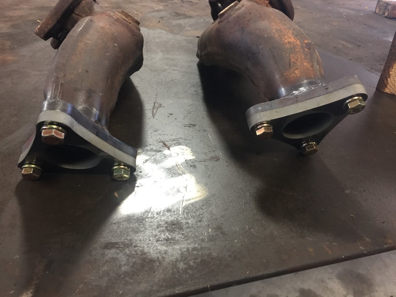

    Stock headers with custom flanges welded on where the cats used to be. I thought I had uploaded these pics here, maybe not.

    I know you had the flanges made and I could have missed the pictures. When I swap I’ll just go to headers

    If you guys ever need flanges and don't have access to laser cutting equipment, I have access to a flange database of 1500+ parts and can normally get you a part number

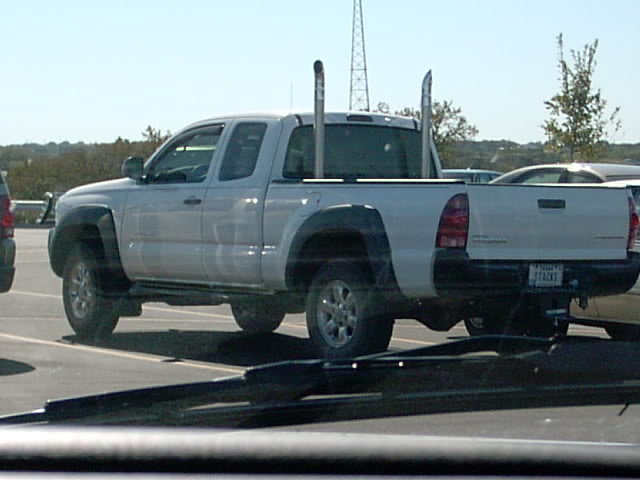

    2014 DCSB Tacoma TRD OR
    Should have ran a stack... would have been cooler.

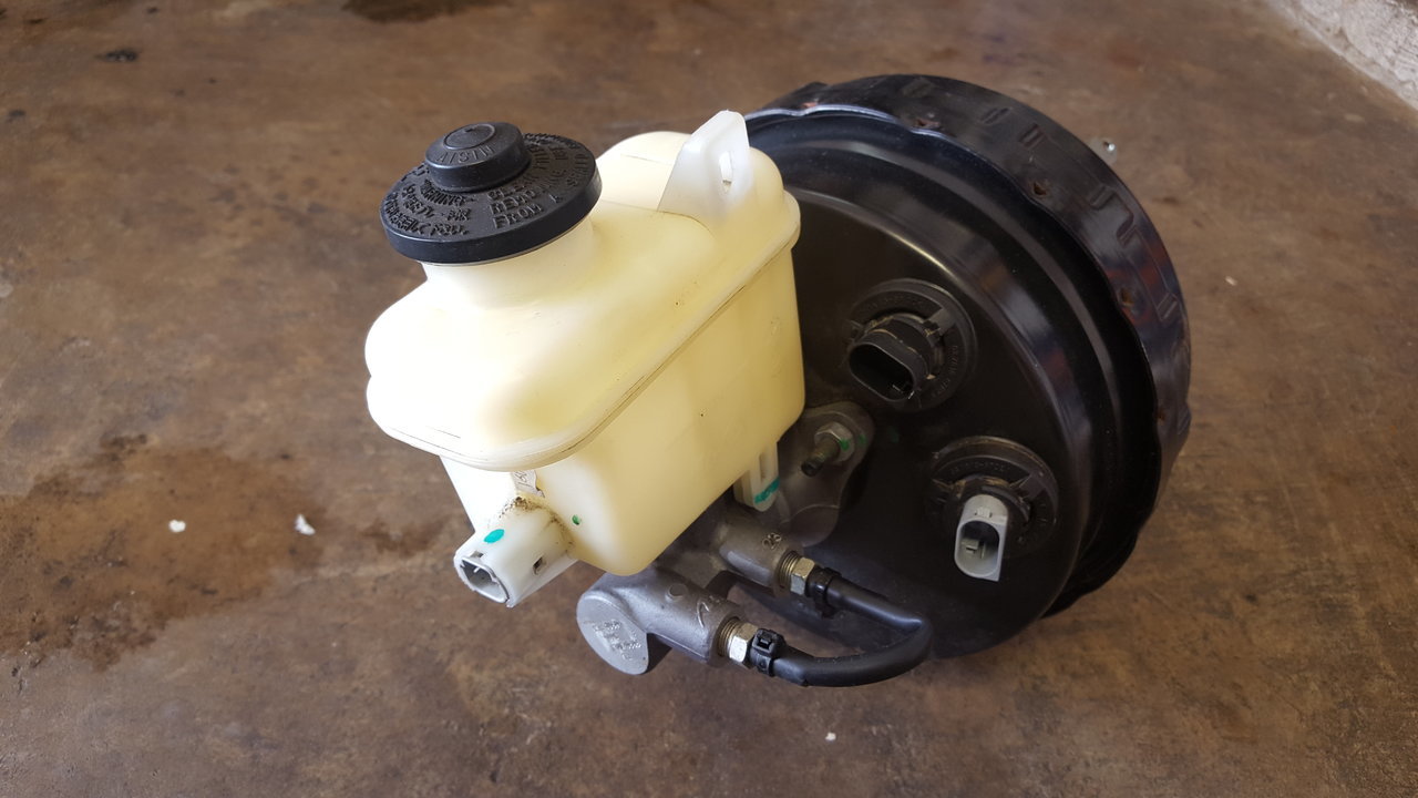

    Exactly. I was at my buddies professional auto shop last night and bled the brakes again to no avail. The MC has to be bad or undersized, so I'm going to fix that problem. The single lines leading from the MC and hitting a T at the axles is exceedingly common, so that's not it.

    Thanks again for the mc and booster @Torspd. I'm waiting on some overnight parts from Japan and then I'll be ready to get this sucker installed!

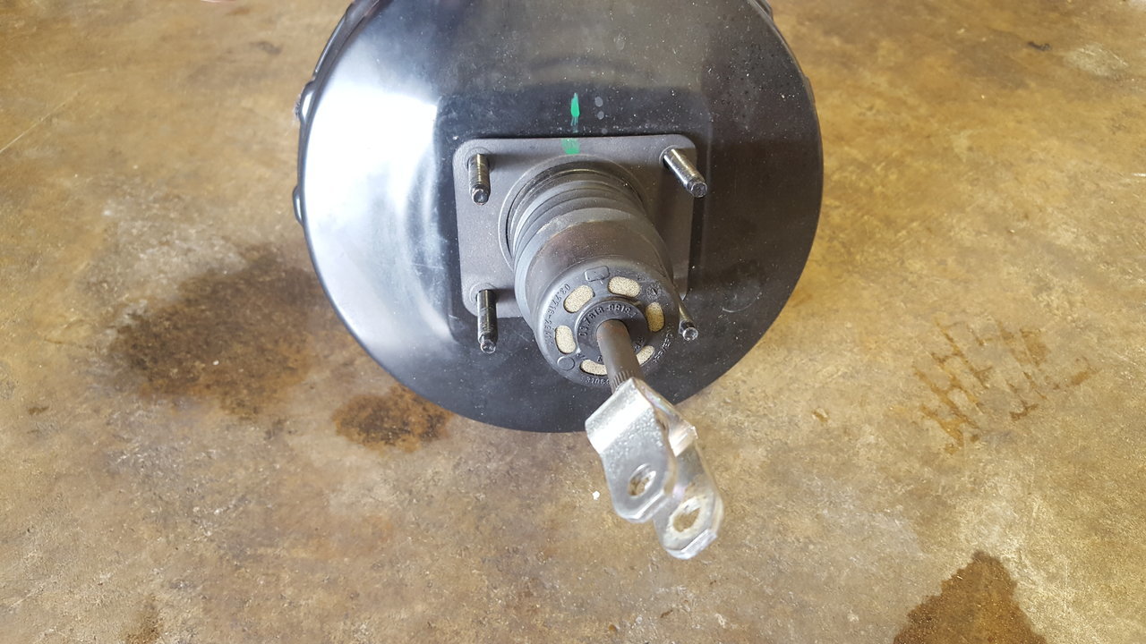

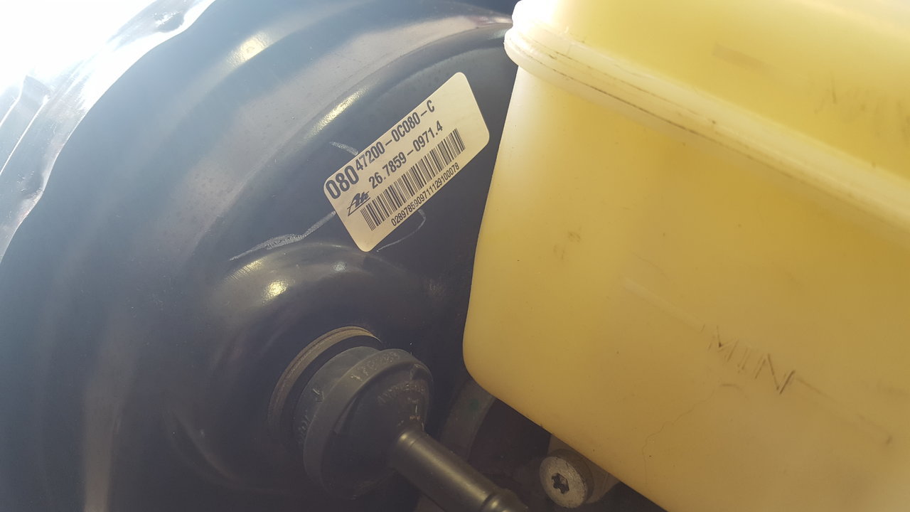

    Swapping the booster in is not quite as straight forward as I was lead to believe. The plunger is significantly shorter than the taco one, so that had to be lengthened. And let me tell you, it's not fun to remove the brake pedal. I needed to compare the lengths and make sure my modified plunger would work, so the pedal had to come out.
    The new booster is installed and the pedal is back in now. I'm waiting on UPS to show up with my overnight order. If they don't show up tonight I'm going to be PISSED!
