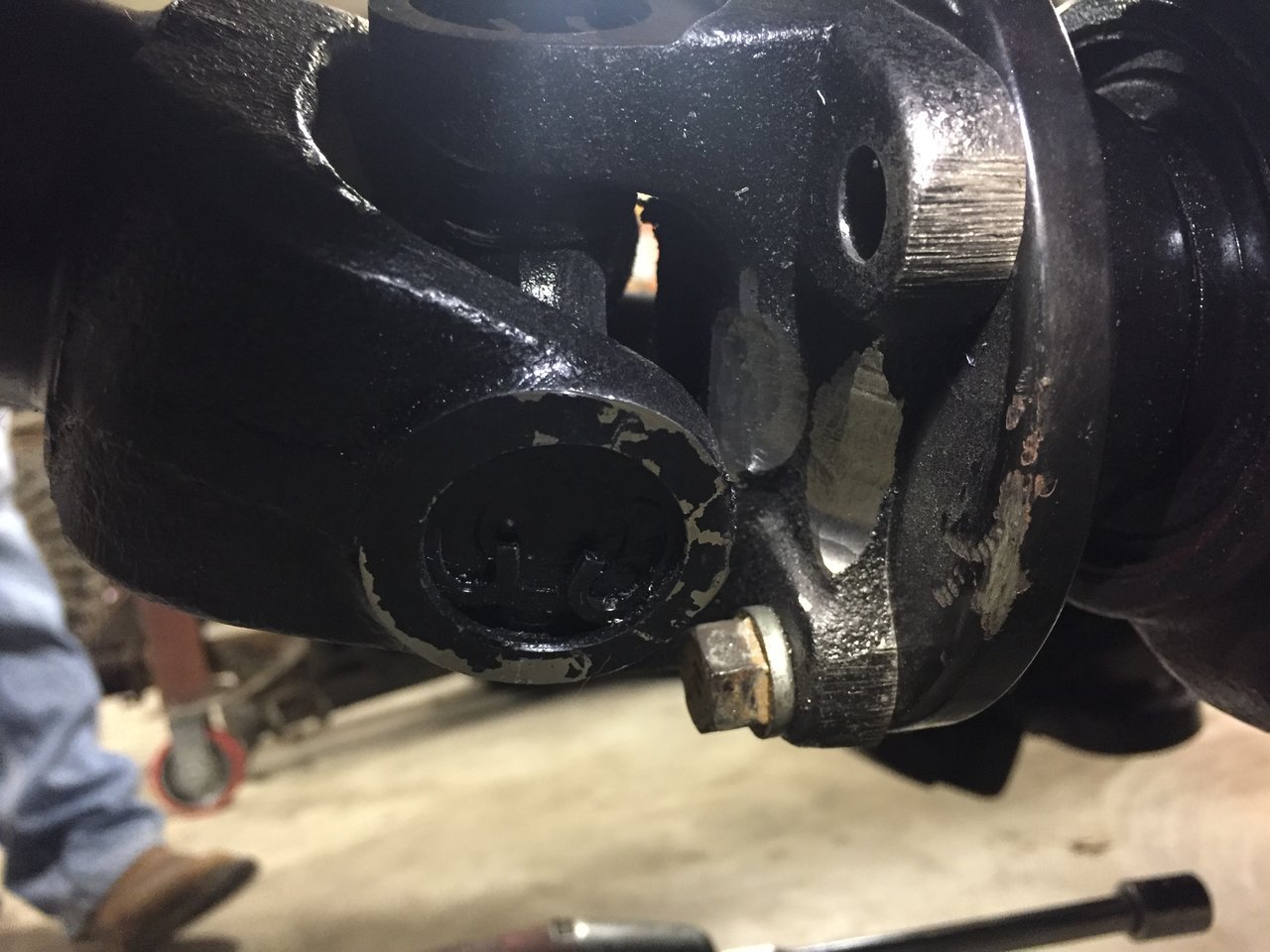

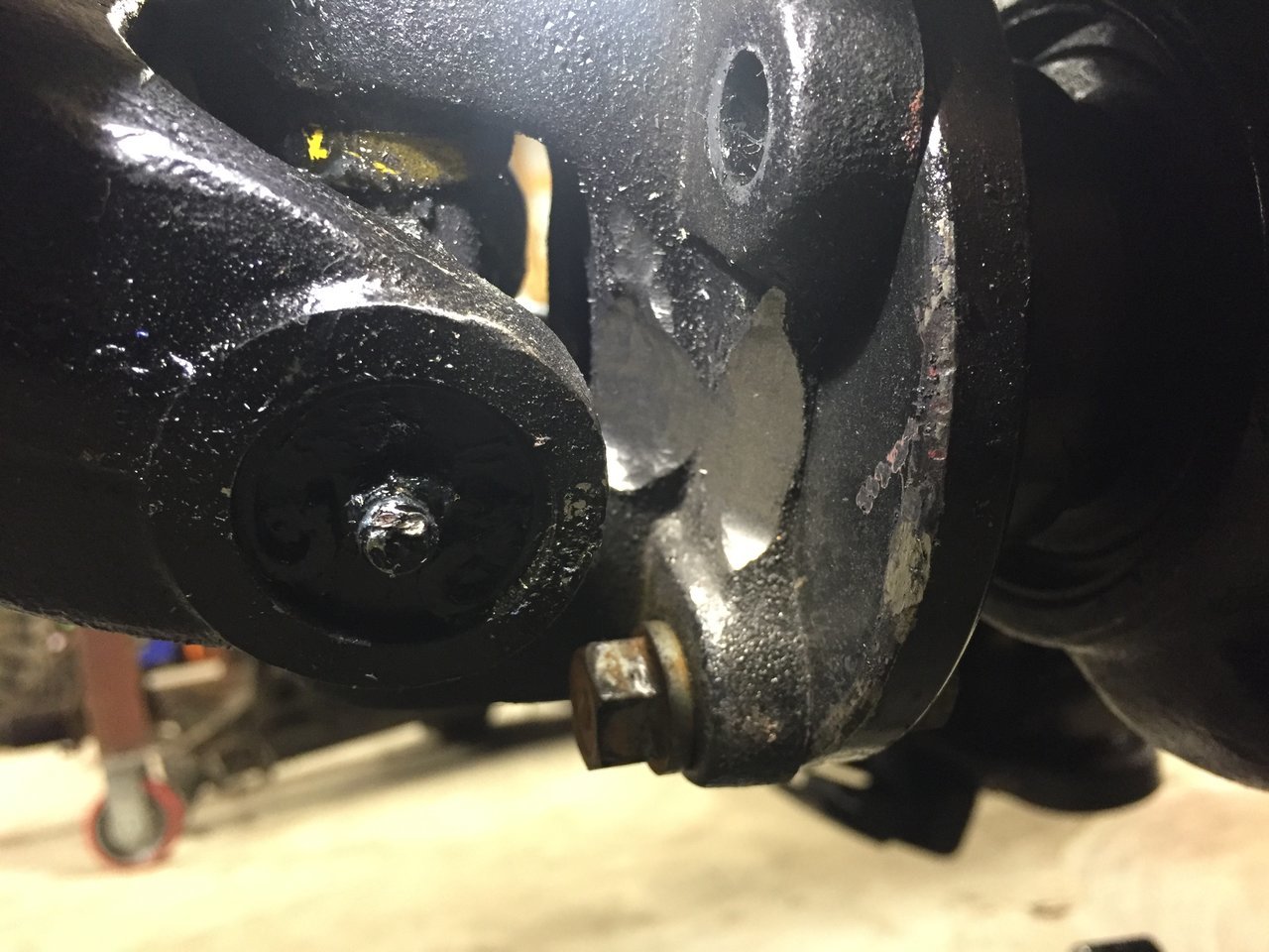

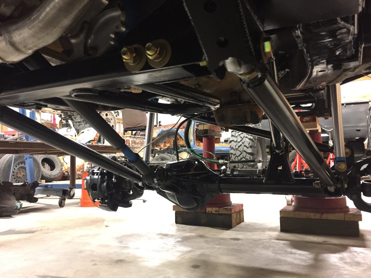

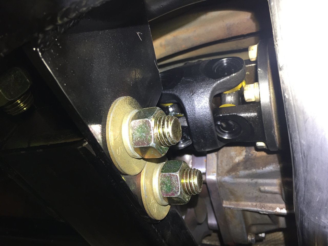

    Welp, Smokey is no longer a pre runner. :D I did have to modify my brand new driveshaft to get her to clear, thankfully it wasn't too drastic of a cut. At full droop, both sides dropped out, the ears on the front joint hit the flange. I took the die grinder to it and took care of the problem.
    Photo Jan 17, 12 49 26 PM.jpg Photo Jan 17, 12 49 40 PM.jpg Photo Jan 17, 1 01 12 PM.jpg

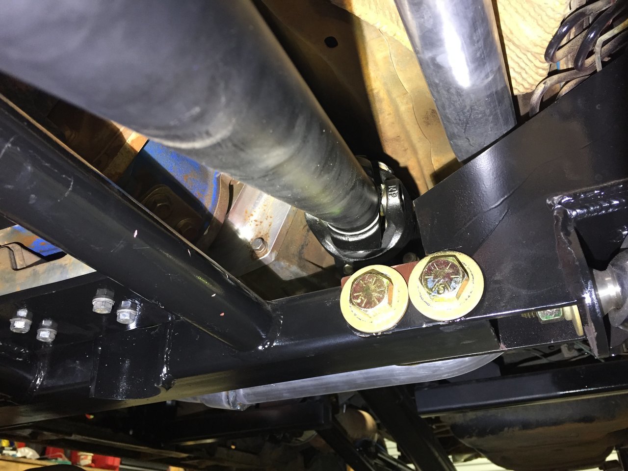

    The double cardan clears the cross member nicely when fully drooped.

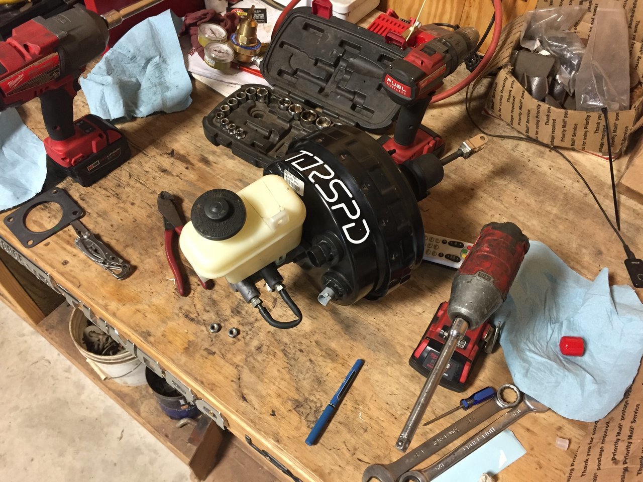

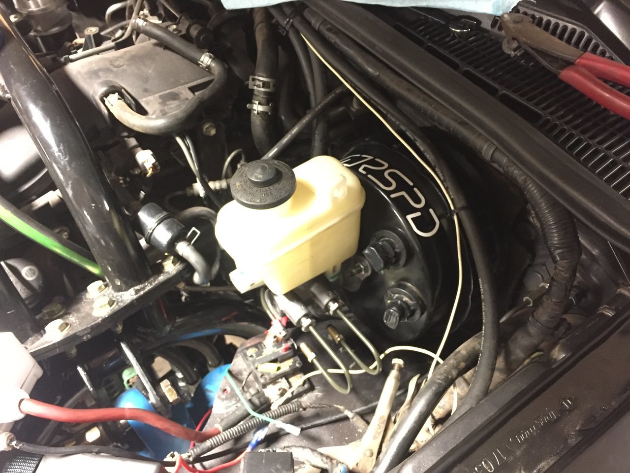

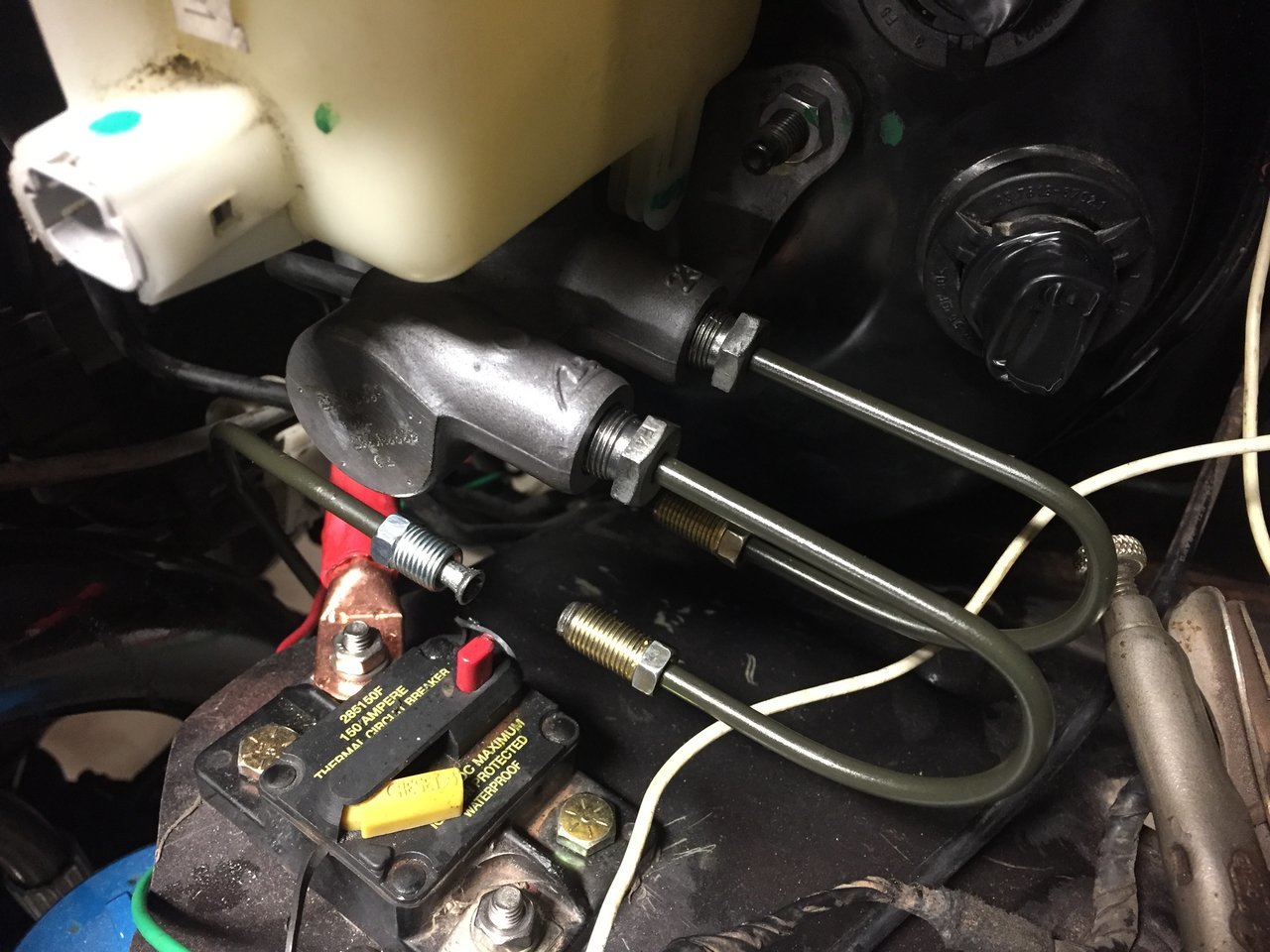

    I would have finished the Tundra MC and booster install yesterday but UPS decided the little bit of ice on the road was enough to call in sick yesterday. I'll get her wrapped up and tested today. #crossesfingers

    It'll hold. What other punch list items are there prior to finishing the brakes?

    Tom Woods Driveshaft?
    lordetaco and ChadsPride like this.
  8. Jan 18, 2018 at 12:28 PM
    #428
    SMKYTXN
    SMKYTXN [OP] If it can't be overdone it's not worth doing Vendor
    Mar 11, 2011
    #52810
    14,040
    Nathan
    Houston
    11, 4dr, TRD Sport, 6sp
    DCFB
    Correct.
    40" at ride height
    42" extended
    Double Cardan at the top with clearancing
    Single ujoint at the 60 with my clearancing
    Standard spline

    You’d have to change the pinion angle if you went double cardan. Not worth it for you
