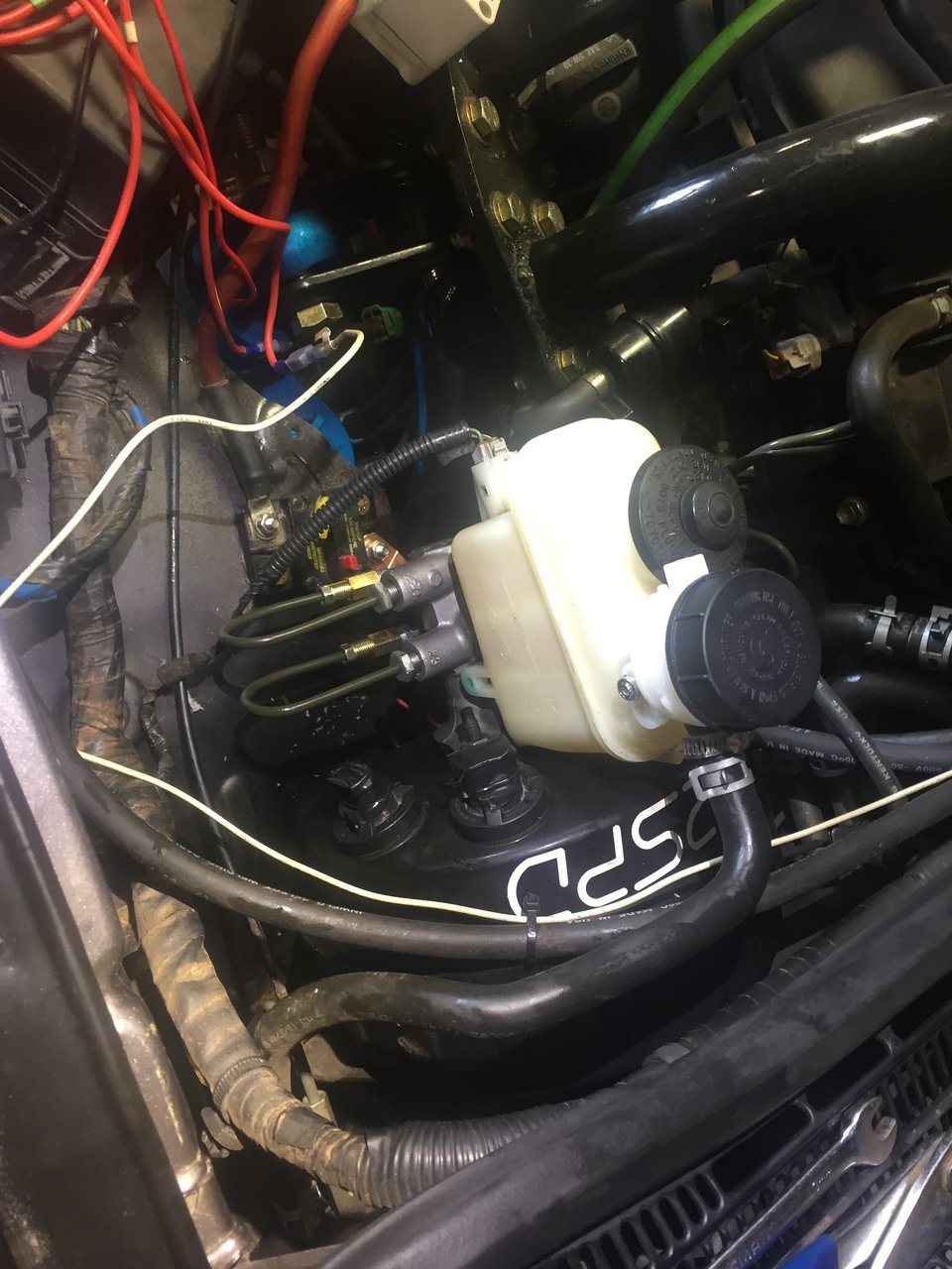

    The brakes are much better! The brakes aren't perfect, but they're serviceable. It's apparent I need a proportioning valve as the back end likes to get happy under braking.

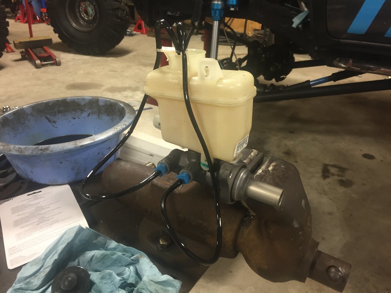

    Bench bleeding the master.
    Of course the outlet on the Tundra MC are on the other side, so I had to make some adapter lines to mate up with the lines I had just built.

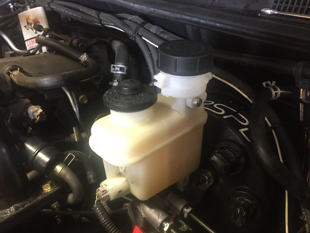

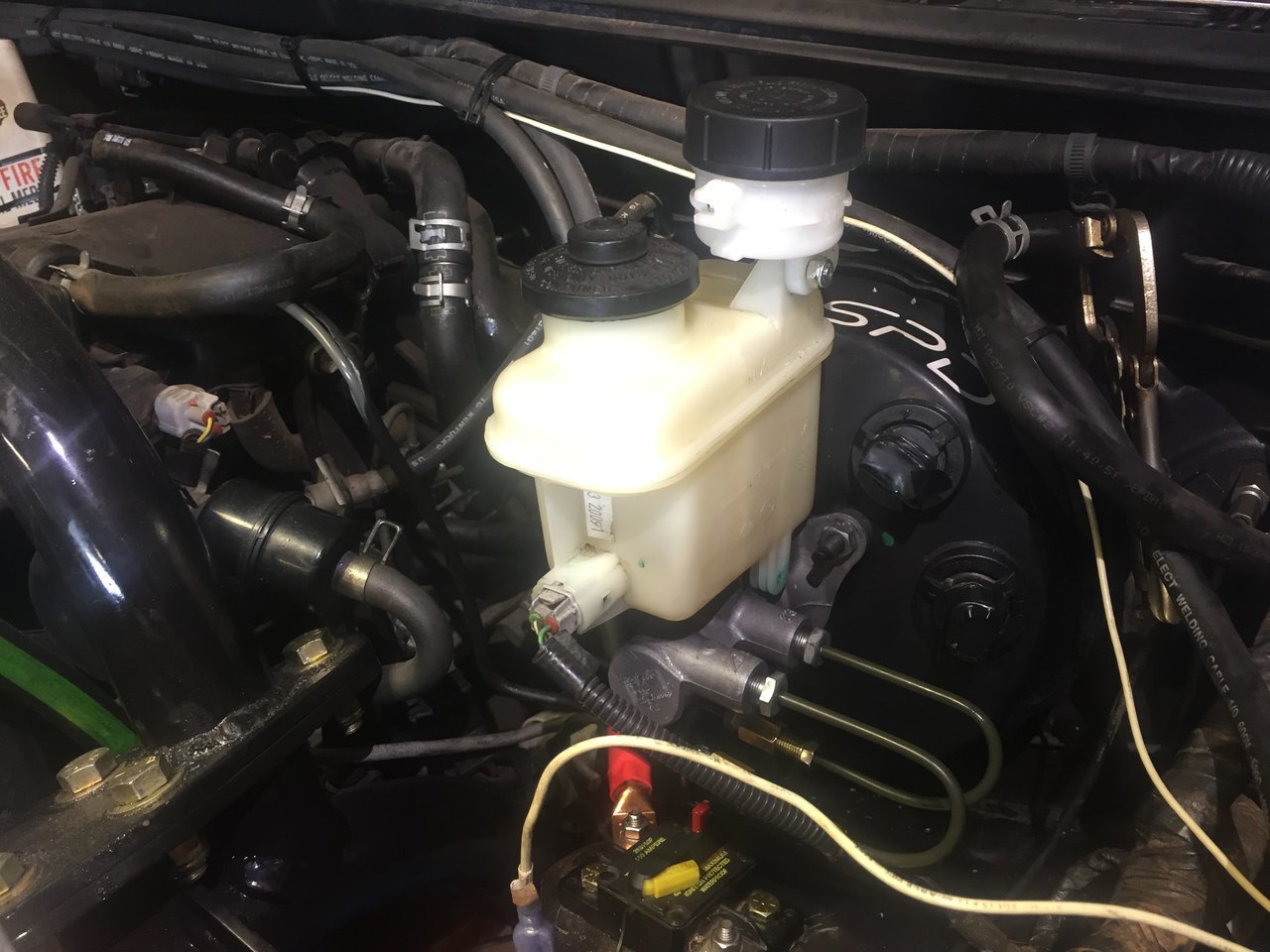

    The clutch was fed with the stock MC reservoir, so I had to improvise. The motorcycle reservoir I picked up mounted to the tundra reservoir quite nicely.
    The feed line for the clutch even matched up with it.

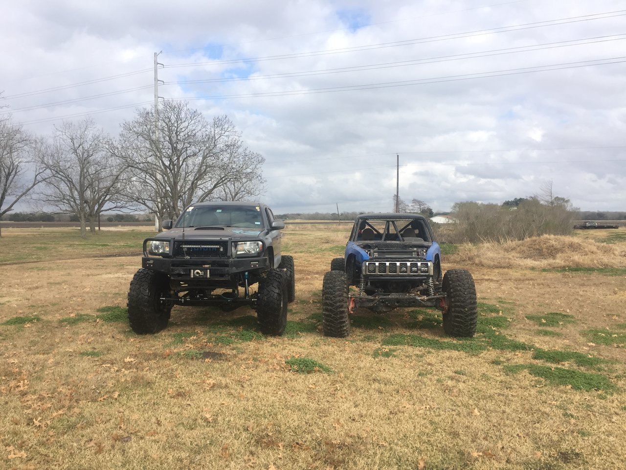

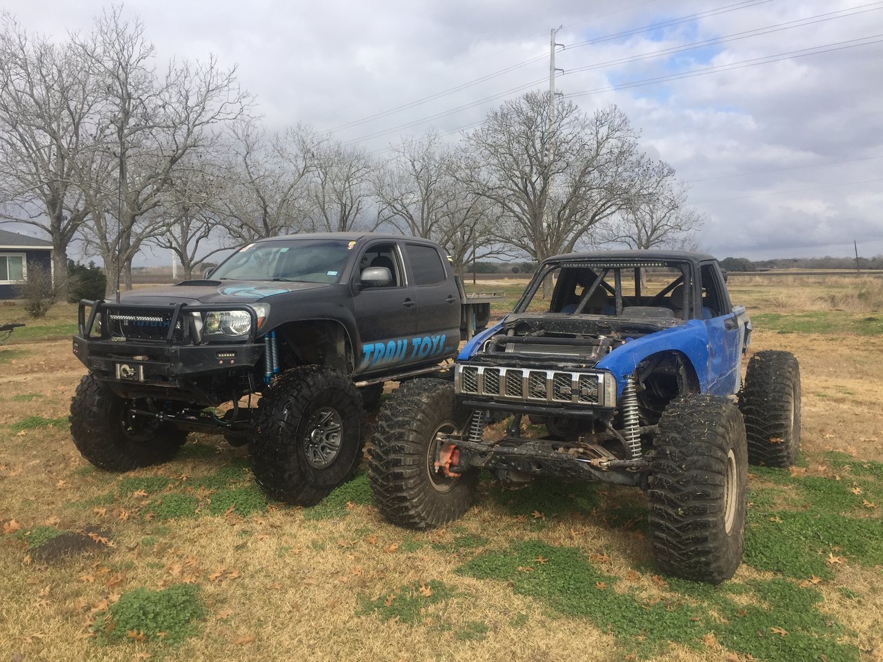

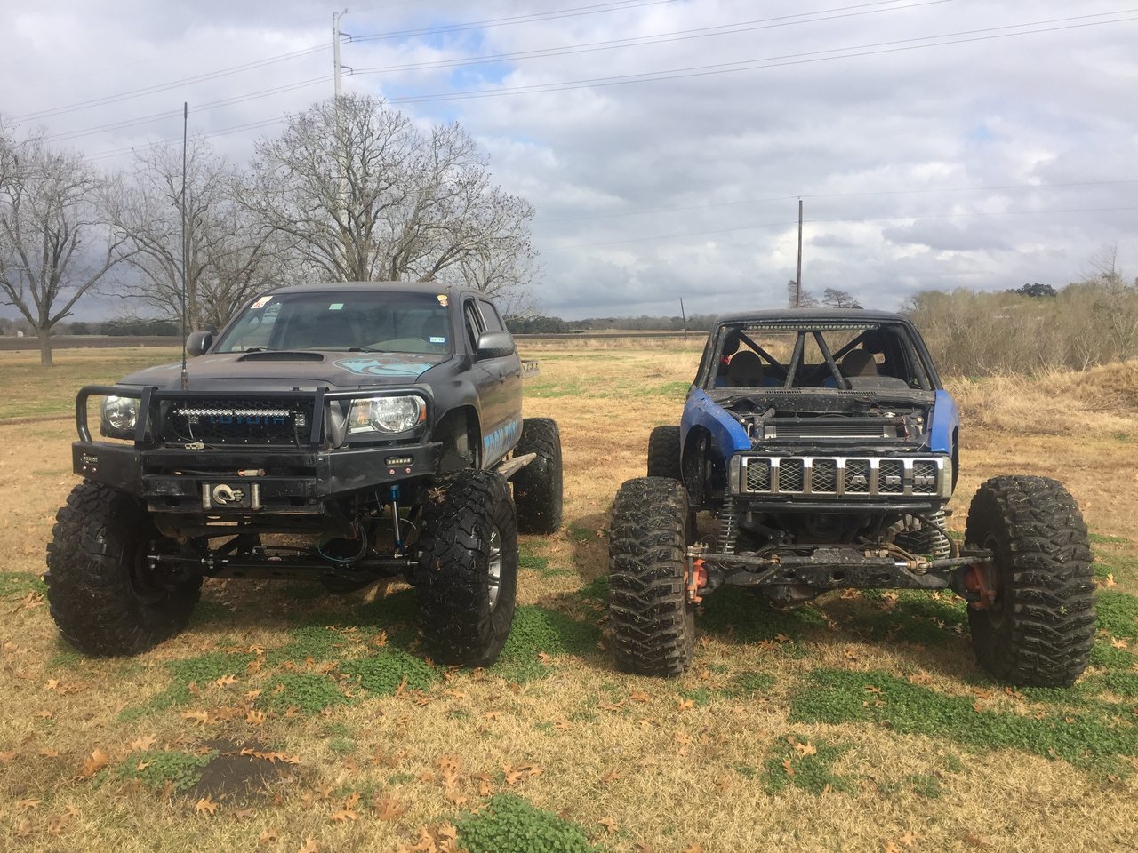

    I rolled her out for a test drive and had to move the Dirt Squirrel out of the way to get out. I figured it would be fun for a size comparison shot.
    Photo Jan 20, 1 39 52 PM.jpg Photo Jan 20, 1 40 08 PM.jpg Photo Jan 20, 1 40 16 PM.jpg
    I have some wiring to clean up and I need to change the oil, but she's damn near ready to roll out to KOH!

    I finally have a brake pedal! So I had both my stock master cylinder and the tundra master cylinder hooked up backwards. My assumption when attaching the lines at the master was that the front port was the front and the rear port was for the rear. So yeah, not so much.
    Here's how it works. That rear port, closest to the firewall, is the port for the front brakes. Reason being, is that it's the larger diameter plunger and has a longer throw. The secondary port is the one furthest from the firewall. So when you stop on the brakes the first bit of pressure hits the front brakes and as you press further the rear brakes engage.
    So yeah, I had some learning to do about brakes. The stock mc was hooked up improperly the first time as well, but wouldn't lock up the rear tires like the Tundra mc would. So the Tundra MC was definitely a necessary improvement.
