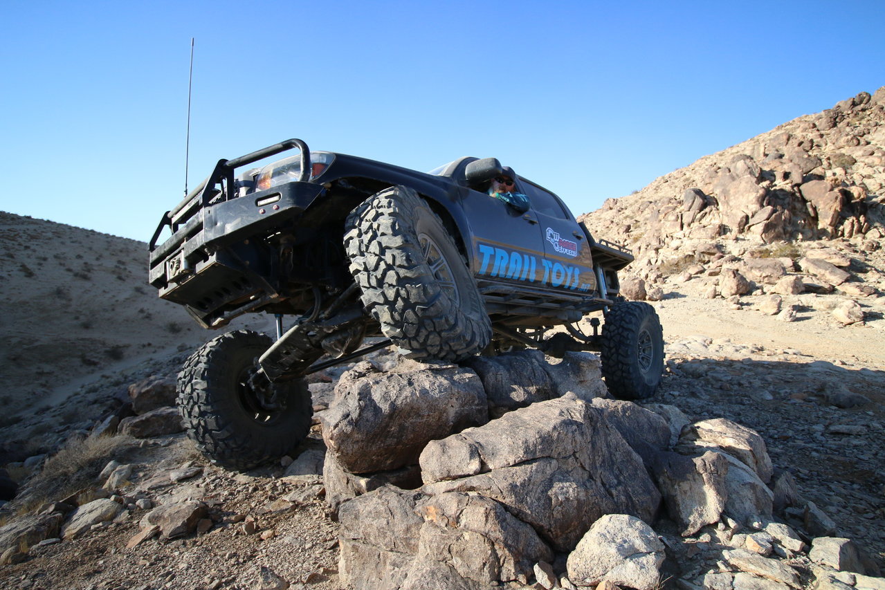

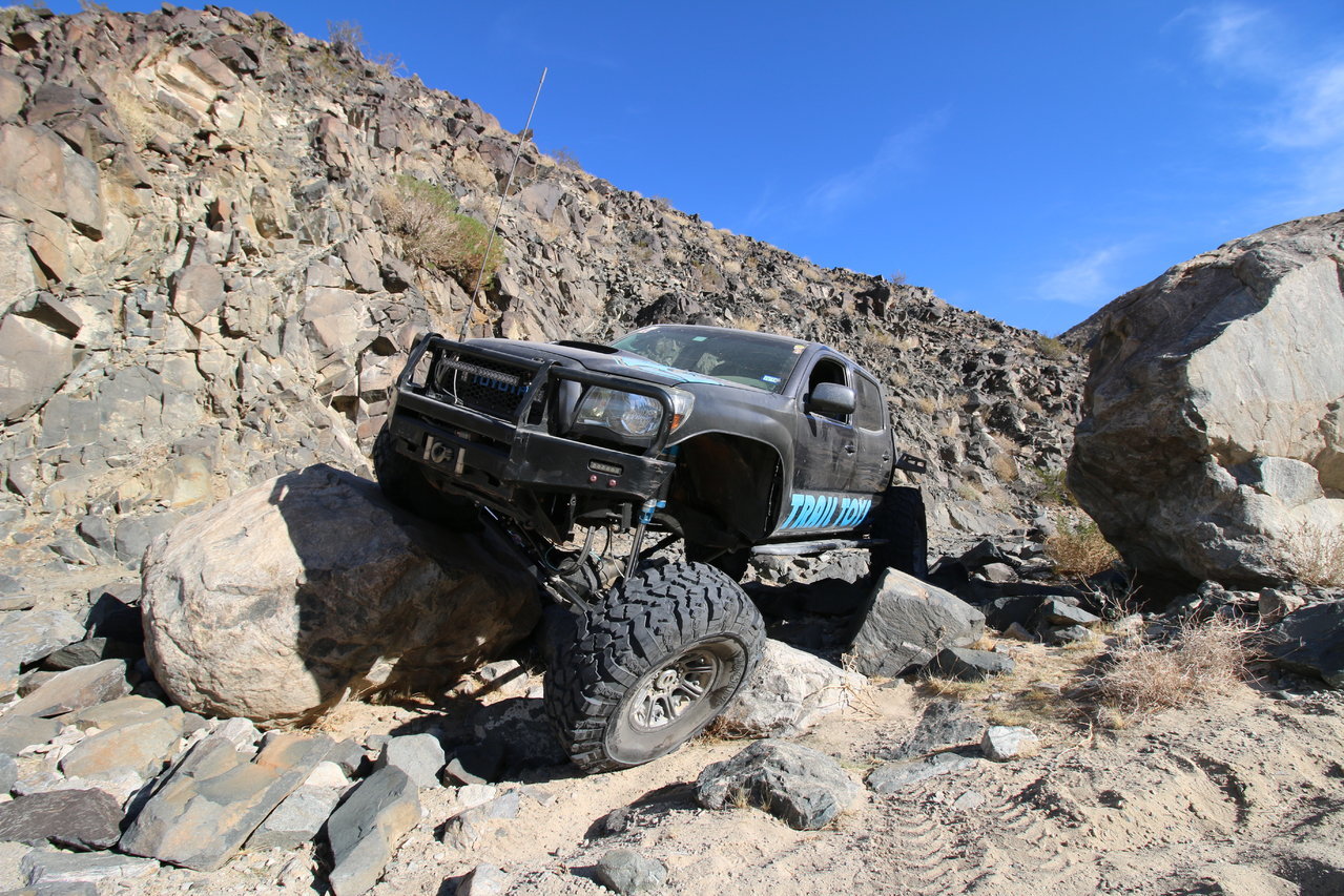

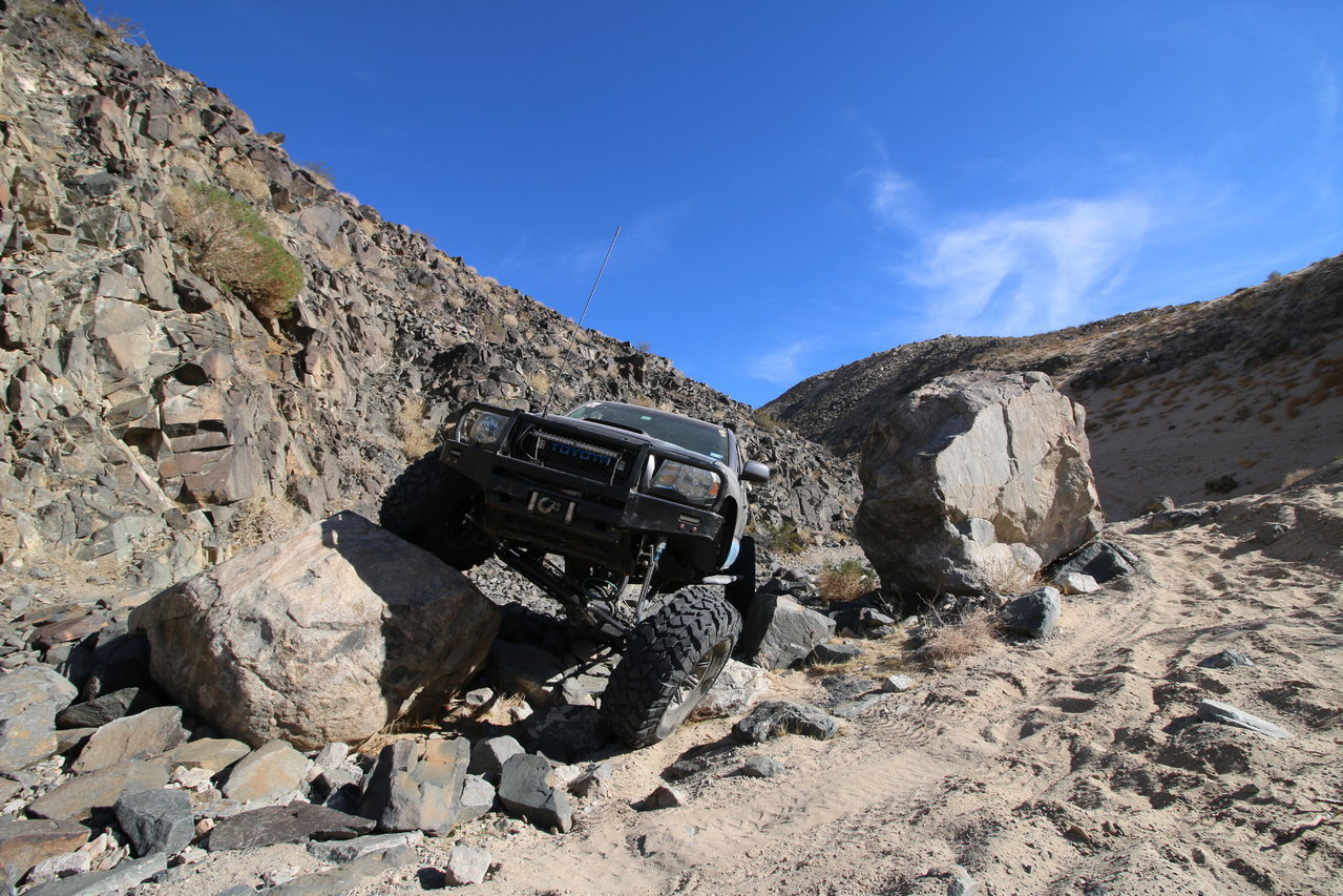

    Playing around on the rocks to see what was going to hit if anything. I ended up cutting a few bits off that were making contact. Nothing major though.

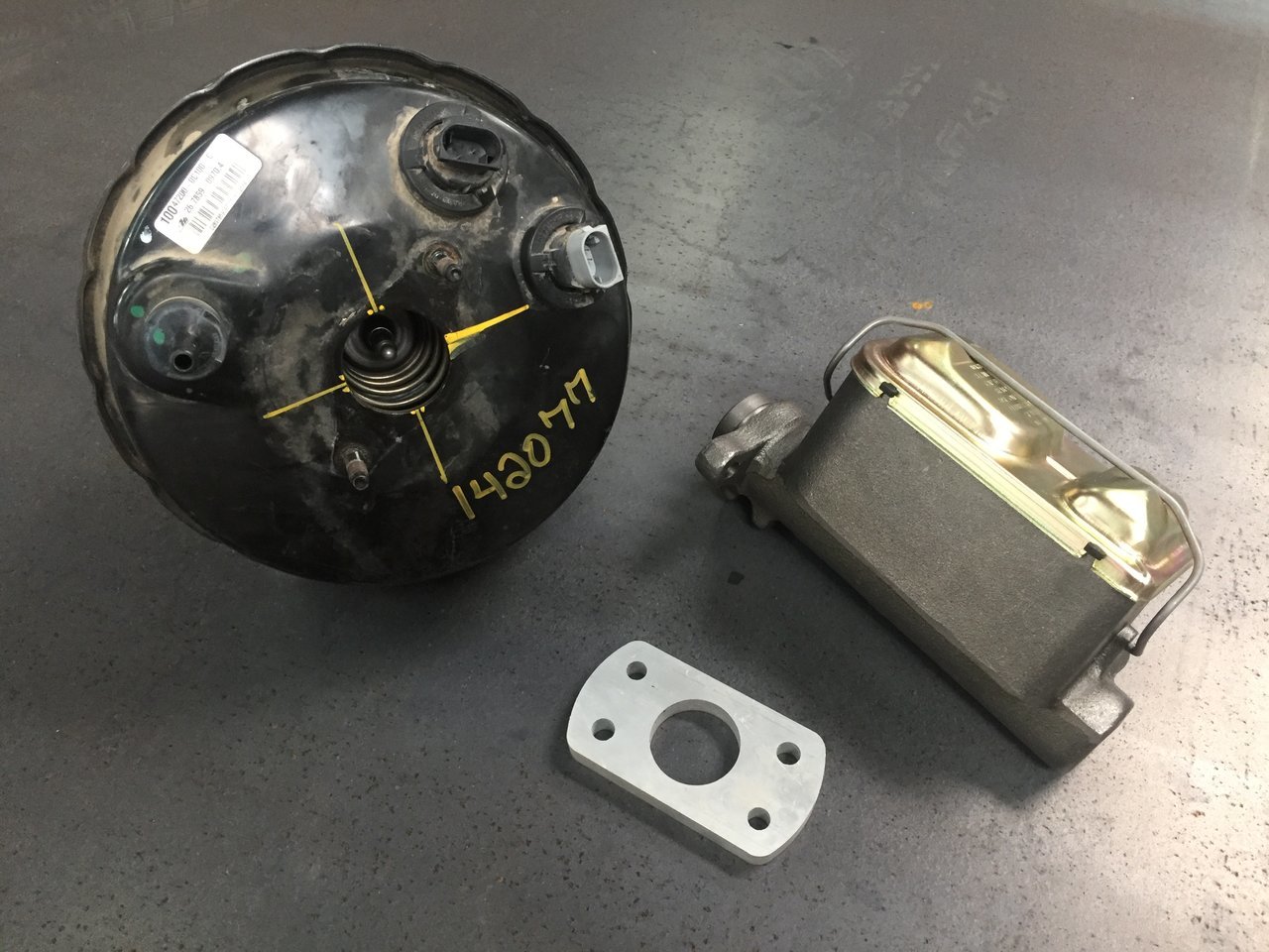

    The Tundra master and booster aren’t quite cutting it. The truck will stop, but the pedal is very low. I’ll post the math here later, but I figured out that I need a larger bore master to bring the pedal up.
    There are several companies that make adapters for the early trucks, but nothing for our trucks. Well, I’m going to fix that. The adapter, after a little machining will be ready to bolt up. I’ll be making a plunger adapter as well.
    So after this is all said and done I should have a kit to add the Tundra booster and gm one ton master to your taco.
    This isn’t needed unless you’re swapping in tons, but I can see that trend picking up.

    I like this. Been trying to figure it out myself. I only have a one ton rear at the moment and my pedal sucks.
