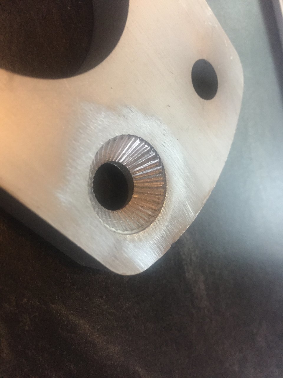

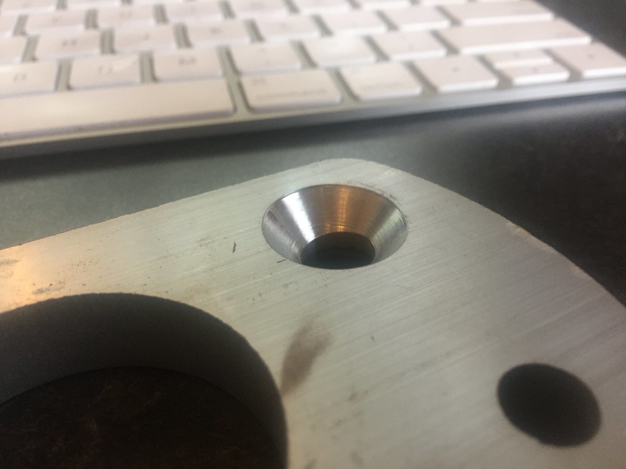

    The countersink bit that I used for my prototype chattered like crazy, but cut well enough for testing. I found a zero flute bit and gave it a shot. It’s works great!
    I will have the blanks water jetted early next week so we’re getting closer to a final product being available.

    Yeah, but this was unacceptable.

    Accept you inadvertently made a locking countersunk bore. No lock washer needed. :cool:
