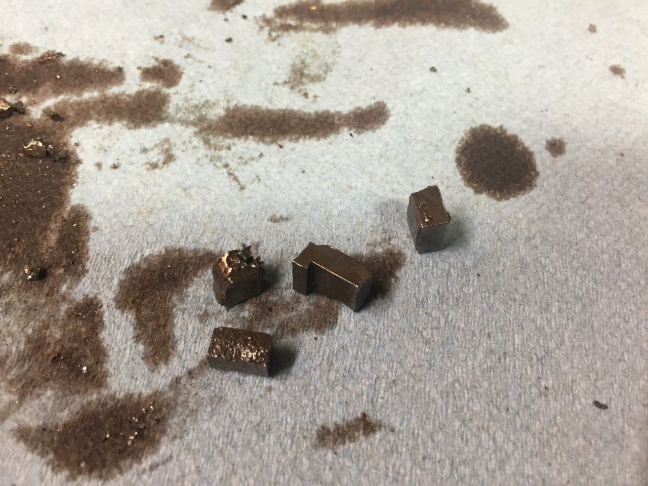

    Yeah, we might have to wait till the next one. This came out of my transfer case. Whoops
    I’ll pick up a new case from LKQ tomorrow.

    She was binding up pretty bad and making all kinds of fun noises. Funny thing though. She didn’t make a single noise when I pulled her off the trailer when I got back.
