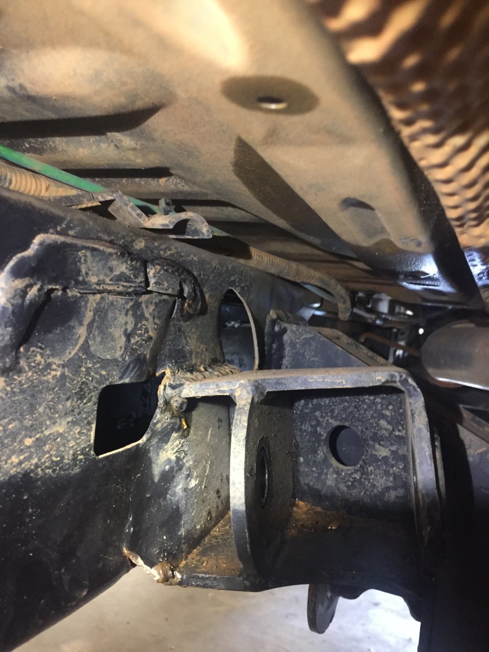

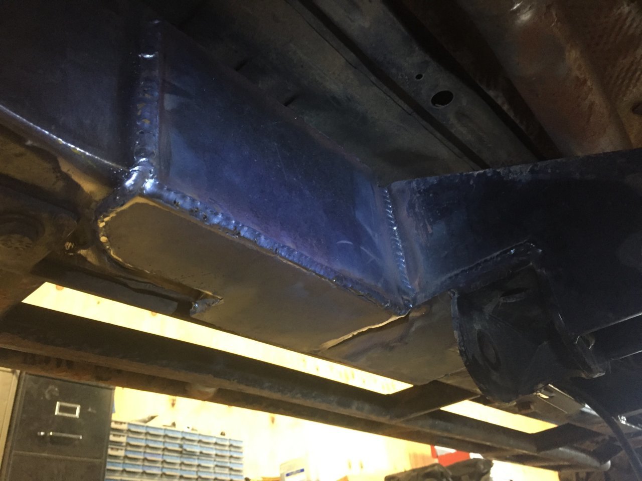

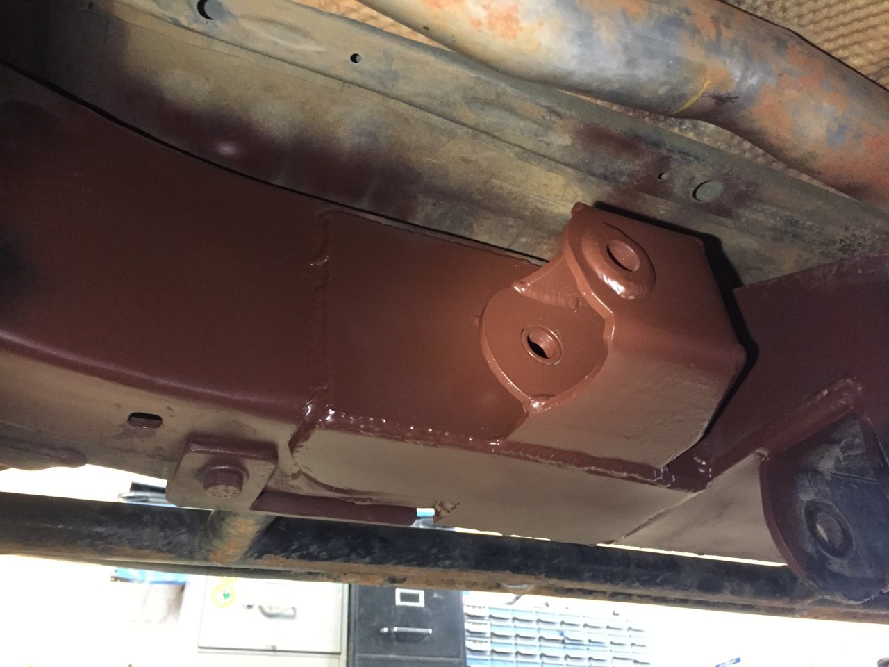

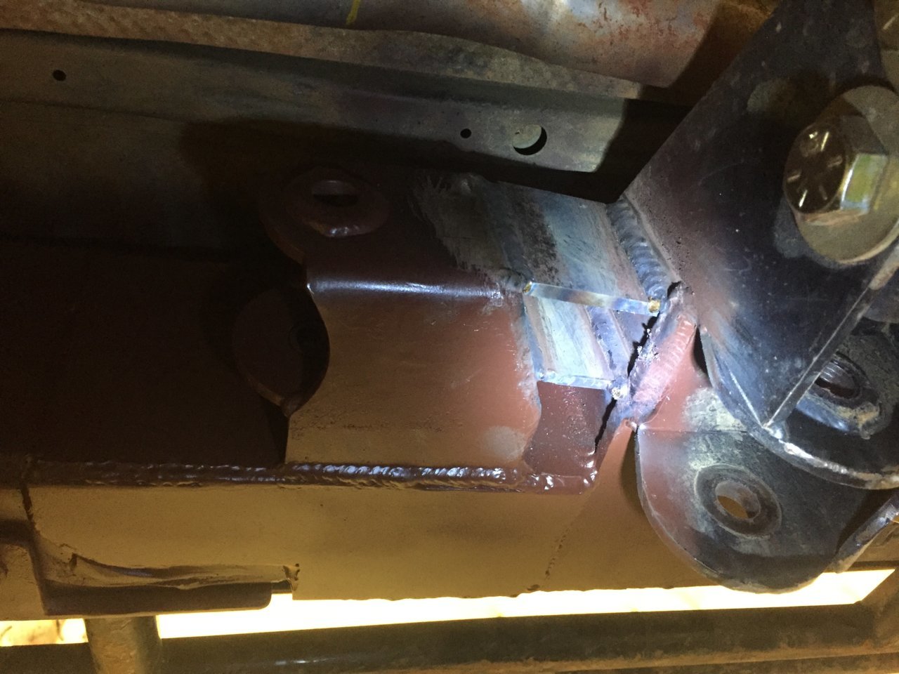

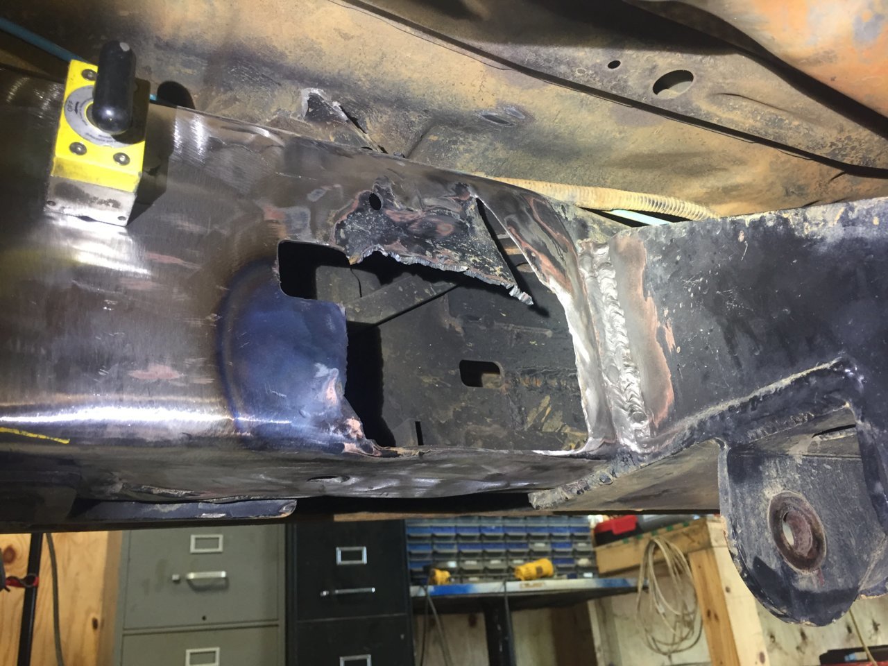

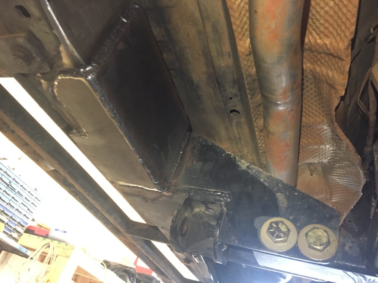

    For some unknown reason I didn’t plate the frame under the upper link mount. That proved to be a mistake.
    When the mount ripped out the axle rotated which broke both flanges on the driveshaft and tweaked the lower eyes on the ORIs.
    The fix was to cut out the mount, plate the frame, and add some gussets back to the cross member.
