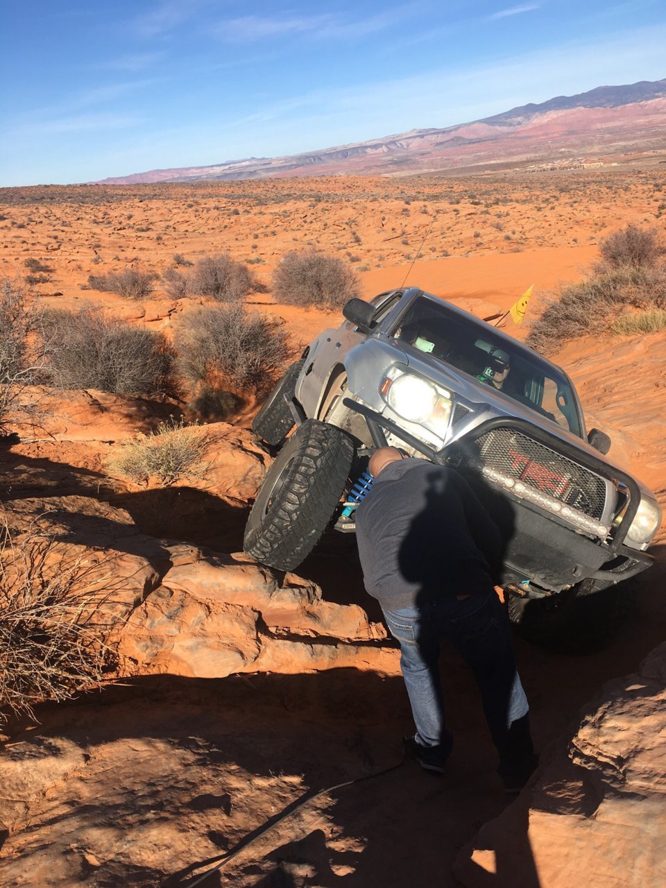

    There was no reset on the first one, tip over. Slid down into it, forward or backward made it worse, so we winched up and out to keep me from going over.

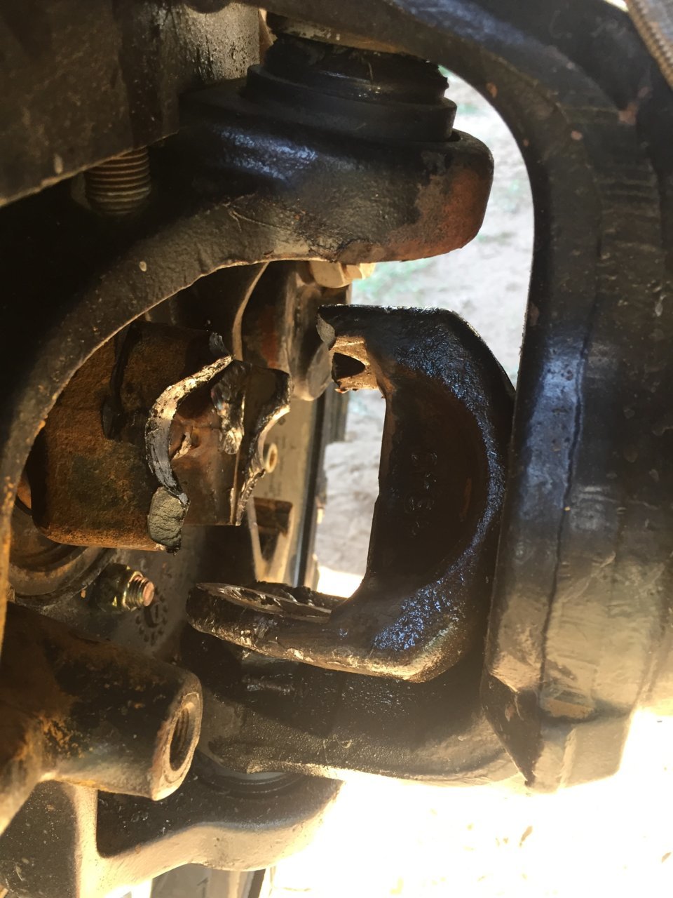

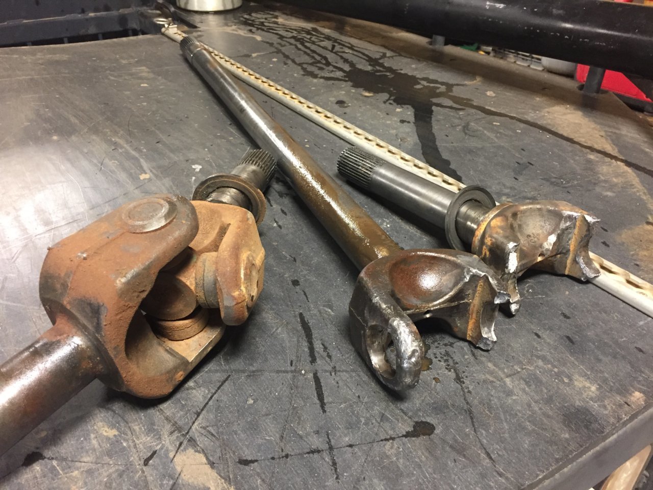

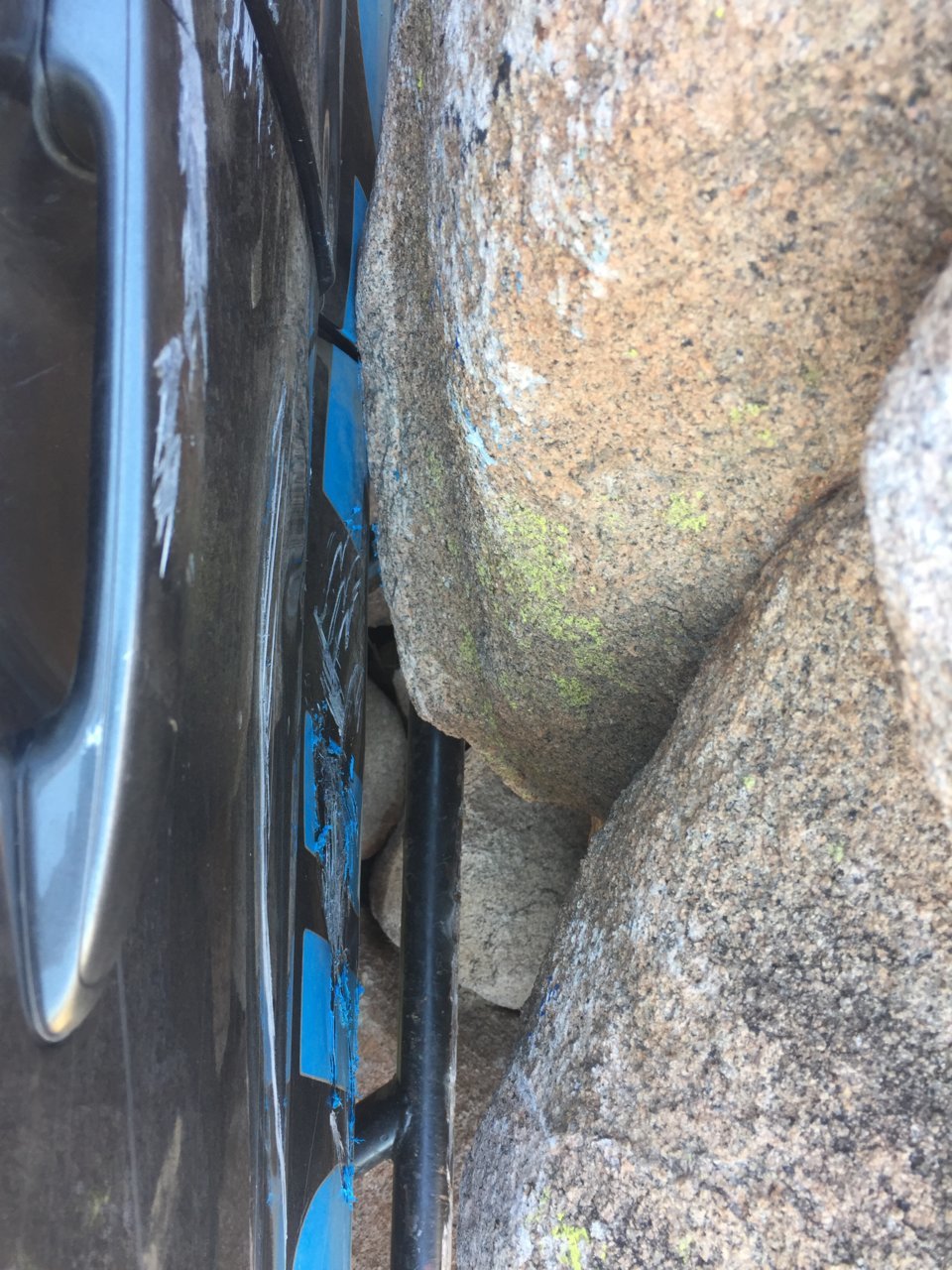

    I'm going to call this my first real break. I ended up with the tires hard passenger against a rock, the door against a rock, and the rear tires pinned. I put her in reverse, hit the locker and POP! The passenger ujoint exploded and during the recovery took out the ears on both the inner and outer shaft.
    This all happened about three hours into the weekend. :bananadead:
    After some winching we managed to get her out and I drove her back to camp. I loaded up the next morning and headed home. That was Saturday and I leave for Hot Springs tomorrow, so no time like the present to get her fixed. I ordered a set of Yukon 4340 shafts and their super joints. We'll see how those hold up to the abuse.

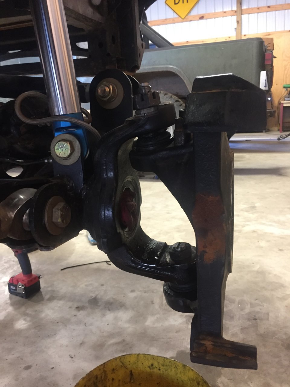

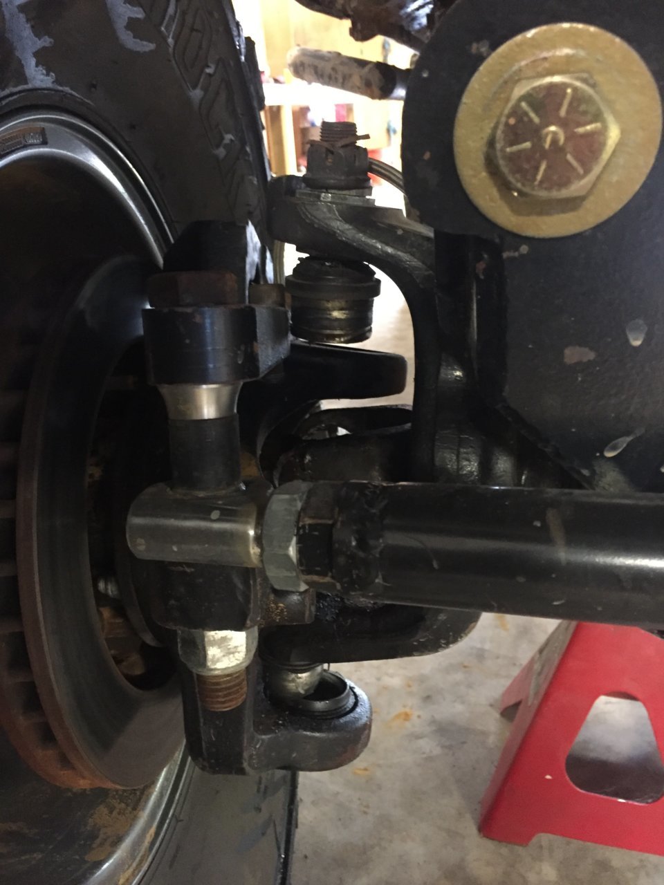

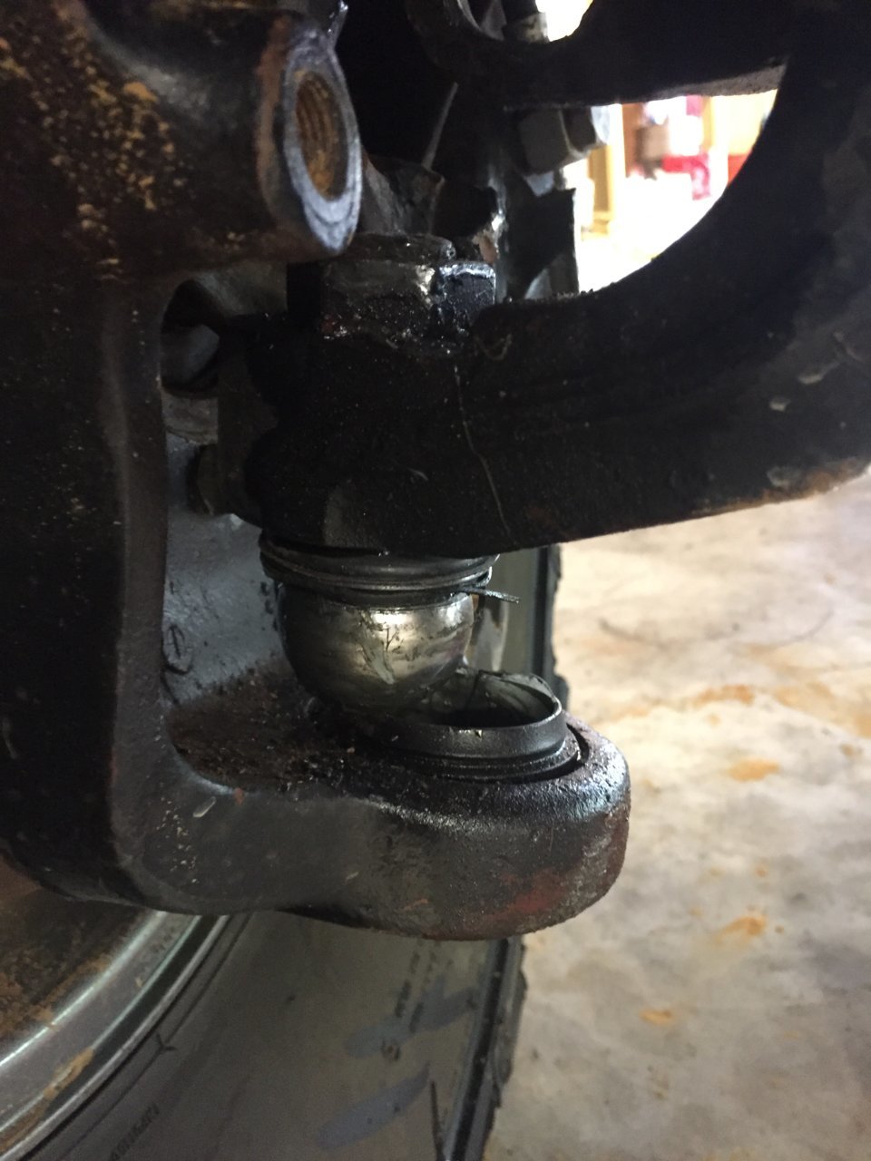

    I tore here down Saturday and discovered that the rotating ujoint had dislodged the upper ball joint which pulled the lower out of the cup as well. The knuckle basically fell off when I jacked up that side of the truck.
    She's back together now with new ball joints. The shafts should be here by 3pm today and we leave at 5am tomorrow. Woohoo! :rofl: :annoyed:

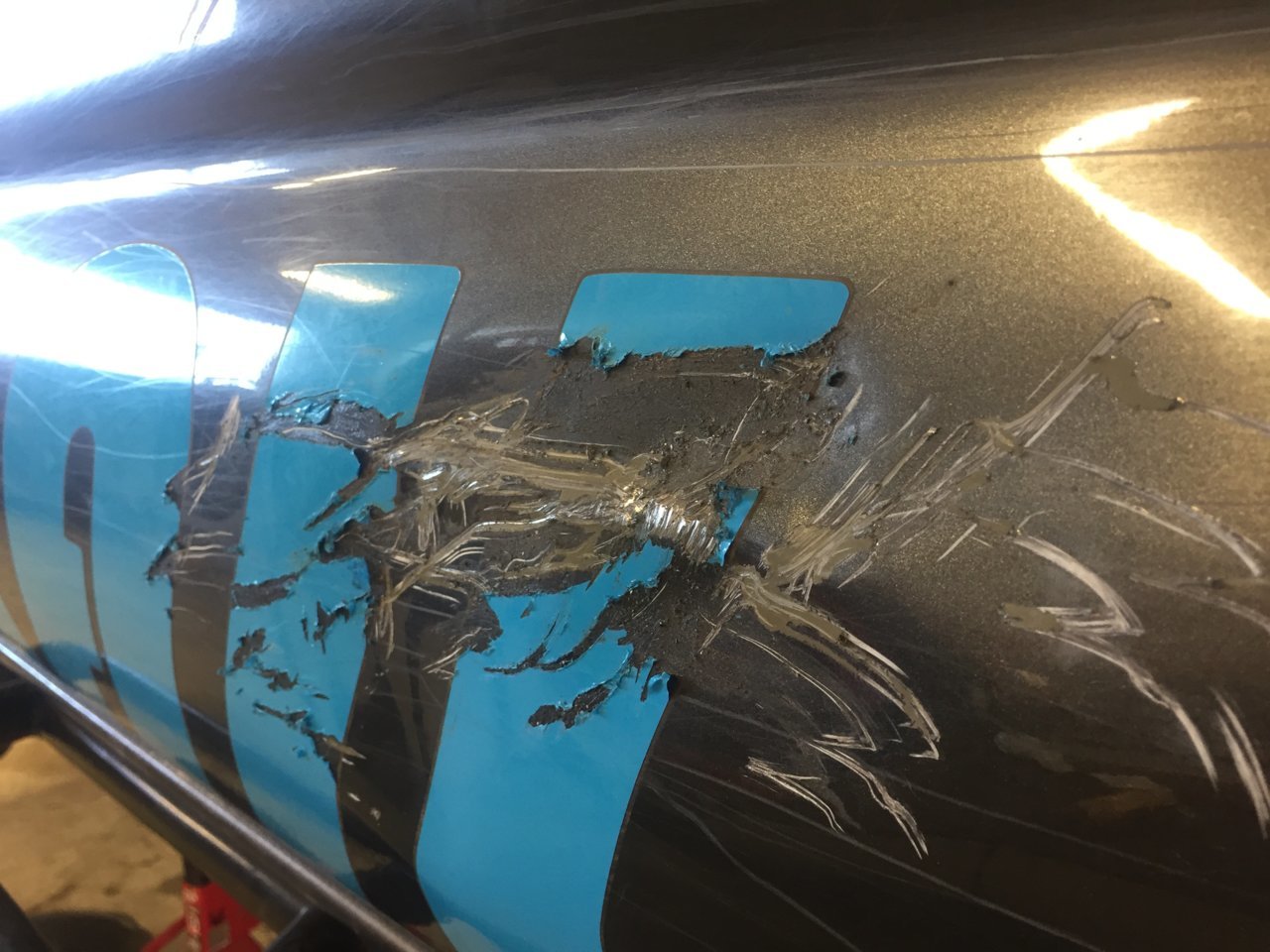

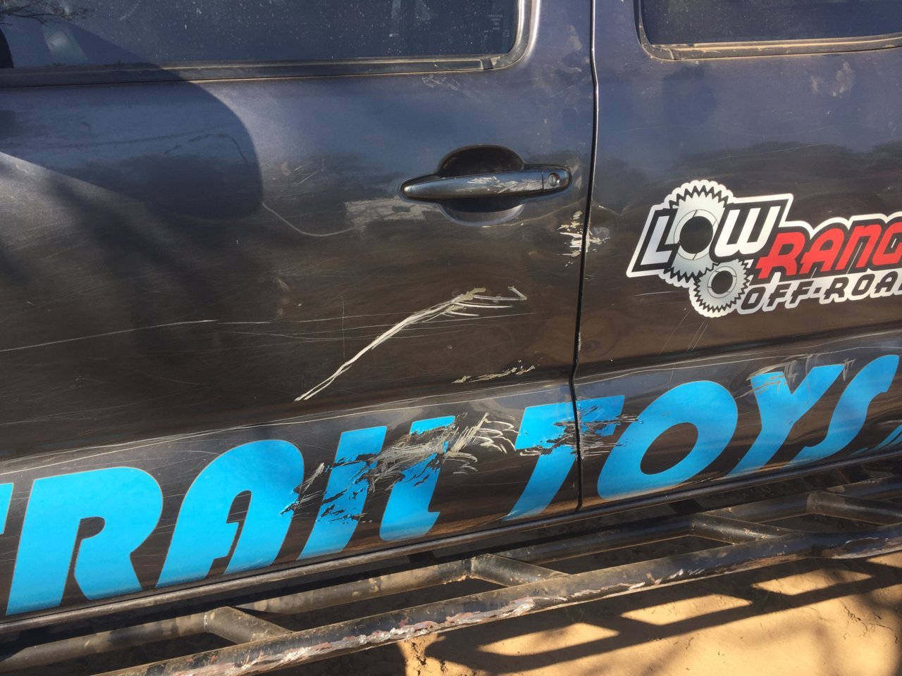

    Well, I at least made it up the main line of Hannibal Lector this time. I broke at the exit. I am still amazed at what she'll go up though. Thankfully I wheel with a group of guys that know how to put me on the right line.
    I might need to redo my decals now.

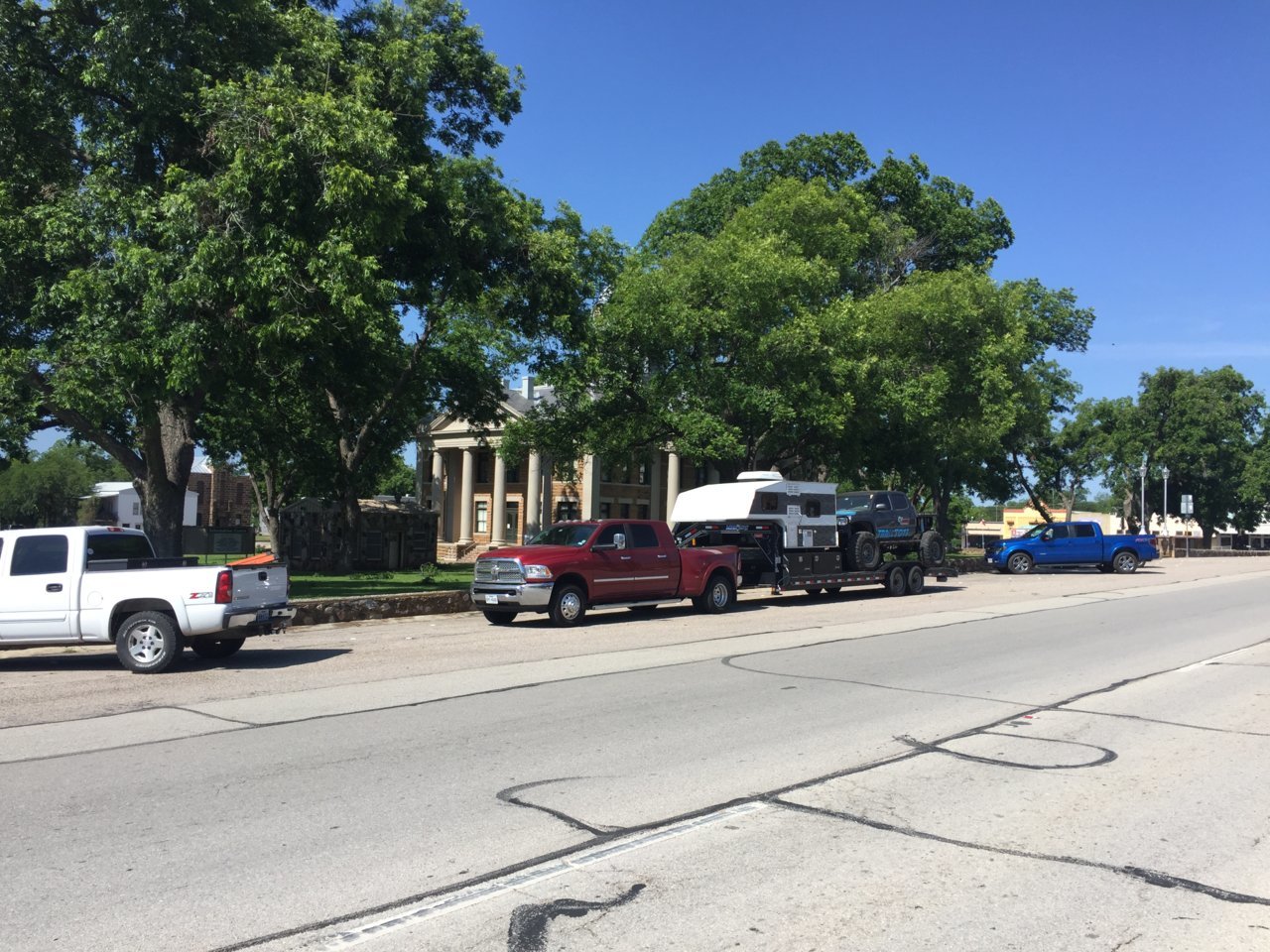

    Leaving early meant I didn't have to rush back to town, so me and the girlie stopped in Mason for some breakfast. It's a picturesque little town.
