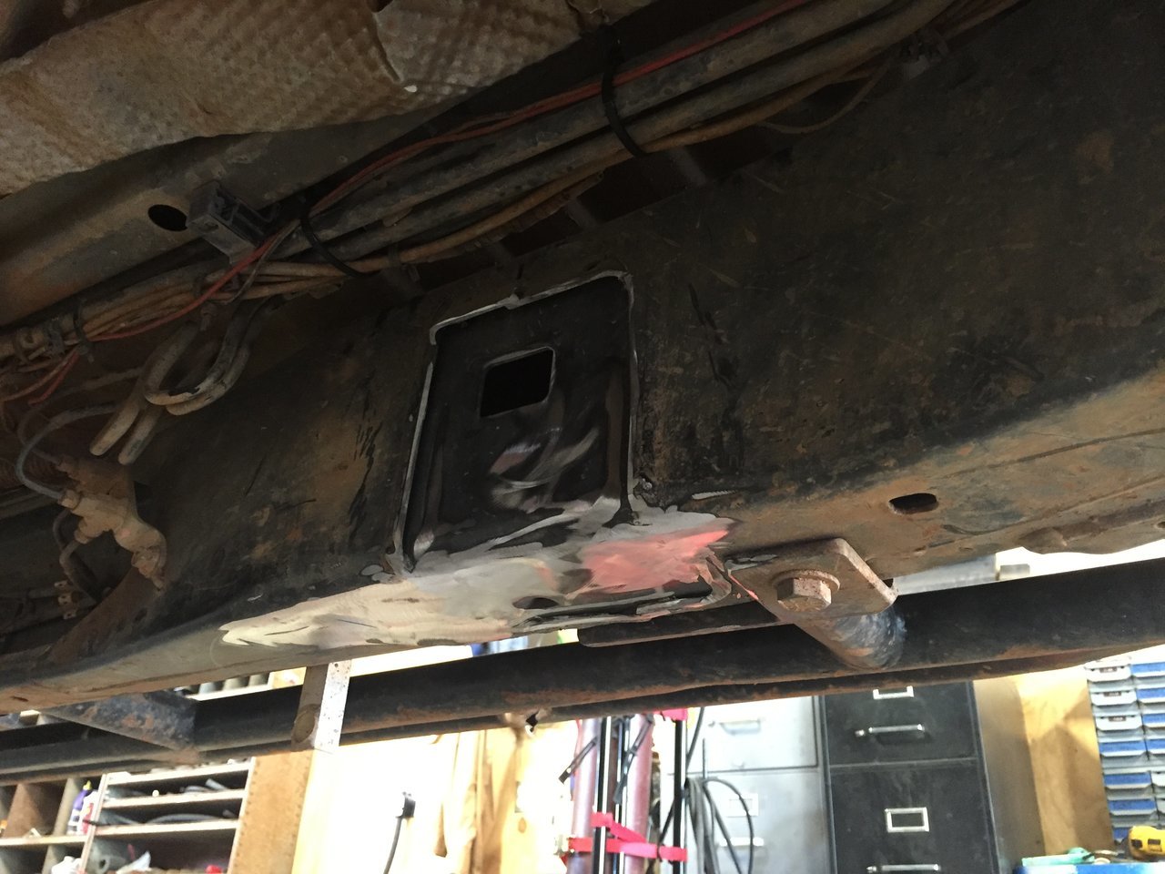

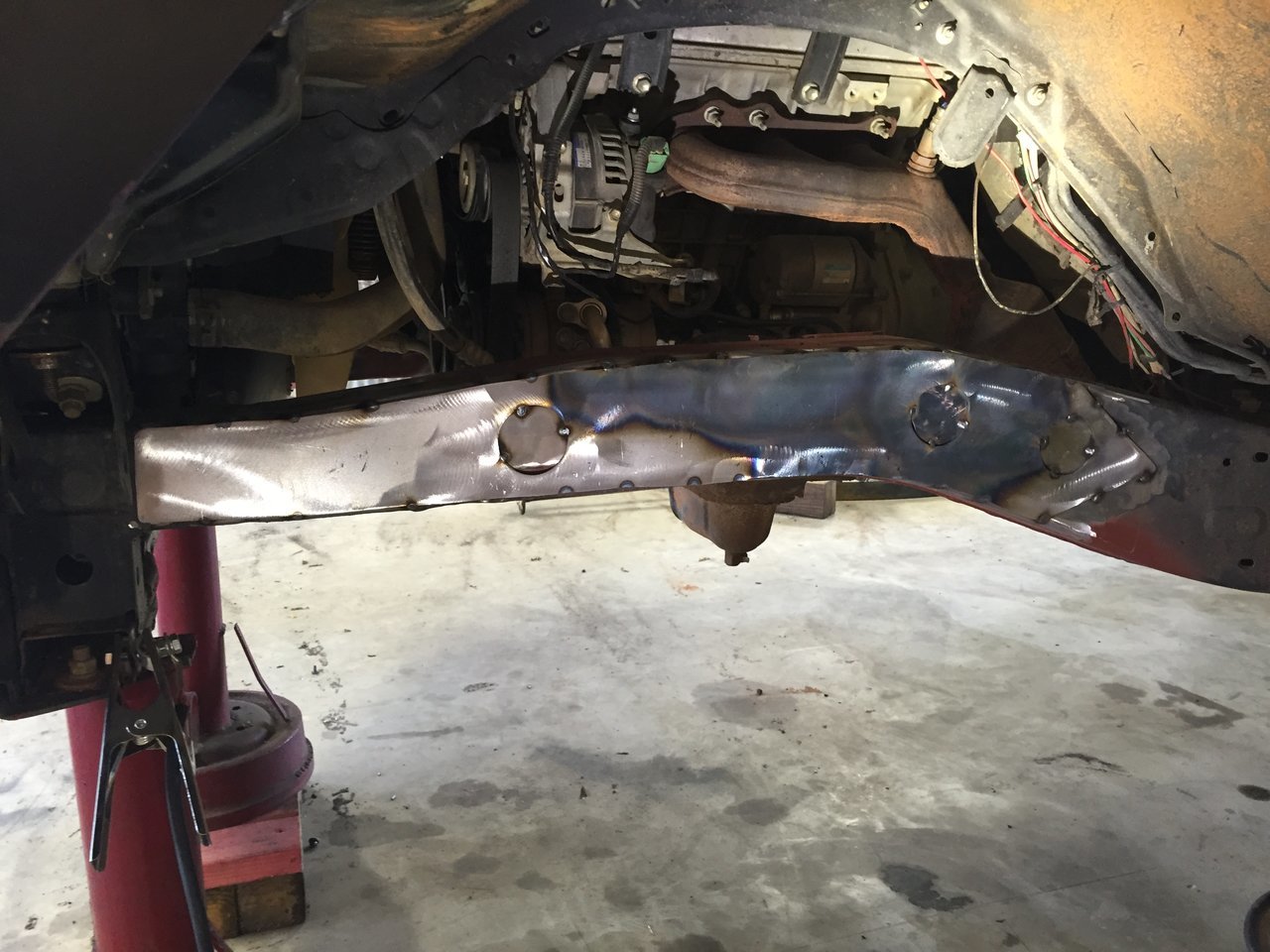

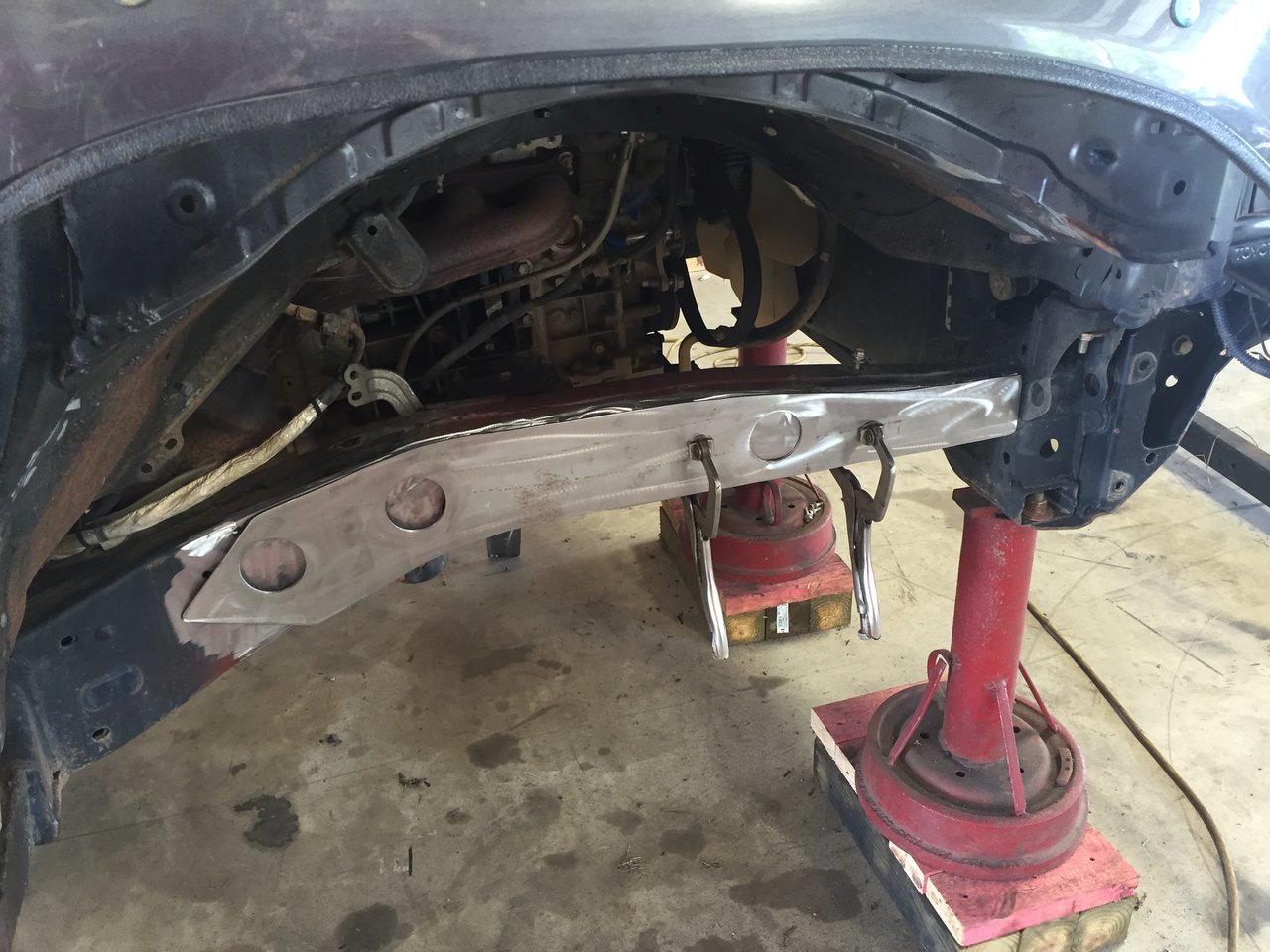

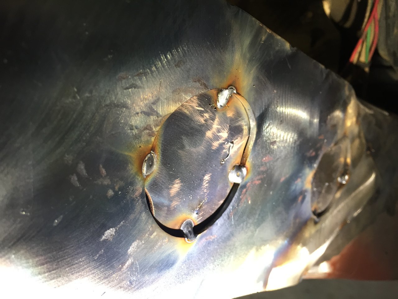

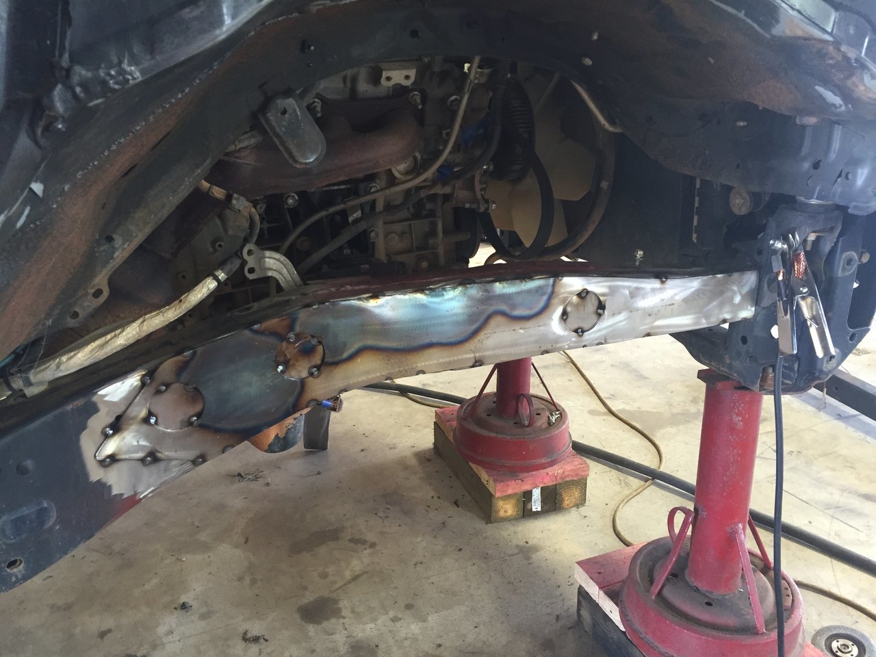

    I managed to get the frame plates welded on yesterday. I underestimated how much time it would take to get these on, but four feet of weld takes a while.

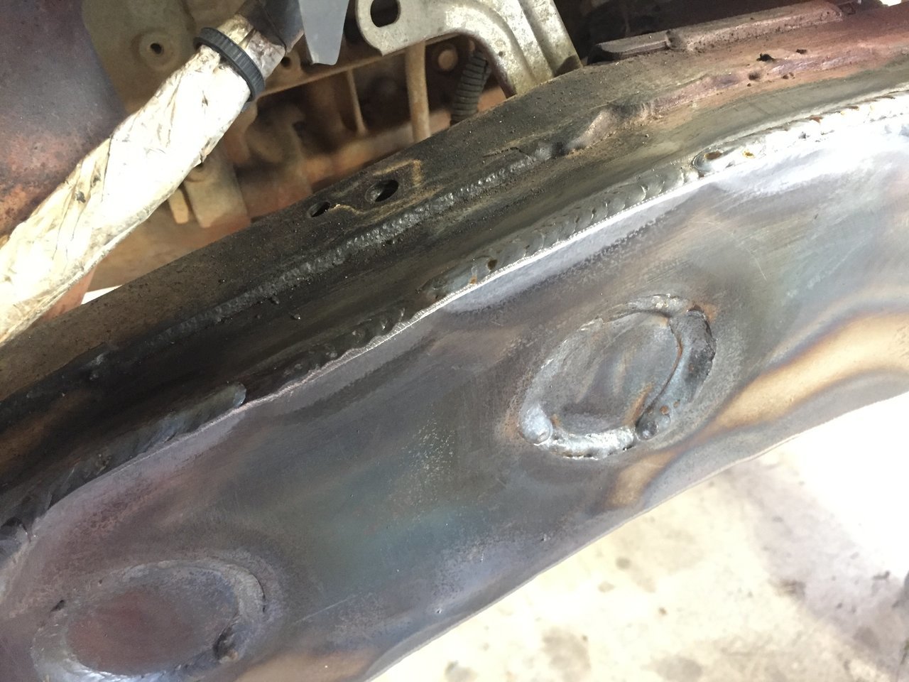

    I also question just how much these are really helping. If you want to strengthen a section you add material to it's extremities. So in this case if I really wanted to strengthen the frame I should have added top and bottom plates, not a side plate.
    Also, when welding the shock towers on I will be cutting back through the frame plates so that I can weld the towers to the frame and frame plates. Welding the shock towers to just the frame plate would make for a weaker connection than welding to the frame itself.
    Frame plates mocked up. They arrived to me flat so I had to mold them to the frame.
    Tacked and molded in. I used a map gas torch to heat the plate and beat it to the profile of the frame.

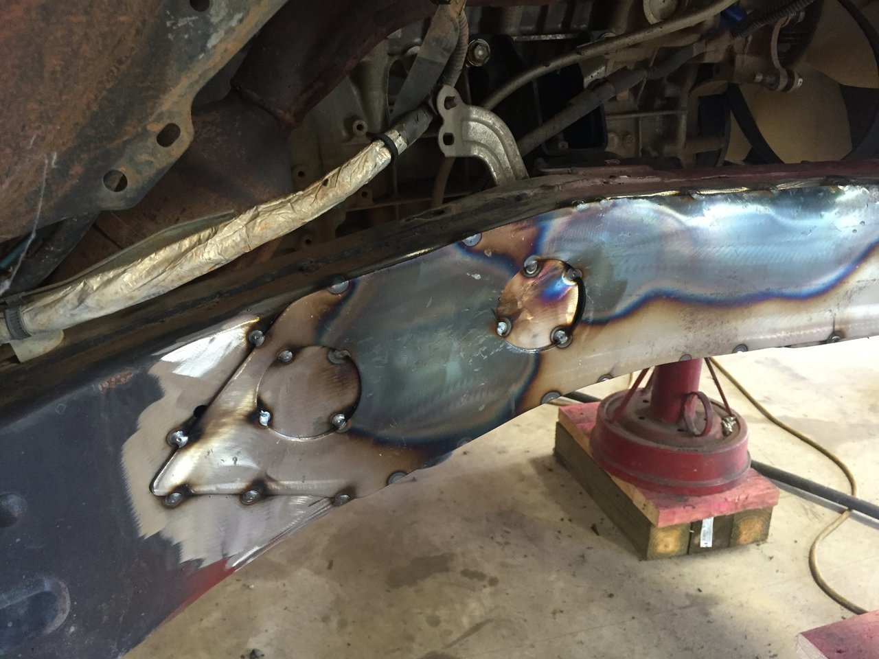

    Here's a closer shot showing the plate conforming to the bend in the frame.
    Fully welded.

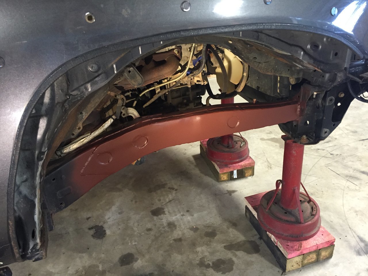

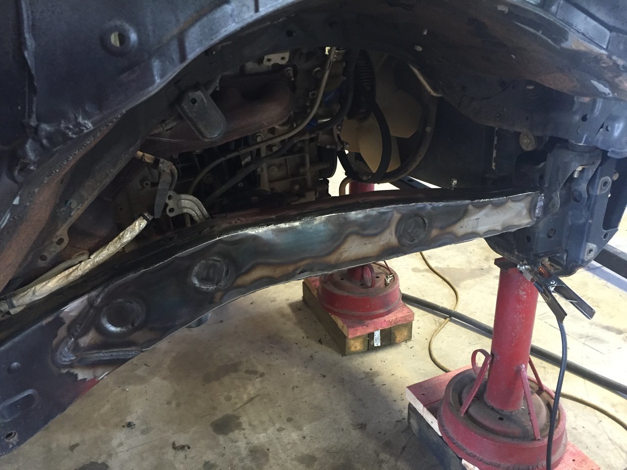

    Driver side.
    More plate contouring.

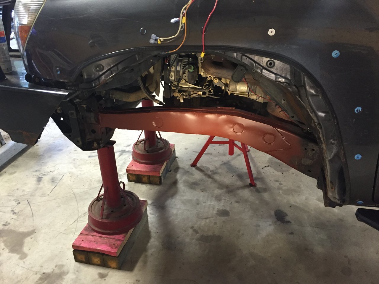

    Done for now. Every bit of exposed steel rusts instantly down here so a coat of primer is a must.

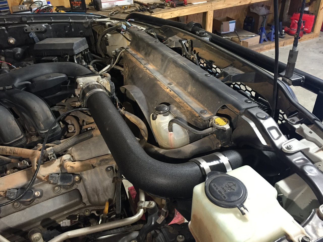

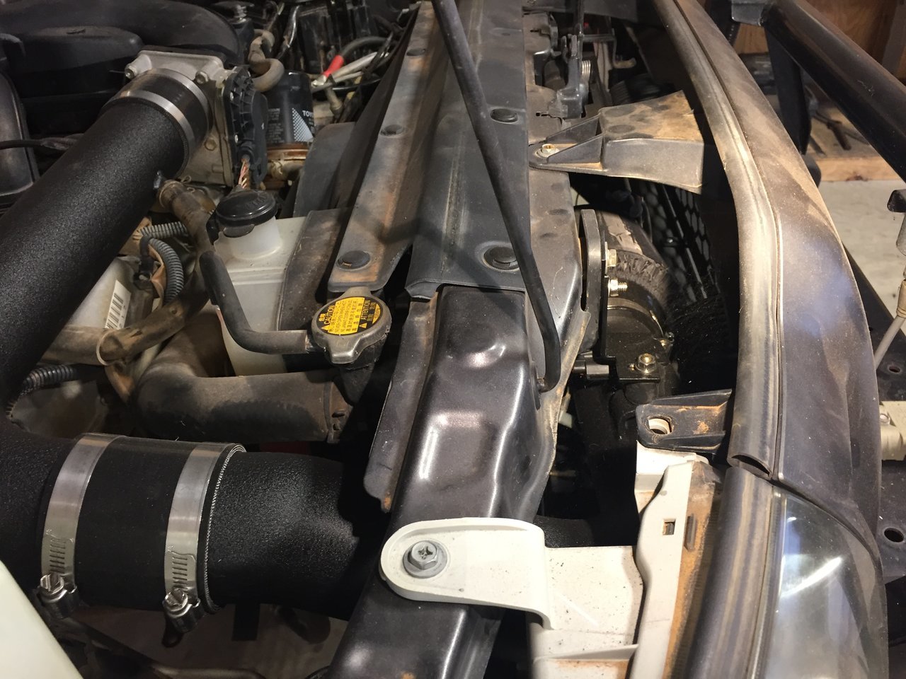

    The stock airbox, snorkel, and intake hose were just going to get in the way, so they had to go. I installed a URD intake in their place. That will leave me more room for all the other stuff that has to go back in before I'm done.

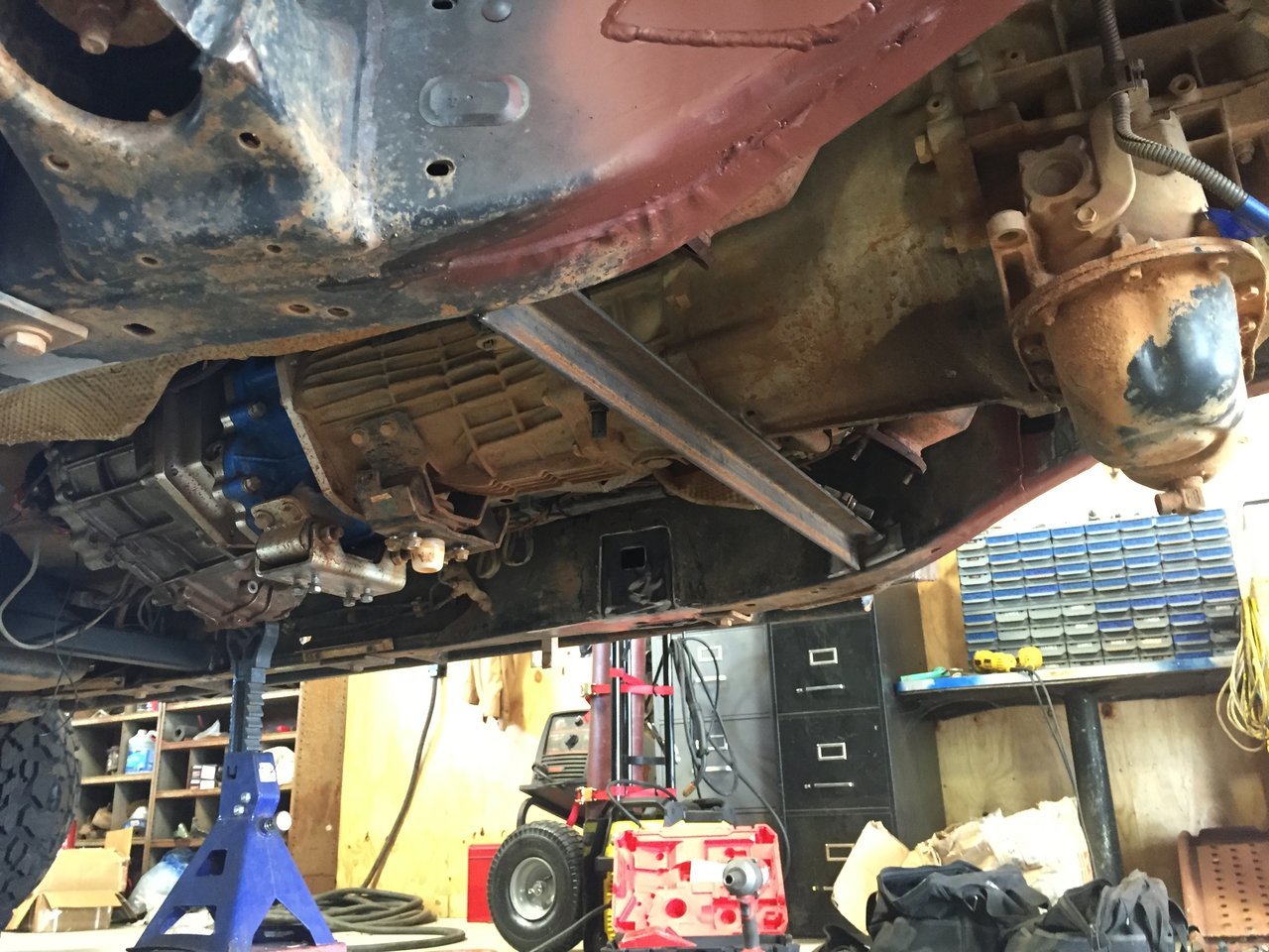

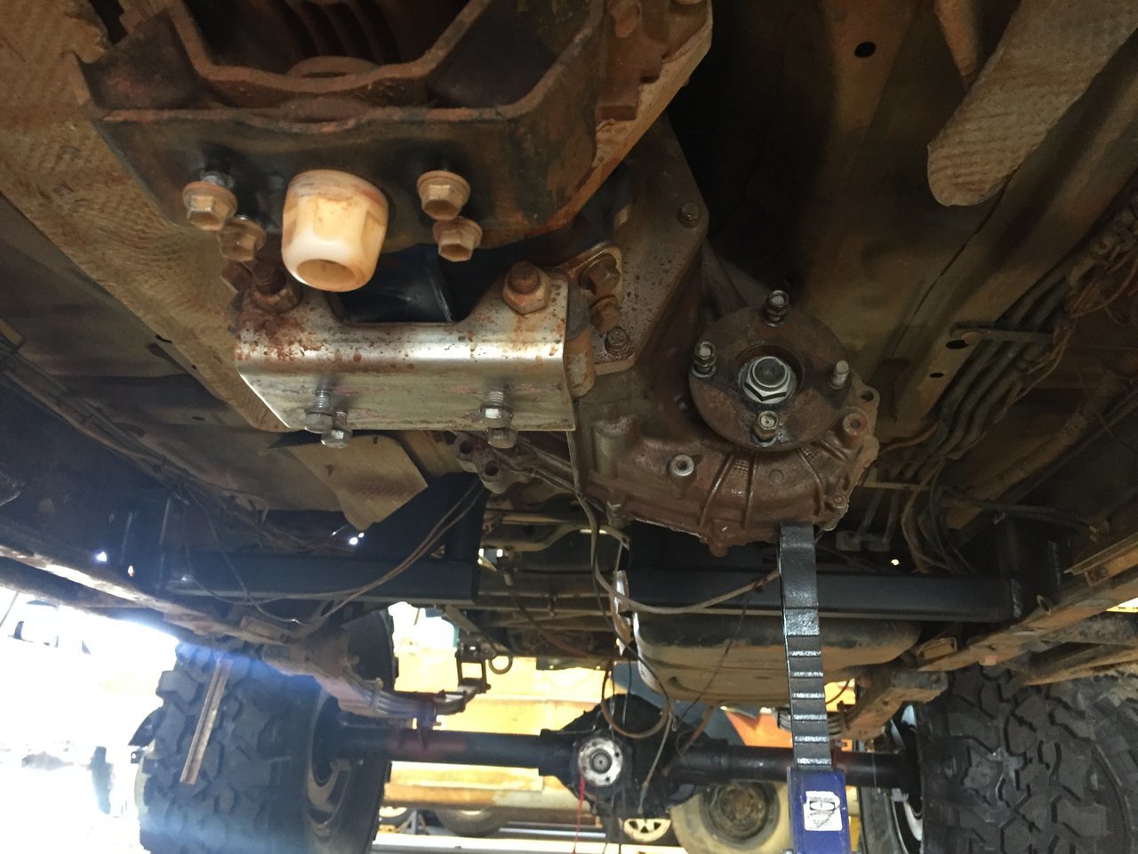

    Murphy's law rears it's ugly head again. I ordered the wrong gears for the front axle, so that's pushed me back another week. I dropped off the new "thick" gears yesterday, so I should be able to assemble the axle next weekend.

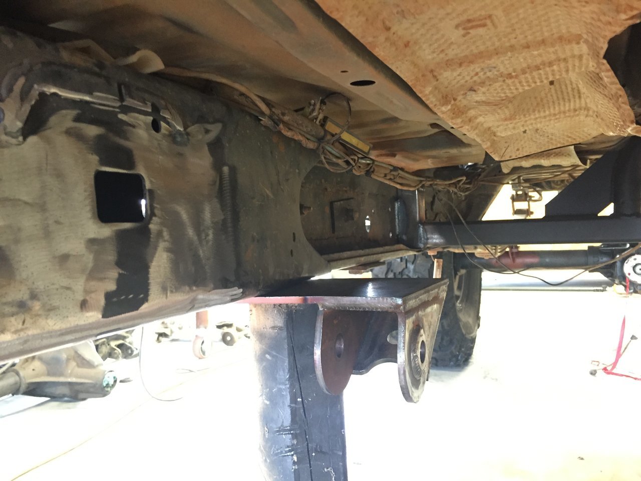

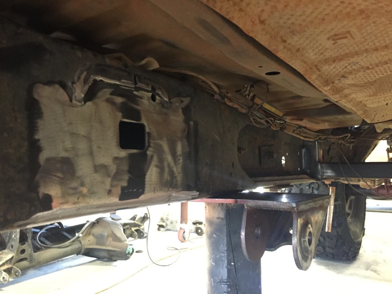

    I did get some work done today though. The transmission cross member had to go as the lower link mounts are behind it. So I added a temporary cross member under the transmission and a jackstand under the transfer case and got to cutting.
    I was going to tack in the lower link mounts, but thought better of it. I'll wait till I get the axle underneath and some mockup links before positioning anything.
    Photo Oct 01, 2 42 40 PM.jpg Photo Oct 01, 2 42 45 PM.jpg Photo Oct 01, 2 42 56 PM.jpg Photo Oct 01, 2 43 01 PM.jpg Photo Oct 01, 2 43 19 PM.jpg
