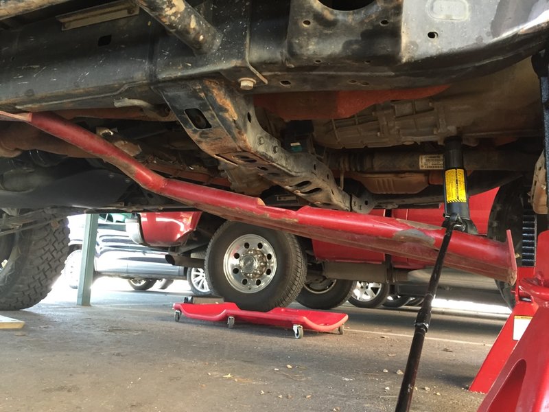

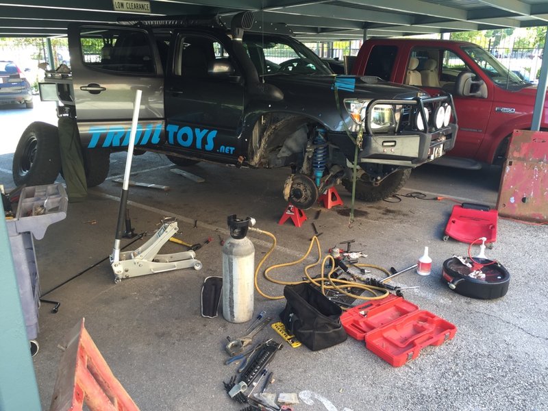

    Well, I managed to put a very small tear in my passenger side CV boot at Trees last weekend. It's amazing how such a little tear allowed all of the grease to puke out of the boot. In order to wheel at FJ Fallout next weekend I had to get it swapped out today.

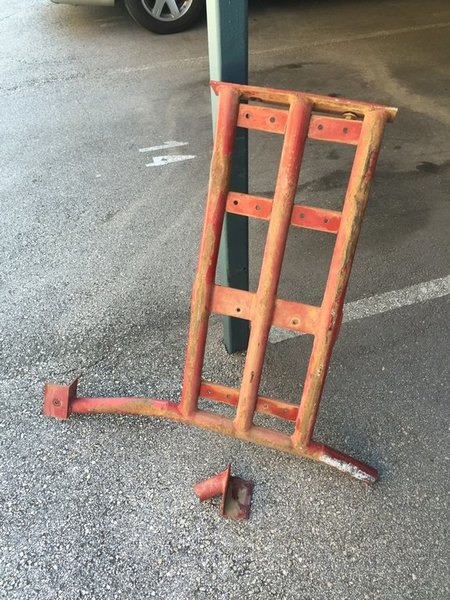

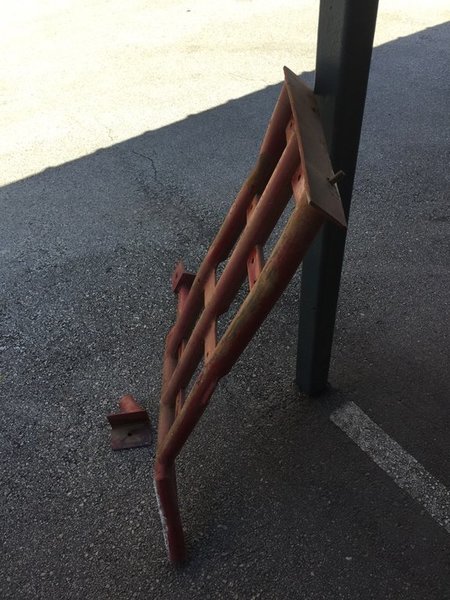

    First order of business was to pull my skids, which haven't been off the truck for quite a while. The rear bolts in my All Pro IFS skid had pulled through the mounts, so I didn't have to take those out. :D My mid skid was my first welding project and I used black pipe and not tube. Well, I won't do that again. The skid did it's job, but had deformed so badly that It wouldn't come off the truck. I even tried using my stock jack to push it off, no dice. I ended up cutting one of the rear supports. That did the trick. Guess it's time to build a new one.

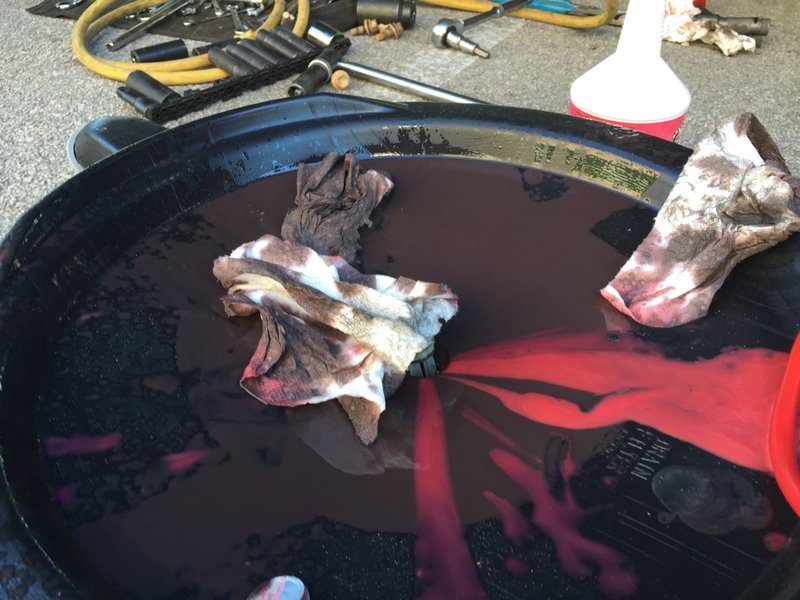

    So it looks like I had a little contamination in the diff, so I'll run this fluid change for a bit and then change it again.
    Everythings back together, except for the skids. I'll just take it easy this weekend.

    Why did you take off your mid/xfer case skid?
  16. Sep 13, 2015 at 7:49 PM
    #1476
    SMKYTXN
    SMKYTXN [OP] If it can't be overdone it's not worth doing Vendor
    Mar 11, 2011
    #52810
    14,040
    Nathan
    Houston
    11, 4dr, TRD Sport, 6sp
    DCFB
    It bolted to the back of the IFS skid, so it had to come off. Can't drain the diff or pull the axle with the IFS skid on.

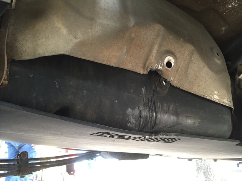

    Here's what the gas tank looks like now. ImageUploadedByTapatalk1442856557.449944.jpg
