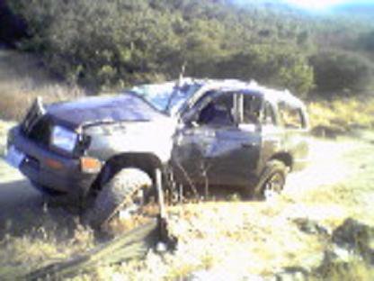

    Why would Toyota be liable for idiots rolling over offroad?? I know first hand all about being stupid and paying for the consequences:
    That's my old 4runner :(
