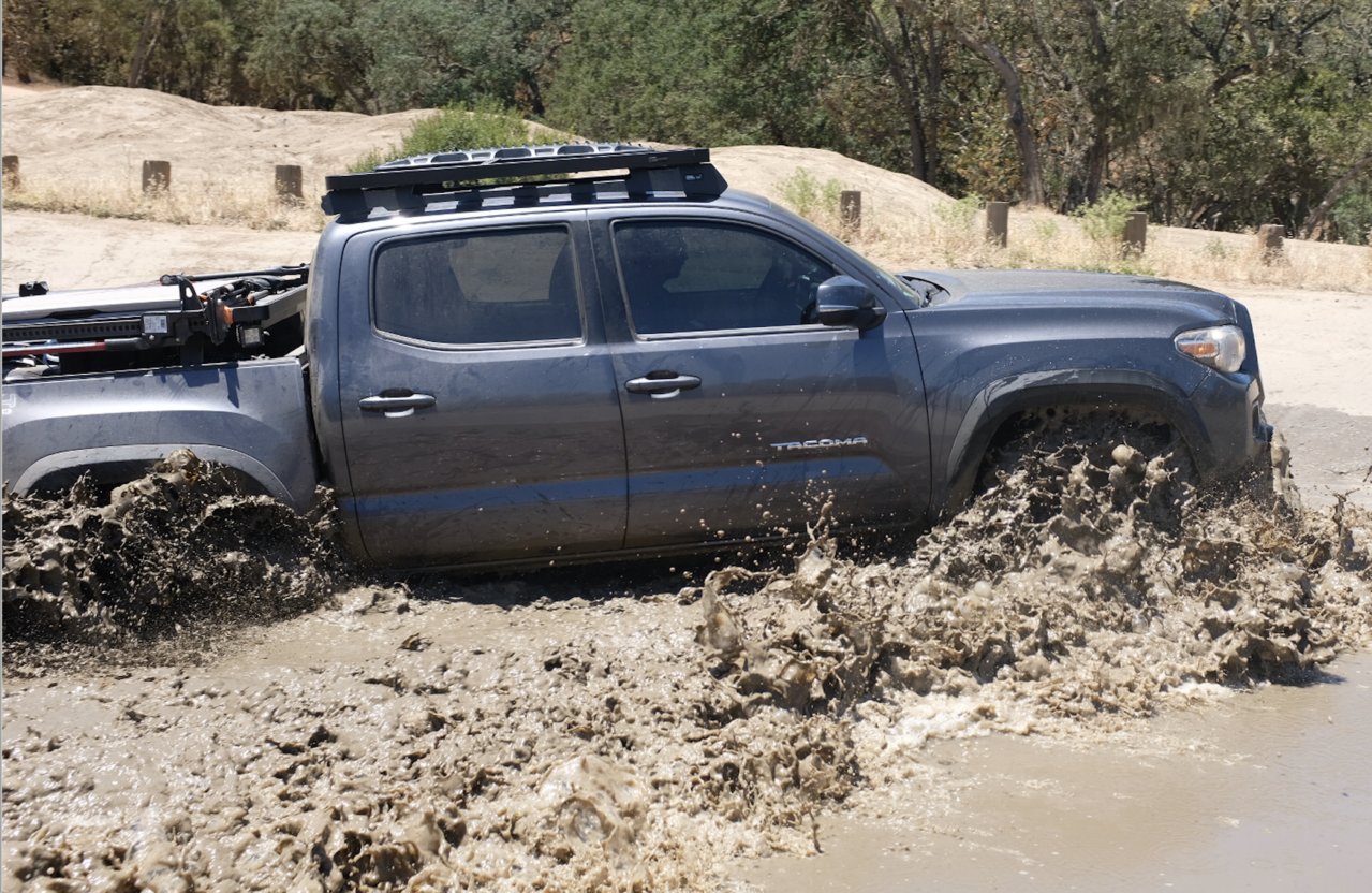

    I can't imagine it was hydrolocked since I drove for ~200 miles afterwards. My buddy just sent me a photo of the water ford. Other than splashes & bow wave, water was about 20" deep and came partially up the tire.
    Man this is a bummer - I can't understand how anyone successfully off-roads a tacoma when shallow water and hill climbs are such an issue.

    If that’s the water you went through, water could of easily been sucked into the air box by driving fast through that. Dealership probably simply opened the air box up and seen water and mud in it. All they need to deny your warranty claim

    Maybe, but you can’t hydrolock an engine 200 miles after you went through the water.

    True, but you also can’t believe everything you read off the internet. Also like I already stated, if the dealer sees any signs of water and dirt, especially past the filter they will just automatically assume it was most likely the cause. They get paid a lot more and better for a customer pay engine job than a warranty one
