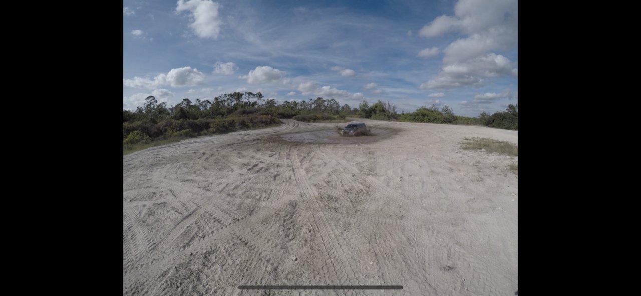

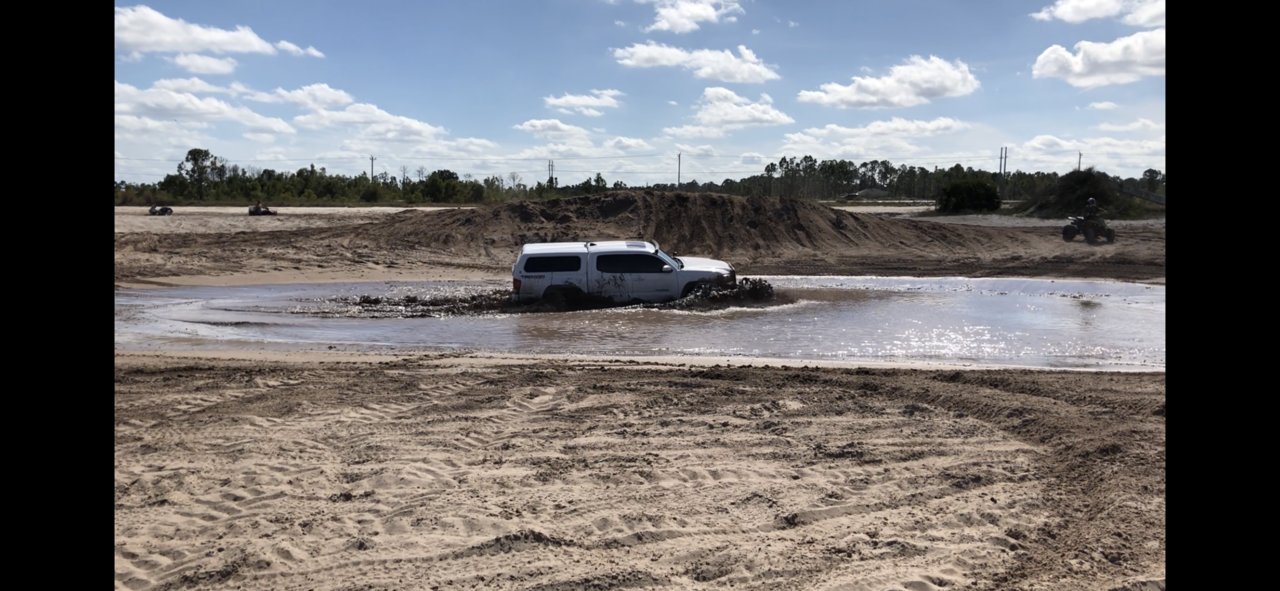

    Its hard to comprehend that the damage was done by that water crossing. Here’s some screenshots of my 2015 sport and my buddies 2017 off-road. But substantially covered in muddy water and no issues. Other then my radiator got caked and needed to be sprayed off haha. These trucks can handle some shit. Even the third gens. I think the new motors are just a little more finicky than some.
