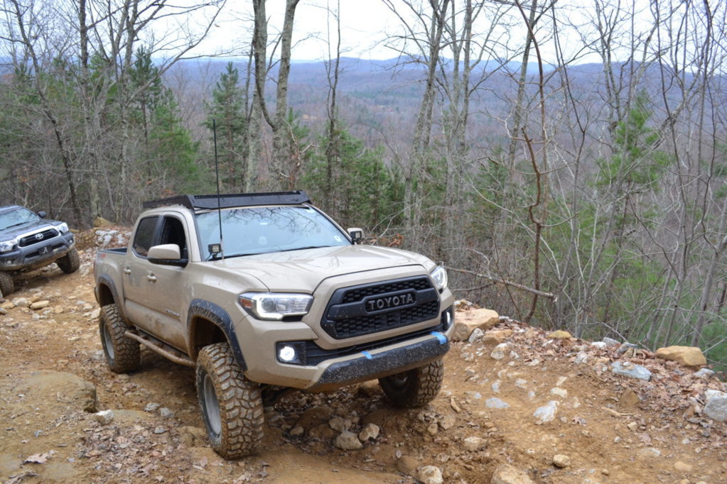

    @TheTacoma very off topic, but what is your suspension setup? leveled or lifted? tire size? really dig the stance of your taco.

    Thanks man!
    I’m running
    Icon uniball UCAs
    King ext travel front set at about 2.5”
    King rear shocks
    Ome Dakar’s
    The stance comes from the SCS F5s which are wrapped in Cooper STT PRO

    I dig it man. Kinda what im shooting for with mine if i ever get the funds/motivation to do it lol
