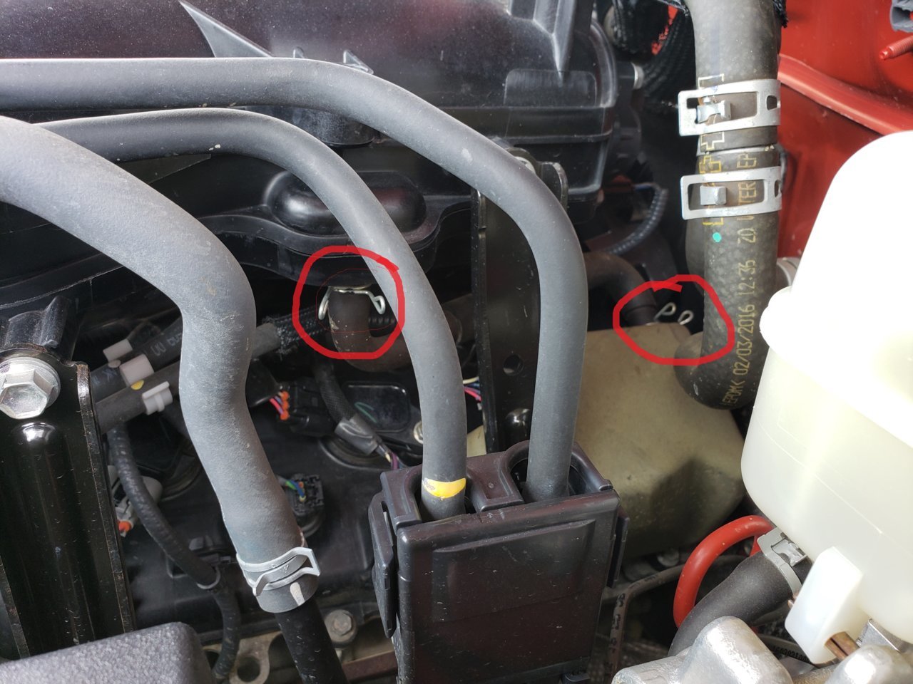

    more than likely its oil being burped up through the PCV valve into the intake.. I almost bet you pull the intake and see it is covered in oil after the PVC/intake return line. a catch can will help solve this especially if you drill the oil pan to return the oil directly to the oil pan from the catch can... ill catch some pics of mine on my lunch break, but I beliece the PCV is on the back of the passenger side valve cover... which can easily fill with oil on an incline with poor oil return from the heads...

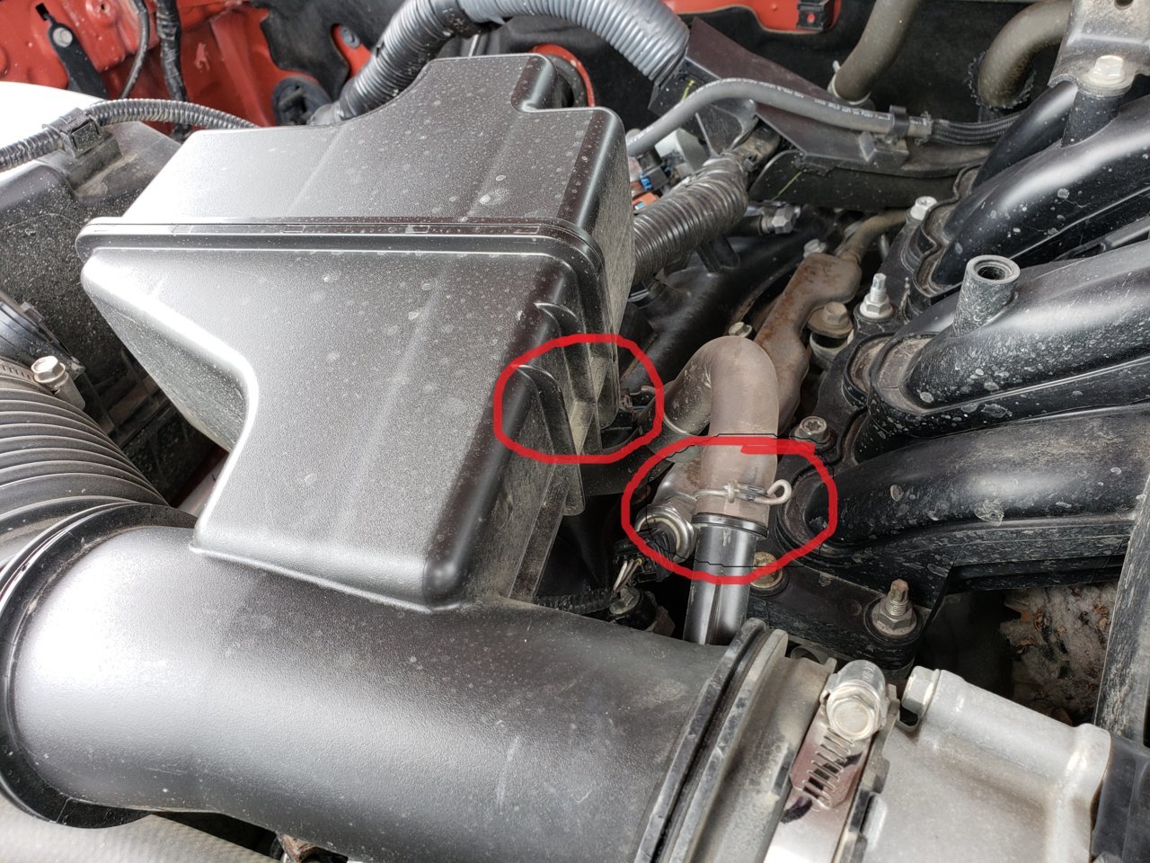

    well I was backwards.. the PCV system on the drivers side come from the front upp er of the passenger side valve cover.. however there is a PCV from the drivers side rear valve cover to the intake manifold as shown in the photo below..
    This is where I thought it was coming from however.. in an incline position the passenger side would be the first culprit, however the passenger side could be an issue on a steep descent..
    I would highly recommend a catch can, or to hook a test bottle to that driver side tube, and go up a steep hill and check for oil in it.. I would assume it would fill right up.. not sure about the clicking, but that may be the oil pump/chain/timing chain/gears being deprived of an oil bath.. unsure where the oil pickup is on this engine (still learning about it).. but chain slap could easily cause that ticking.. oil seeping past the valve seals is unlikely due to how sudden the smoke comes on, and how quickly it subsides when the vehicle is returned to level ground (oil burn off creates thick white/blue smoke. coolant you would notice the coolant level going down significantly) and if coolant were leaking into the combustion chambers you would be lacking power in all situations, not to mention coolant making its way out the tailpipe, and overheating/contaminated coolant issues..
    I checked the forward PVC tube, and mine had oil in it.. but I suspect the lower one connected to the intake manifold is the culprit. due to 2 issues, poor oil drainback to the oilpan from the rear of the stock heads, and poor PCV placement.
