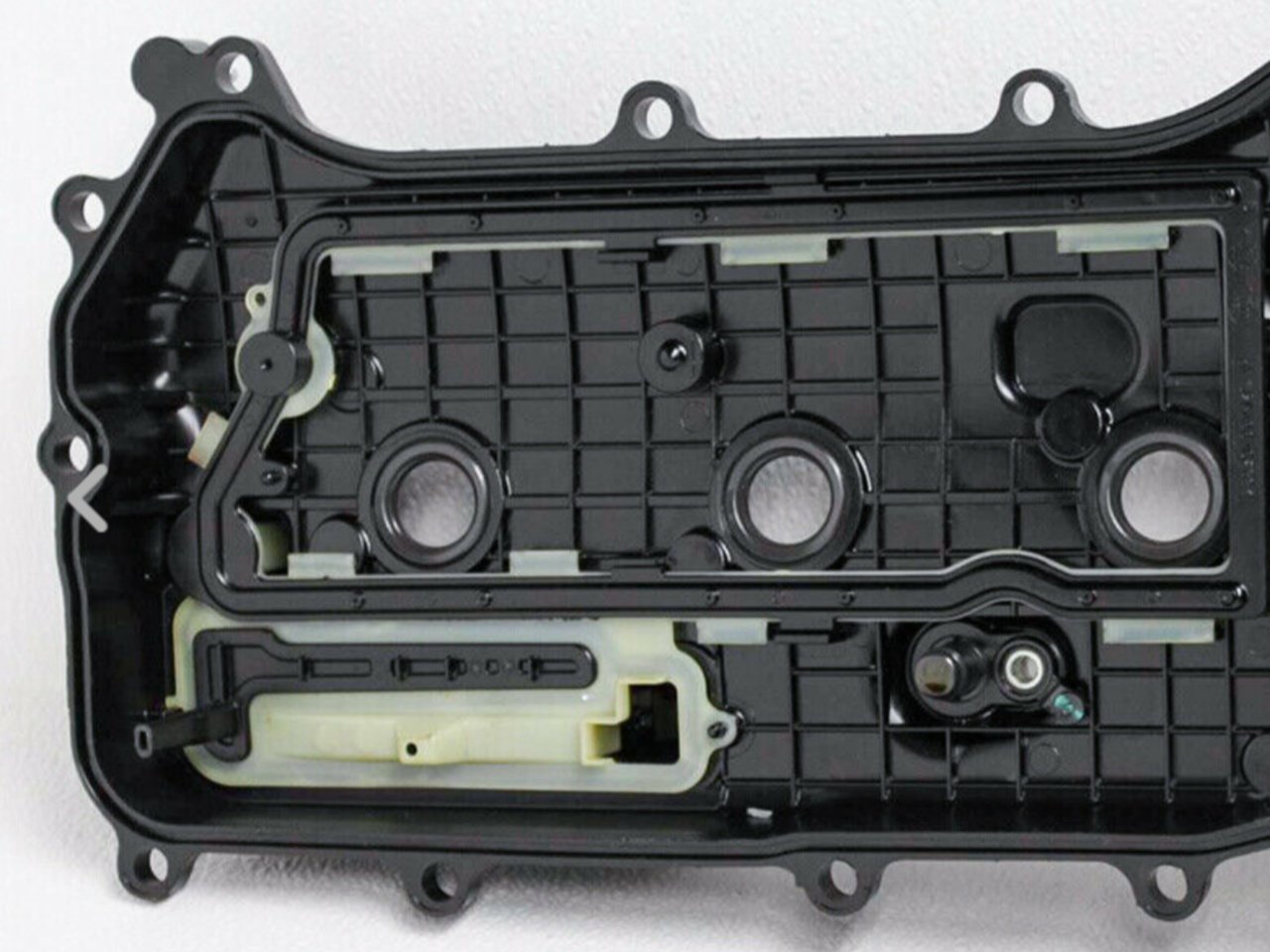

    Here is the valve cover... the placement of the breather is certainly less than ideal. It also appears (?) to have a drinking straw in place to help the PVC system with oil ingestion... LOL! I definitely need to get my hands on one for inspection.
