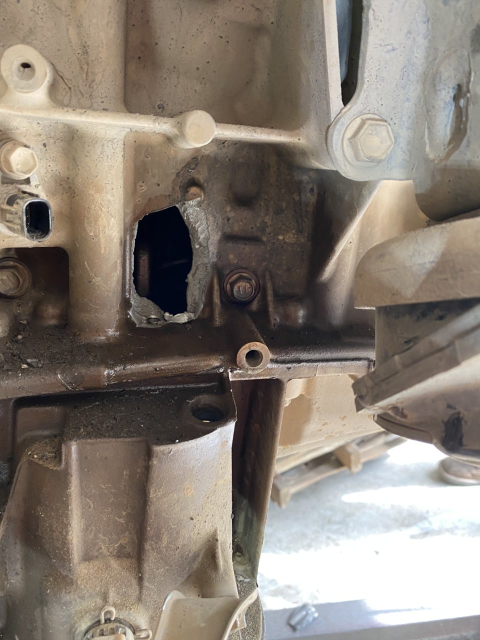

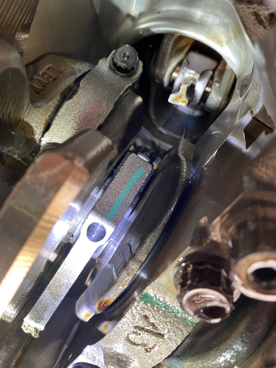

    Didn’t read the whole thread but thought I’d drop this on you all.
    First time my truck ever smoked. Low rpm, winch was doing most of the work. Truck made a slight noise then shut off. Oil everywhere underneath. Cracked on drivers side and passenger side.

    Well that sucks. How steep was that hill?

    Eh it’s fine. Motor had no balls anyway.
    Not really and steeper than I’ve been on before, I think it was just the incline and the off camber that did it in

    Damn. Hydrolocked on oil I assume? What you going to replace it with?

    Yeah. Most definitely
    1UZ.
