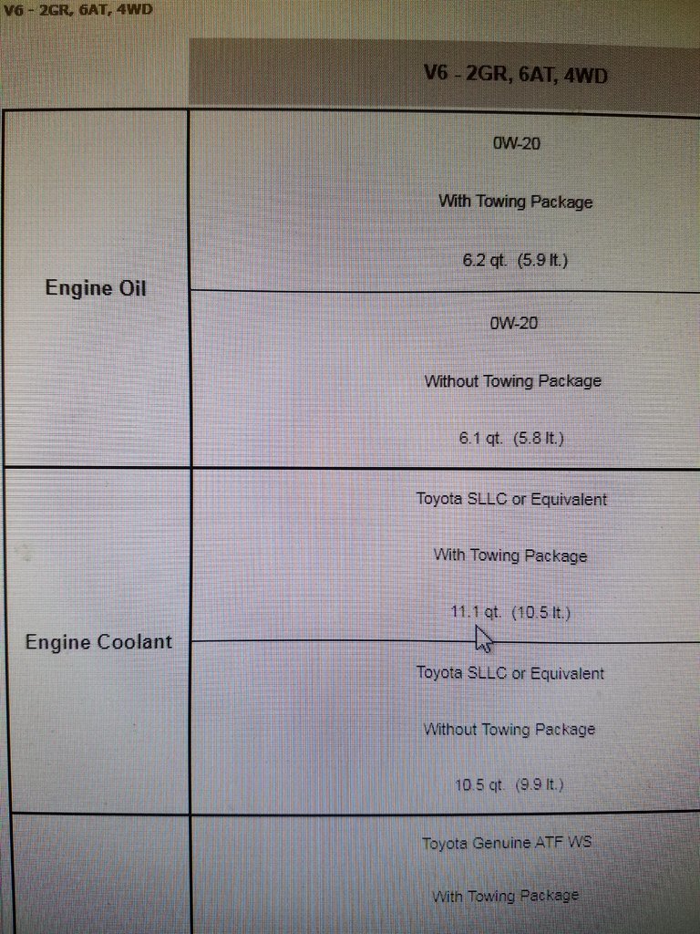

    324
    TN
    2017 8T0 Tacoma TRD Off-Road
    0W-20
    With Towing Package
    6.2 qt. (5.9 lt.)
    0W-20
    Without Towing Package
    6.1 qt. (5.8 lt.)

    Documentation source?

    Toyota Information Systems

    so the source is...?A random screenshot?
    I'm not refuting the data, just nice to know the source to know if it's accurate.

    Skepticism is understandable, it's a dealer only access system for reference information.
