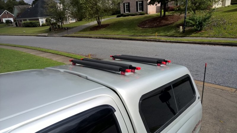

    Added new home made roof rack. All parts from Home Depot or online, less than $100.
