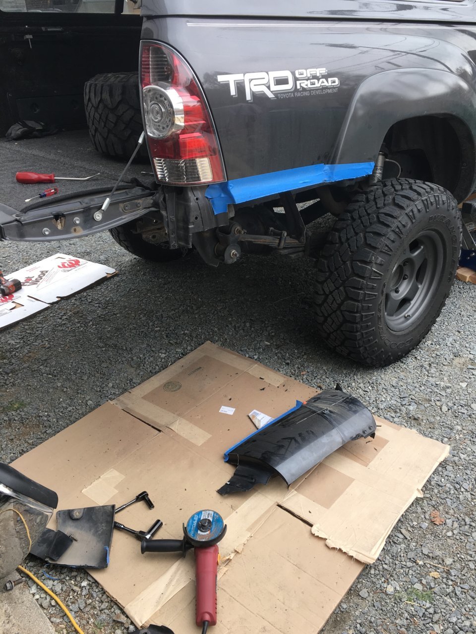

    There are several options. Ideally, look for a local
    That crease right above the exhaust pipe?
    That'll get cut off with a high clearance bumper.

    They/i would cut off the bedside behind a wraparound bumper? Because if you leave it, it is still going to get salt/moisture in the cracks in the paint and rot. It happened with the last truck I owned. I’m thinking I’ll steer away from the wraparound bumper and cutting so that if life happens and I have to sell, it would be able to convert back to oem. I see 4 or 5 year old gm trucks with bed rot above the wheel arches. I’m trying to avoid the inevitable onslaught of body rust.
    Edit: just saw the pic of the cutoff for a high clearance bumper. I’m kind of weary to cut portions of the body out, I just worry that sealing off the raw edge will lead to problems down the road. From my viewpoint, with what I have invested in the truck i think the low risk bolt on application without cutting/sealing of body panels would be the way to go, the brine mix the DOT uses around here will get into any unprotected spot and from there it’s just a matter of time before it rots out.

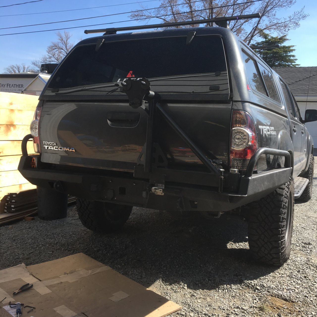

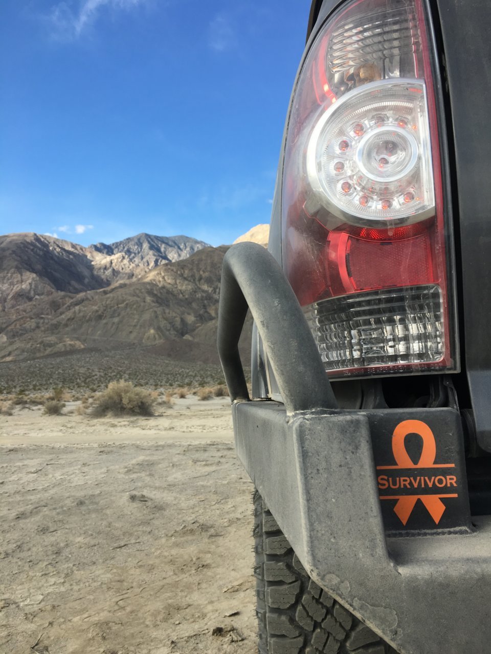

    I painted the cut with some duplicolor then installed door trim molding between the cut and bumper. There is no bare metal and the door trim molding prevents the bumper from rubbing on the painted bedside. You can see a bit of the trim in these pics.

    Looks nice! What make and model is that bumper? Is it a 4x? Sad, their site doesnt list 2016-2017’s.

    Thanks. It's a Bruteforce High Clearance with a swingout.
