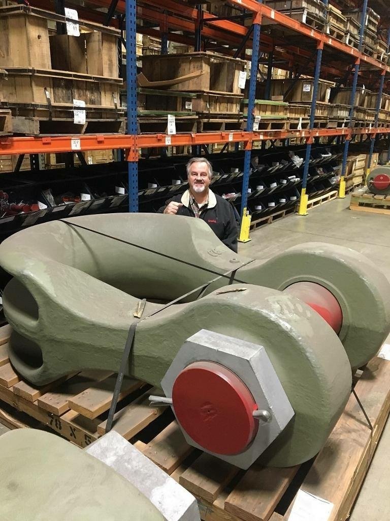

    I'm scared to see the ratchet that you have for that hex nut.
