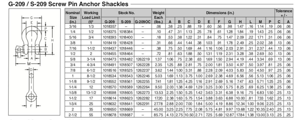

    Just for clarification for a recovery beginner like myself, it's not the body that needs to be 3/4", it's the pin diameter, right? Most 3/4" shackles have 7/8" pins. If that's the case it's kind of confusing considering it's the 5/8" body shackle that has the pin diameter. So the link below wouldn't work in a standard bumper with 3/4" recovery points, correct?

    3/4 shackles have 7/8 pins. Bumpers i have been around have a 1” hole to accommodate this size shackle. Verify you setup :thumbsup:

    Gotcha yeah, I was going off what the guy up towards the top that said 3/4" recovery points were pretty standard. Either way hopefully people don't get confused and assume when websites list "3/4" shackle" that that seems to be the body size with most websites I've seen, not the pin diameter.
    EDIT: Thanks for the great information everyone, I just got my plate bumper mounted and this thread is a huge help.
    EDIT #2: I checked my bumper and it, indeed, has a 1 inch hole. I think where my confusion came in is that on the website it says "3/4" steel recovery point" but that's just how thick the metal is.

    A 7/8" shackle usually has a nominal pin diameter of 1" and the distance between the bow is 1.44". A 1" thick tab will usually be for 3/4" shackles, which have a nominal pin diameter of 0.88", but may even work with 5/8" shackles. Confused? Yeah.

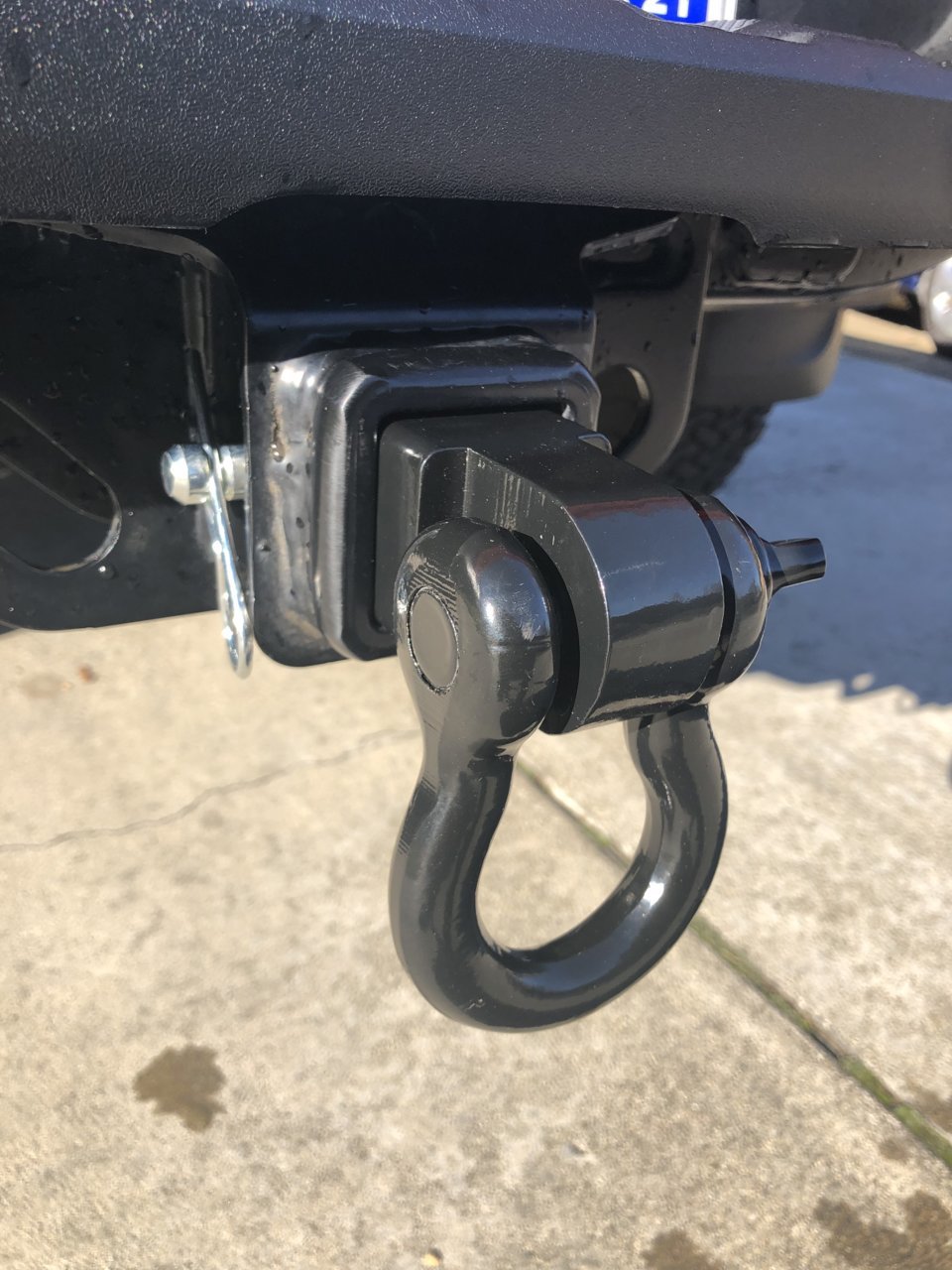

    What kind of hitch should I get for my shackle? Are they all the same?

    I vote factor 55 because of the crazy emphasis they put on safety.
    A lotta folks run the Vault or Rhino one off Amazon as well, and I'm pretty sure it is a "same OEM, different label" type deal for these.
    Superman[QUOTED][OP] likes this.

    I used smittybuilt and it works great. It’s a solid chunk of steel.

    Rhino shackle and hitch here. Solid piece of steel for sure.
